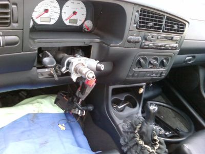

I just bought a 1999 Jetta VR6 and the tach and speedo are not working. Where do I start?
Mar 21, 2008 at 2:21 AM
15973

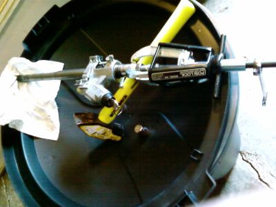

I just repaired that on my 97 Jetta GLX. Had to replace the electric switch mounted to the key switch in the steering column. Is not a job for the faint hearted. Had to pull the steering column to gain some elbow room. Used my dremel tool with a cutoff wheel to grind some deeper groves in the hub that must be pulled off to r&r the ignition switch. Will need a good sturdy 3 jaw gear puller. 15973
https://images.2carpros.com/forum/automotive_pictures/170662_Ign_Switch_1.jpg
https://images.2carpros.com/forum/automotive_pictures/170662_Steer_col_n_puller_2.jpg

thanks for the info...I talked to a vw dealership and they are telling me I need a whole new gauge cluster without even looking at it. This sounds much more cost effective. I will try it first.
Thanks again,
