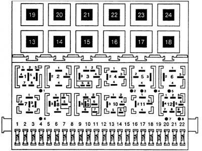

I think maybe I'm not being clear enough on my qestion, I need the relay marker #'s and what slot they go in for the ones right above the fuses. You sent where the relays go but not the marker #'s. Thank You

Relay Location On Fuse/relay Panel
https://www.2carpros.com/forum/automotive_pictures/12900_f_8.jpg
Important!
Obtain radio security code and disconnect battery ground strap before working on electrical system.
NOTE:
Relay and fuse location may not match those shown below depending on vehicle accessories and optional equipment. See appropriate wiring diagrams.
Number in parentheses indicates production control number stamped on relay housing.
Relay locations on fuse/relay panel
1 - A/C Relay (13)
2 - Rear Window Wiper/Washer Relay (72)
3 - ECM (Engine control Module)
3 - Power Supply Relay (30, 109, 288)
4 - Load Reduction Relay (18)
5 - Open
6 - Emergency Flasher Relay (21)
7 - Open
8 - Washer/Wiper Intermittent Relay (19, 99)
9 - Seat Belt Warning System Relay (4, 29)
10 - Fog Light Relay
11 - Dual-Horn Relay (53) Or Bridge For Horn
12 - Fuel Pump Relay (67, 80,167) Or Glow Plug Relay (102,104)
Separate relays above fuse/relay panel
13 - Heated Oxygen Sensor (HO2S) Control Module
14 - Park/Neutral Position Relay (150)
15 - Open
16 - Open
17 - Open
18 - Open
19 - Open
20 - Open
21 - Open
22 - Open
23 - Open
24 - Open
