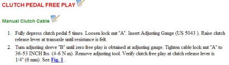

How do I adjust the clutch
Saturday, August 1st, 2009 AT 12:27 AM
MHPAUTOS
MECHANIC
31,937 POSTS
Hi there,

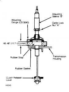

See pic & text for clutch adjustment.
