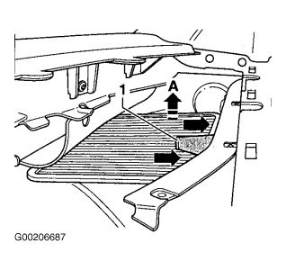

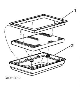

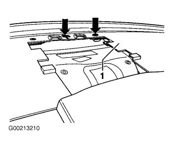

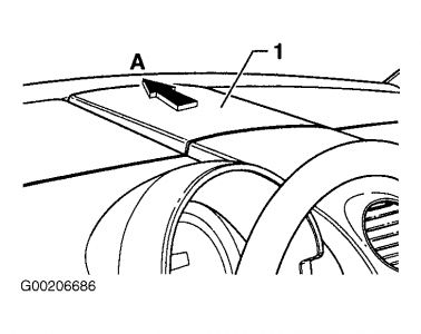

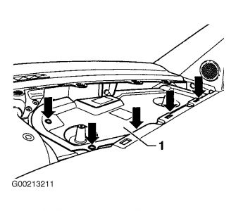

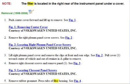

Where is the dust pollen filter located in 2002 turbo VW

Hi there cabin filter instructions.
