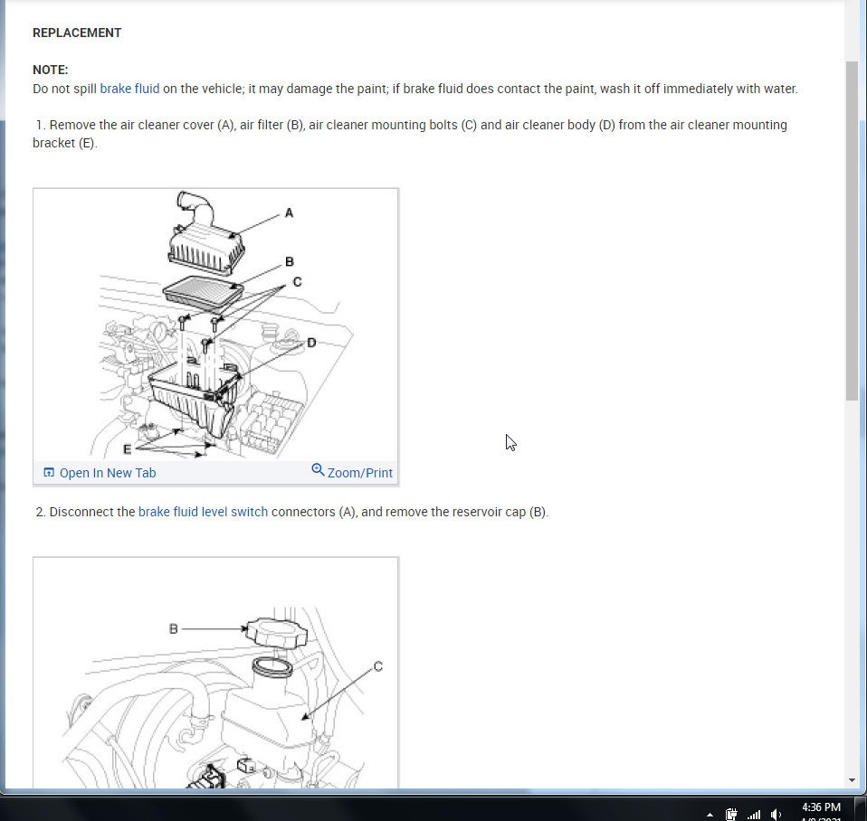

when I apply the brakes the pedal sinks like the brake master is by passing
2008 KIA SPECTRA
226,000 MILES • 2.0L • 4 CYL • 2WD • AUTOMATIC
LILBUG98
So I have a problem where no matter what speed I am going when I apply the brakes the pedal sinks like the brake master is by passing so I need to replace it can you help?
May 29, 2020 at 9:18 AM
  • CAR REPAIR CONTRIBUTOR

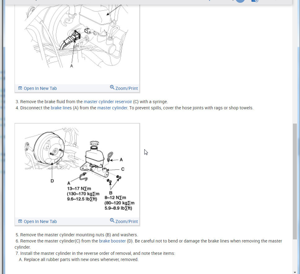

Here is a guide that will help with this:
https://www.2carpros.com/articles/how-to-replace-a-brake-master-cylinder
https://www.2carpros.com/articles/how-to-bleed-or-flush-a-car-brake-system
Plus here is the process below from the manual on how to replace this.
Please run through this material and let us know what questions you have.
