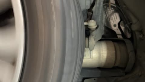

Take off no issues, no clunking noise at all, once you reach 60 MPH the whole car vibrates and if you go faster, it gets worse so I have to slow down, driving below that it is pretty much fine. Jacked up front wheels, no issues at 3-9 or 6-12, tires are decent, brakes are thick. Any suggestions?

I had tires balanced first, helped very little was able to go a bit faster before vibration starts, did alignment now I can do 63 MPH before it starts, they checked wheels, not bent. Very strange, I checked all bushings and joints for anything obvious and none, all average wear with nothing looking bad. The ride is soft but I feel it is bouncy, but these have air suspension, is it possible bad struts can cause that?

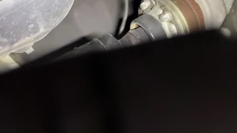

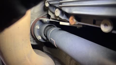

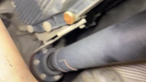

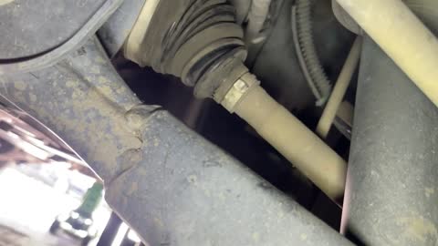

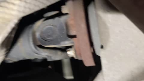

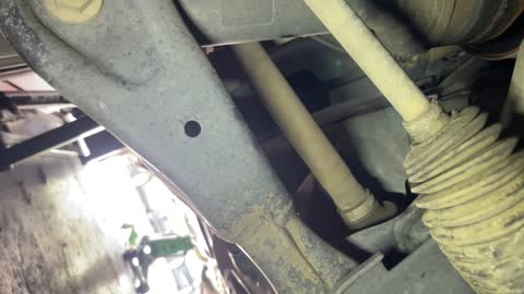

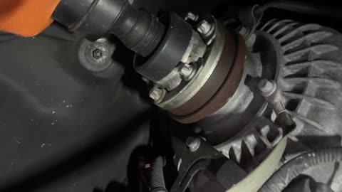

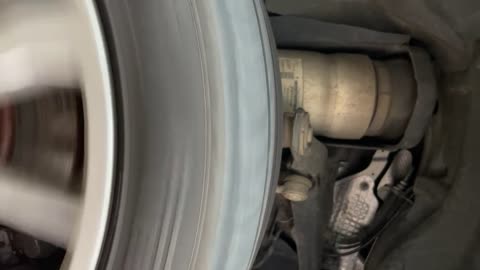

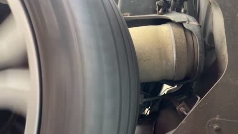

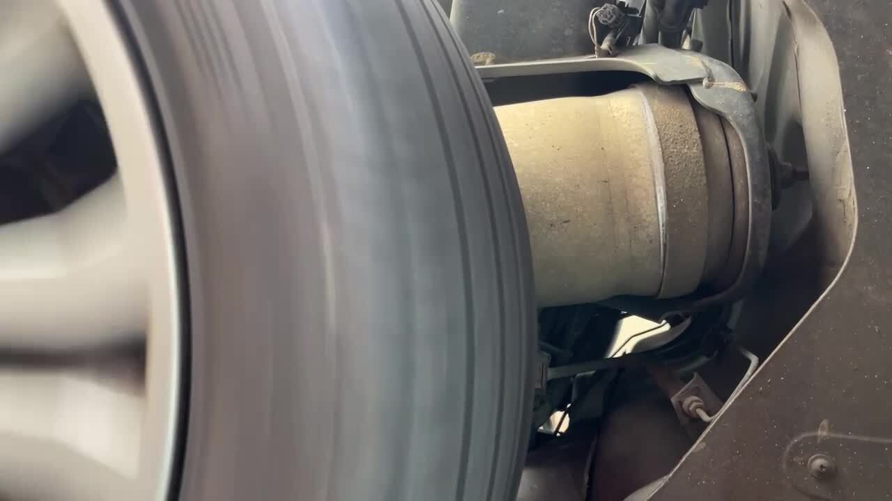

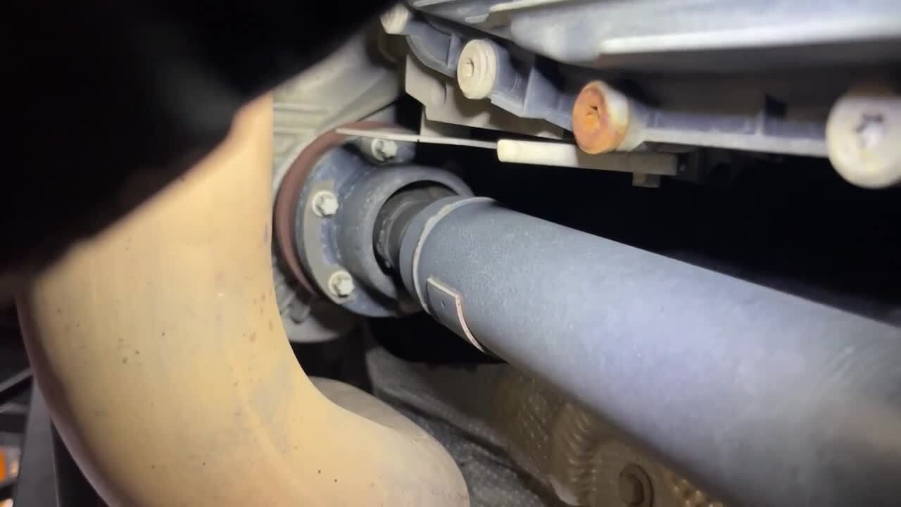

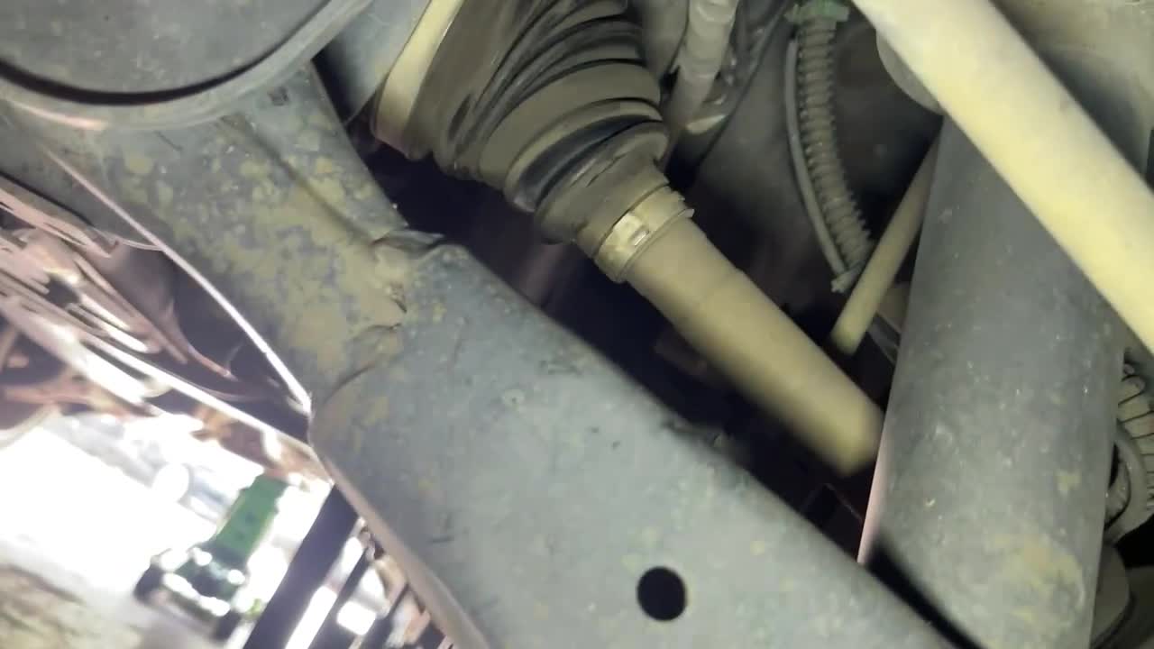

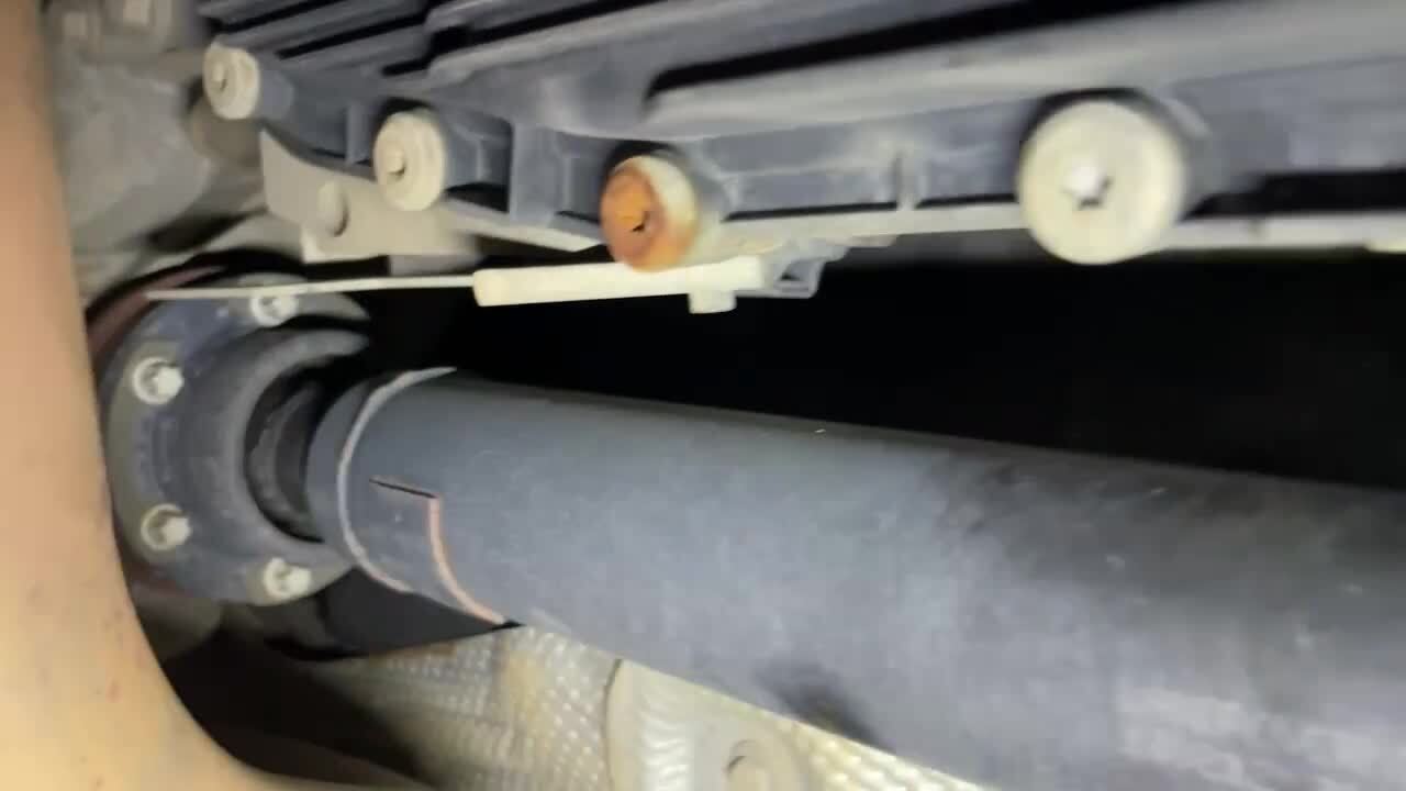

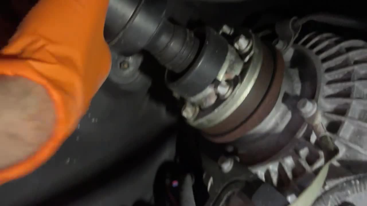

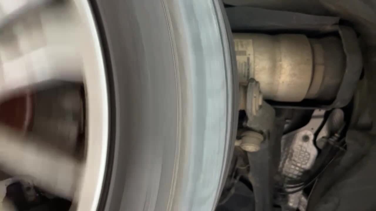

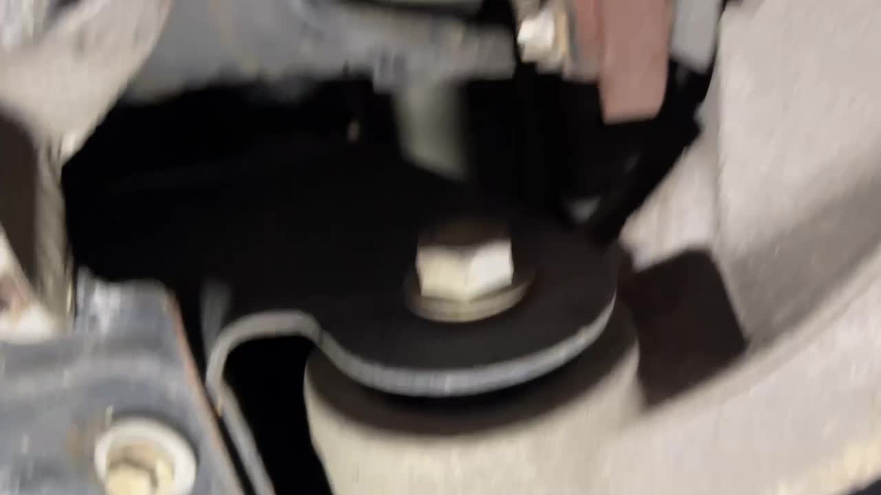

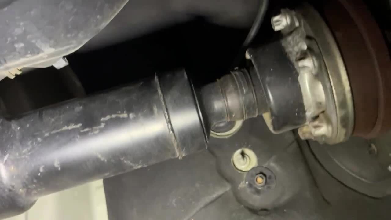

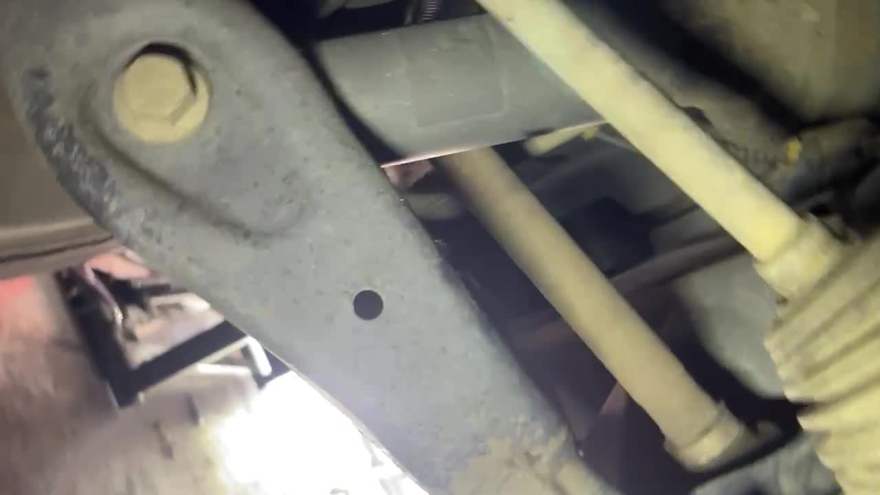

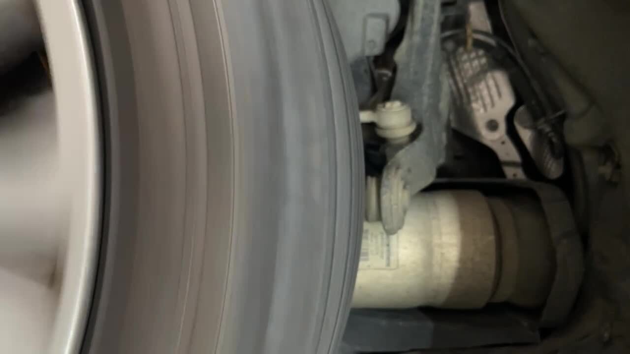

Put it up and turned and checked all things that can be turned. Here are some videos maybe you can see something that I can't.
Tuesday, April 4th, 2023 AT 1:41 PM
  • 110,192 POSTS
I watched all of them. The only thing I noticed was one of the axles (driver's side I believe) seems to be somewhat out of round. That could be due to the vehicle being lifted.
Everything else looks good and tight. Was there any in-and-out play at the wheels or play at the tie rods or ball joints?
Tuesday, April 4th, 2023 AT 7:49 PM
BHAMDOC1973
  • 2,018 POSTS
Yes, actually both axles are doing that due to the reason you mentioned, first I thought they were bent. But if a problem only pops up at higher speeds only then only specific things could be wrong. No play at all at 3-9 or 6-12, that is the first thing I checked, nothing at all on all 4 wheels. And it had alignment and balance, very strange, and not a drop of oil anywhere.
