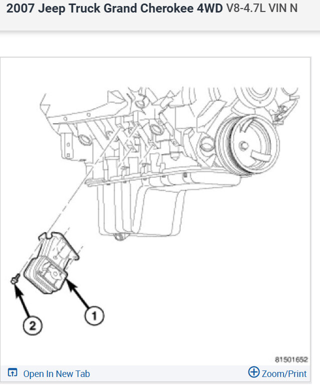

It sounds like an engine mount has let go on the driver's side. Here is what the mount looks like so you can check it out. This shows the passenger's side but the driver's side is the same. Check out the images (below). Please let us know what happens.
