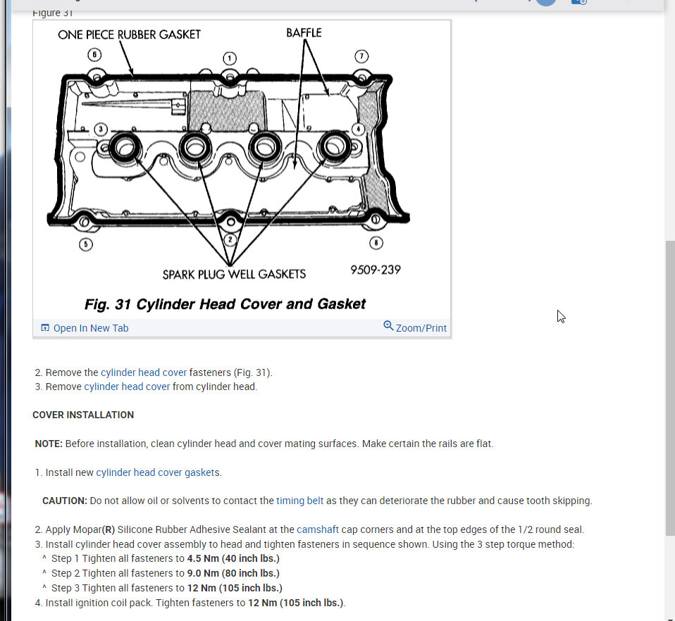

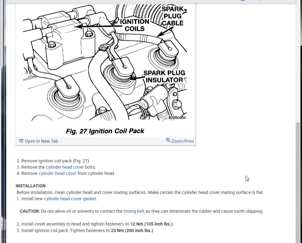

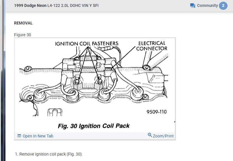

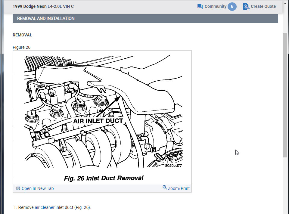

What are the torque specs?
Saturday, May 22nd, 2021 AT 4:11 PM
MECHANIC
18,907 POSTS
Below you will find the replacement process for both engines depending on if you have a SOHC or DOHC engine. It includes the torque specs.
Please let us know if you need other info. Thanks
