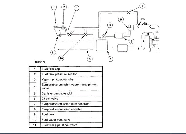

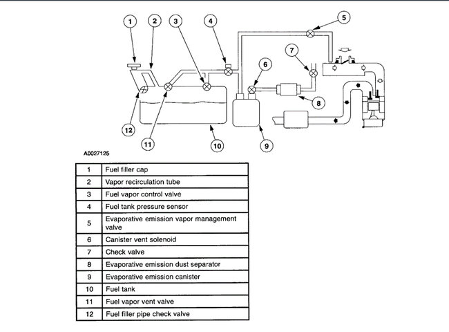

Need the vacuum line diagrams 3.0 v6.

The only thing I was able to find is below in the pics. Let me know if this helps. If there is something specific you are dealing with, let me know. If I pinpoint a specific component, often times I can find specifics.
I don't know if you are looking for a leak, but here is a link that you may find helpful if that is the case:
Note: Pic 1 is the duratec engine and pic 2 is the zetec.
