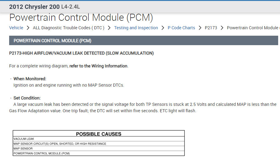

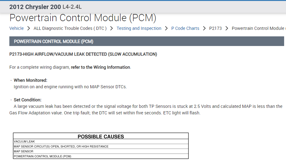

The code showed P2173.
Jan 29, 2024 at 7:40 PM
  • 110,193 POSTS

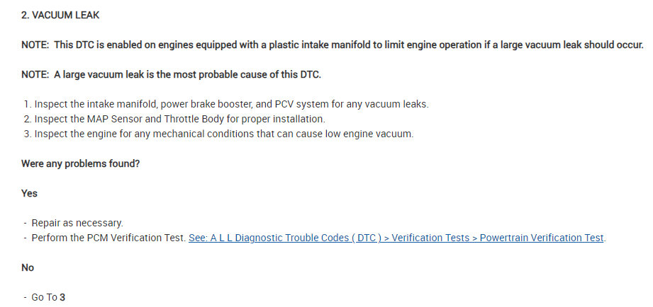

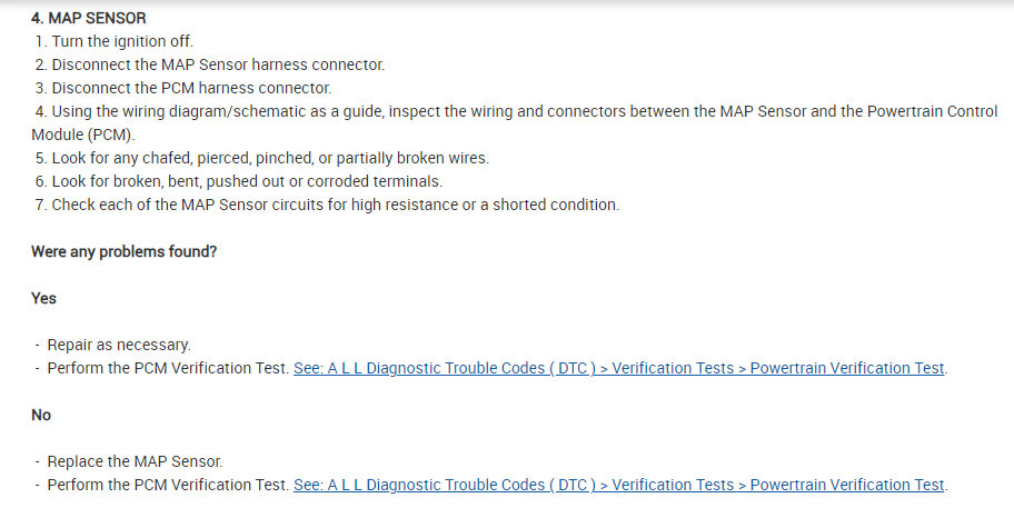

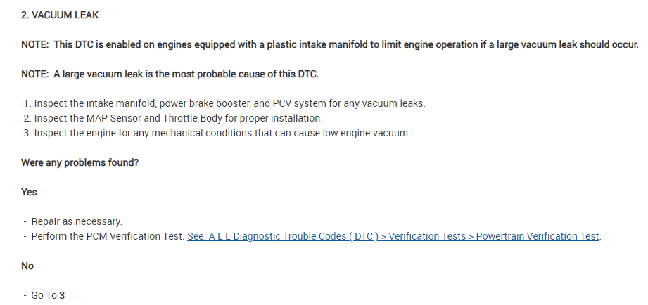

That works. LOL The code is related to a large vacuum leak. If in fact it is a leak, you will be able to find it using the link I attached above.

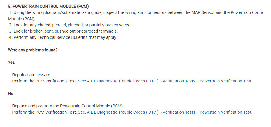

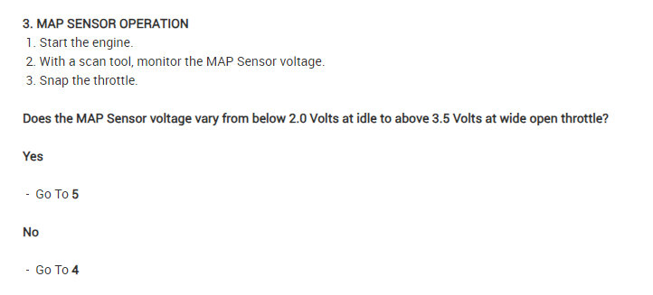

On the other hand, if there are no leaks found, then suspect it could be a few things. For example, a faulty MAP sensor, wiring issues, the PCM itself, or even the throttle body.

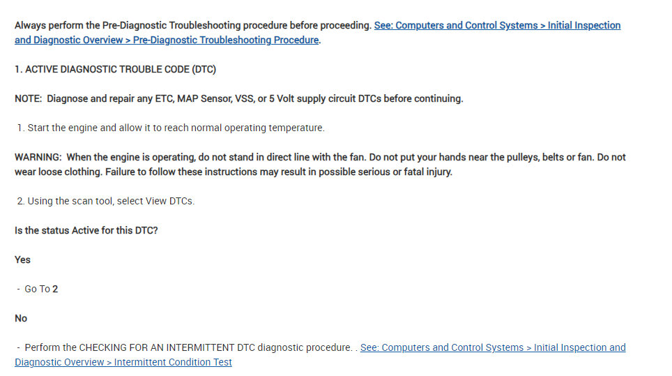

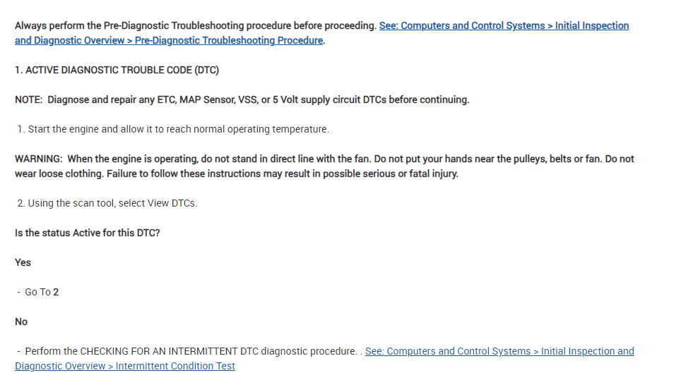

I attached diagnostics below specific to the code. Take a look through them and let me know if you are comfortable performing them.
