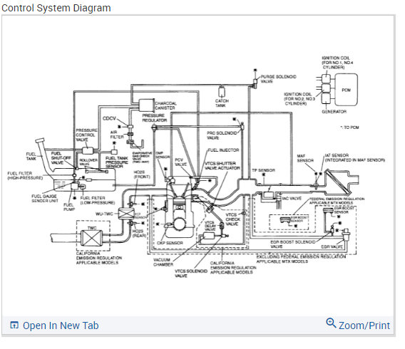

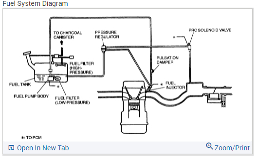

Can someone send me a clear diagram of the vacuum routing?

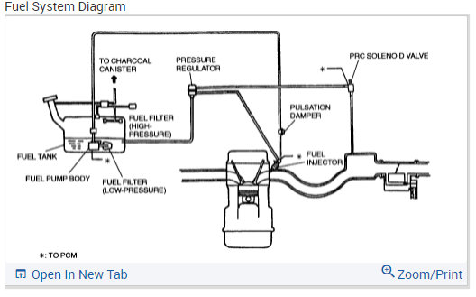

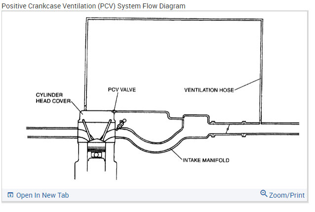

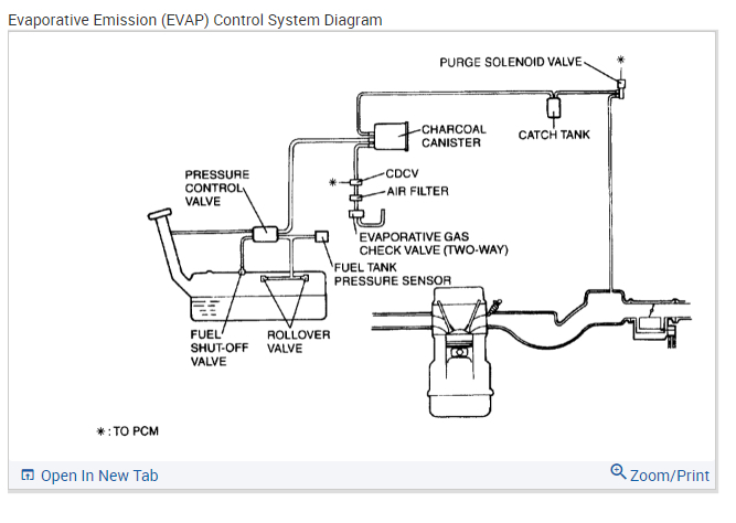

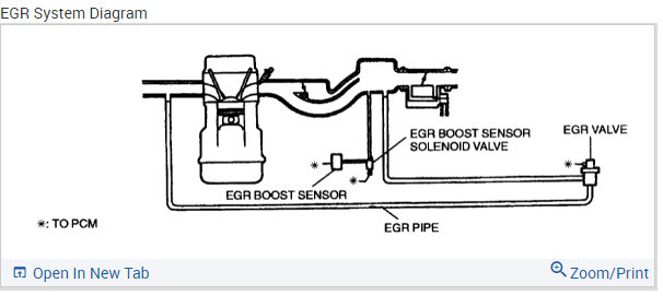

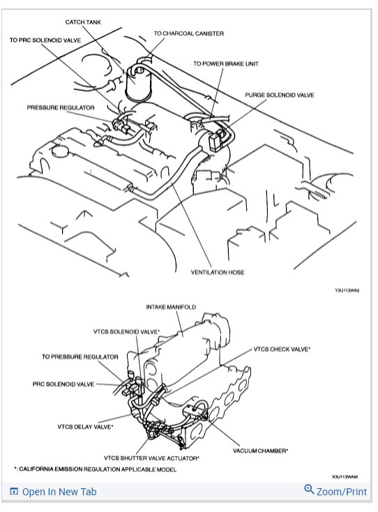

Please attached for various vacuum diagrams.
Let me know if you have any questions.
