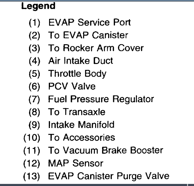

Welcome to 2CarPros.

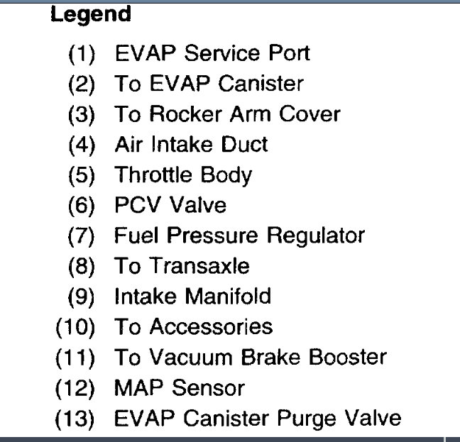

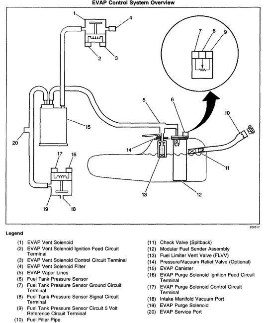

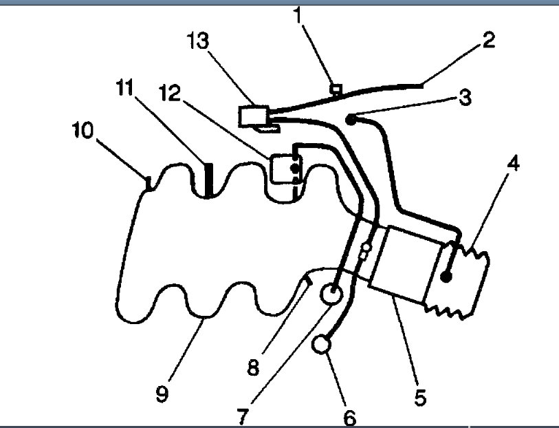

I have attached two pictures indicating vacuum routing as well as what each port is for.
Let me know if this helps. If there is something specific you need, let me know.

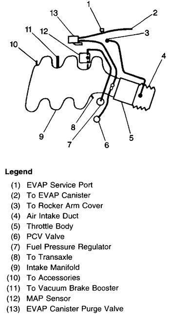

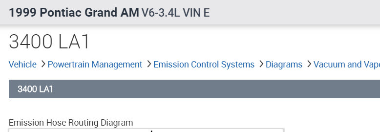

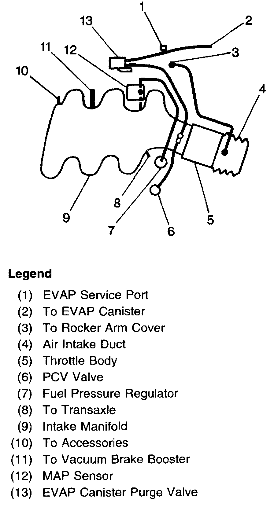

I have included the information that you have requestd in the diagrams down below. Please, feel free, to ask should you have any other automotive questions. That's what we are here for.
