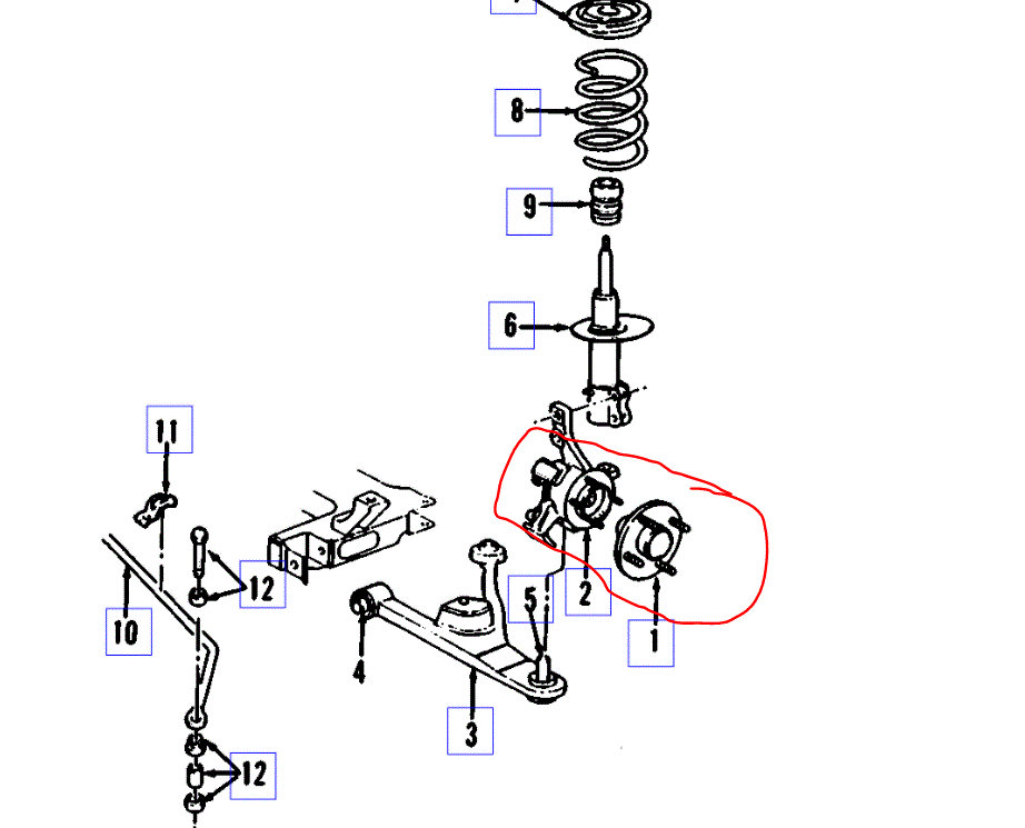

I had a broken tire belt, and it was really bad. It was thumping and jerking bad. I replaced the tires. After I started hearing this rotational type of kind of thud sound, it gets faster with speed and sounds like a rotational thud or rubbing when I turn left its more noticeable than when turning right but is constant even when driving straight. I thought it was bad bearings so replaced them and still doing the same thing. Control arms have been replaced and the entire suspension has been checked three times and everything is fine. Motor mounts were also replaced and still no change. I was told maybe a really bad alignment but my car steers just fine. I mean the alignment is a tad bit off but I don't think it's causing the noise, it's not that bad at all, like you can't even really tell its off. Does anyone have any ideas on what is causing the noise? I have had 2 different certified mechanics look over everything and they are stumped.

Is there anything that can cause the sound to change? For example, if you apply the brakes? Also, the idea that it is worse when you turn left leads me to think it's on the right side because more weight is applied on that side when turning left.
Is the sound loud enough to record and upload for me to hear? If so, please try to do that. Also, have you checked sway bar links/bushings, struts for leaks, and the basics?
Let me know. The idea that you hear it change with speed leads me to think it's tied with the tires/wheels/brakes, and anything related that turns. So, I'm questioning the bushings, but I need to start somewhere. Also, let me know if you feel it in the steering and if braking changes the pitch.
I attached an exploded view of the suspension below. The only thing turning is the hub bearing, CV axle, brake rotor, wheel, tire and that's mostly it. Check to make sure there isn't a bad CV joint as well. Confirm the boots are not torn. Also, inspect the tires as well as the wheels on both sides and check for evidence of rubbing.

I don't feel anything in the steering at all applying the brakes doesn't change it at all, the brakes, rotors, control arms, wheel bearings were all done, and the noise is still there. All the bushings, boots, look good the shocks/struts have also been looked at and there's no leaks. Could the CV axle be bad on the inside to where you can't see it just looking at it? The suspension has been looked at by two different mechanics and they said everything looks good, nothing leaking, and nothing is loose. It definitely sounds like the actual noise is coming from the driver's side when I'm driving straight and when I turn left. I could try to record the sound but not sure if it will be audible.
