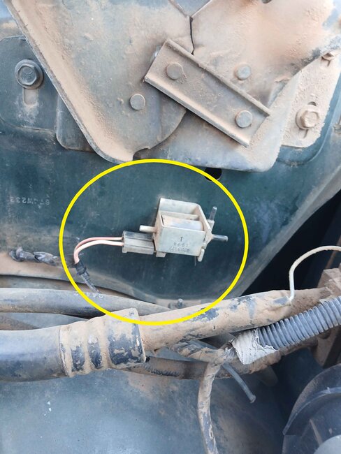

I have been working on this truck for several years now. I finally got it running and registered, but it's not yet road worthy. I am having trouble with the choke heater. The choke heater wire has never been hooked up as long as I have had it. I don't know where it is supposed to hook up, so I am looking either for the correct place or another suitable place to splice it into.

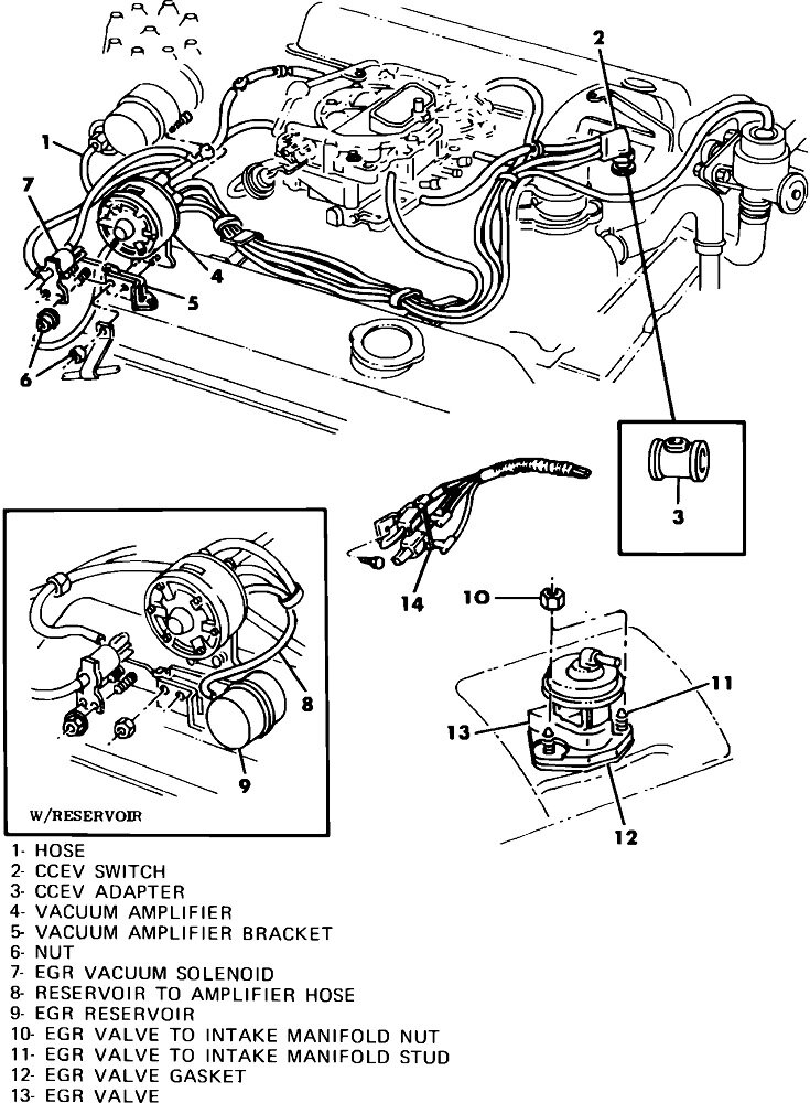

However, there is a device on my truck that I have no idea what it is. It is supposed to have vacuum lines going to it but has none. It does have a wiring connector with 2 wires going into it. One of the wires is pink and is testing to be hot, key on. Since whatever this device is, obviously is not vital to engine operation, I am thinking that I can tap my choke heater into there.
I have included 2 photos. The device is located above the passenger side fender well, toward the back.

What you circled is a vacuum switch, but I don't remember for what or when it turns on and off. See if you have a vacuum hose diagram on the emissions sticker under the hood or on top of the radiator shroud.

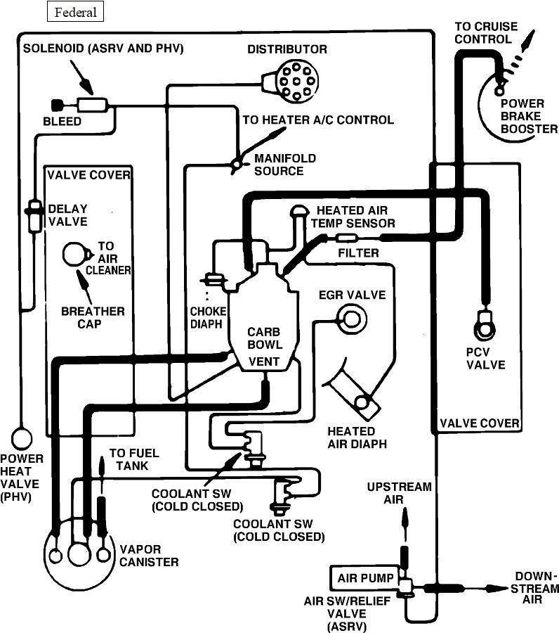

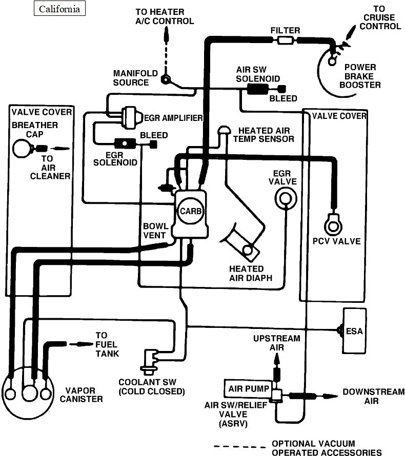

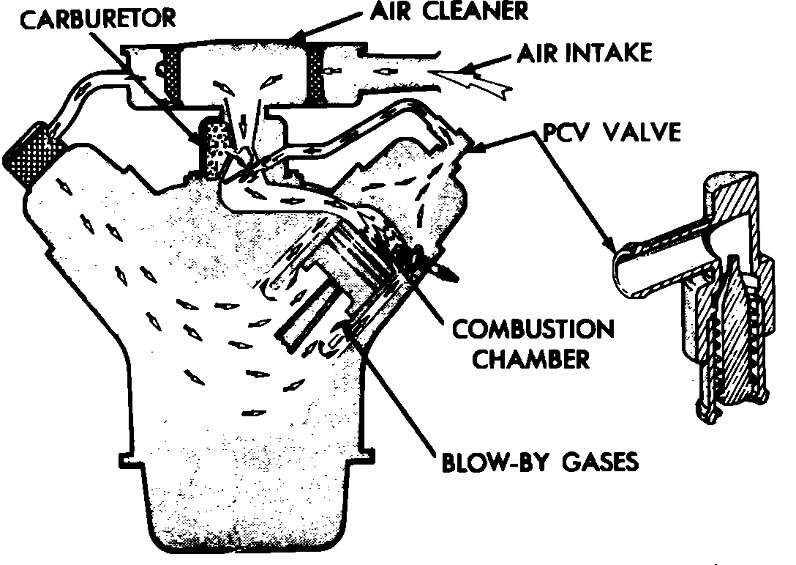

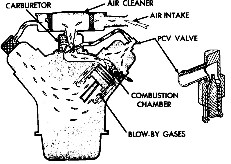

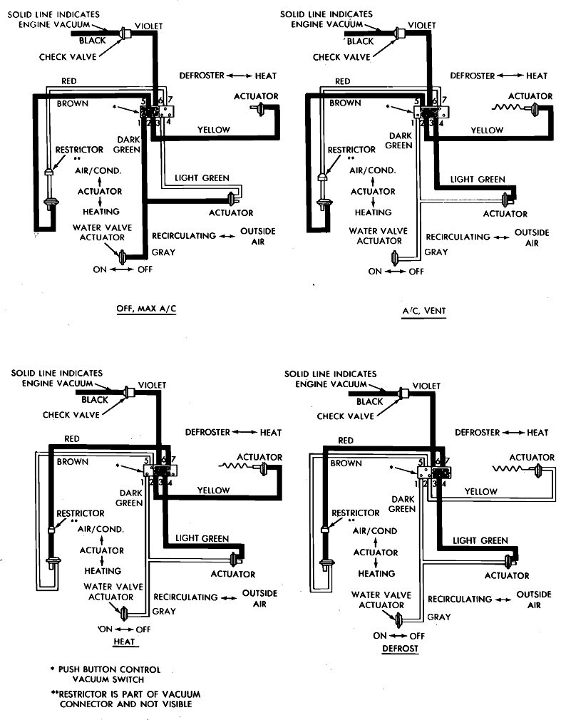

I found these diagrams to help with figuring this out. The first one is a sad drawing of the hose layout. The second is for the 49-state version. Third is for the California version. Next is the PCV system, and the last is for the heating and AC controls.

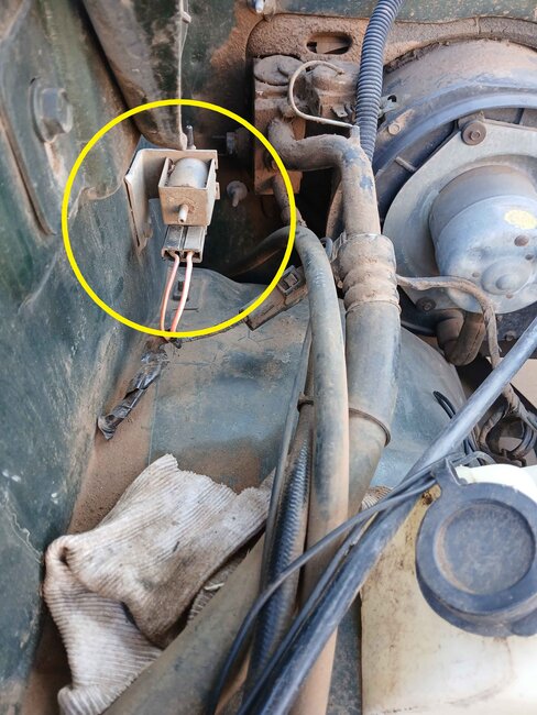

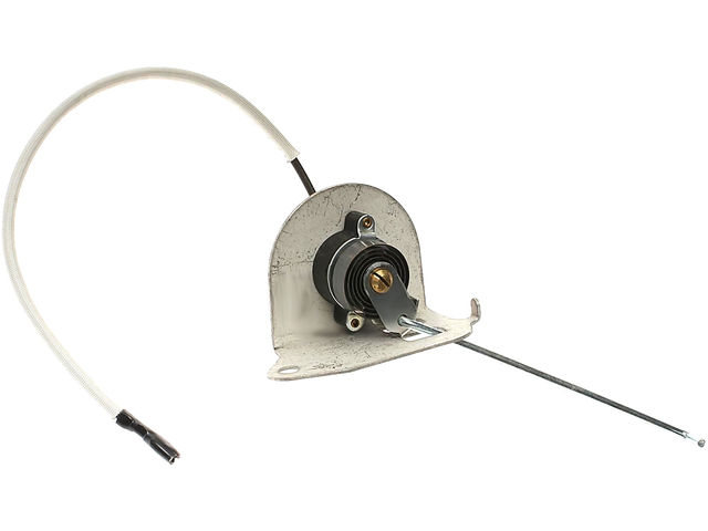

You quoted, “You may also find a flat white box, roughly an inch wide by about an inch and half long, right next to the choke linkage going to that thermostatic spring.” Nope, it's gone. I have included a photo of the type of Choke Thermostat that is on my carburetor.

Dandy. The type of carburetor doesn't matter. It's that thermostatic spring we're after. The pigtail wire in your photo is what needs to have switched 12 volts hooked to it. With a ground wire, you can watch it operate just as it is laying there in your photo.
I think I'd like to see that switch in the system, so the choke heater doesn't have to run continuously. You should be able to find them in a salvage yard. Model year shouldn't be an issue.
The vacuum pull-off is a different part. Its job is to instantly pull the choke blade open just enough at initial start-up for the engine to run right. There will usually be an "S"-shaped linkage, only about an inch long. Bending that linkage is how it is adjusted. Once the engine has started and the choke is pulled part way open, it's up the thermostatic spring to take over and finish the job within a few minutes.

Hi again. I tested the thermostatic spring by pig tailing it directly to the battery, and the spring never moved. The ceramic part that curls around the shaft connected to the spring didn't even get warm. My ex-husband said that if it was good, that ceramic part should have gotten hot, and the spring should have contracted. So, I guess I have to get a new one. The nearest junk yard is in Oklahoma about 65 miles away. By the time I spent the money for gas, I could save money by ordering a new one from the internet. I found a place that specializes in carburetors and parts. I can get one from them for $25 and $4. I hope this fixes the problem. I'd like to drive my truck and not be working on it all the time. LOL

He's right, it should get hot to do its thing. The spring will still work due to the heat from exhaust gas flow, as long as the heat riser valve is working, but it will take longer to open. You could have a too-rich condition for a few minutes.
One thing that comes to mind when you don't have the original carburetor for that year, is the rod extending out of the housing can be a different length. I've used some that were too long by putting an "S"-bend in it to make it shorter, but you can't go the other way and bend it to make it longer. This was always a cobble job because once the rod is deformed, unless you're really lucky, it will drag or stick where it comes out of the housing. Anything I ever did with them was a compromise over what came from the factory.
