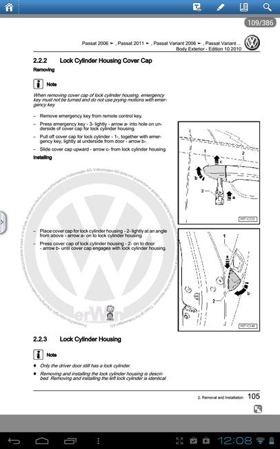

No response from both remote entry keys, key battery new. The vehicle is totally dead, cannot gain access to check battery.
3.2v6 4 motion model with full options. Vehicle is in Bahrain. No previous problems of this nature in the period of ownership which is 2 years, no hint of a battery problem before this occurrence.

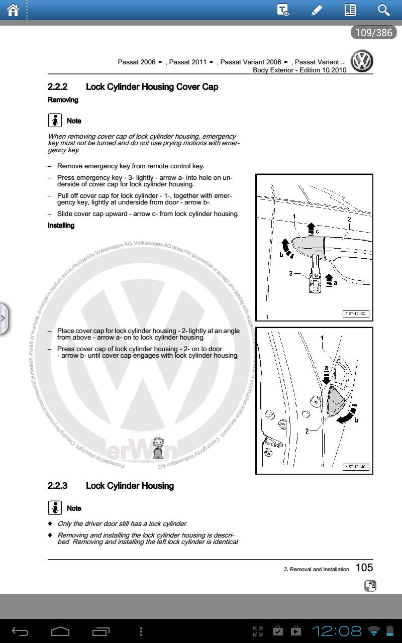

Well some people forget that is why I asked. You may be able to get into hood by going underneath then charging battery but not sure that would work either. Regardless you'll have to get into car anyhow. Funny our manual says you do have one see pic. I really don't know what else to tell you on this one.

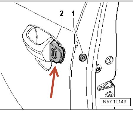

Try this. See attached image.

The image is downsized... not my doing
Here is the same image in original size:
https://www.2carpros.com/images/external/key.png

ROBERT MILLS
  • 5 POSTS
That is excellent, many thanks for all your efforts which is much appreciated.
