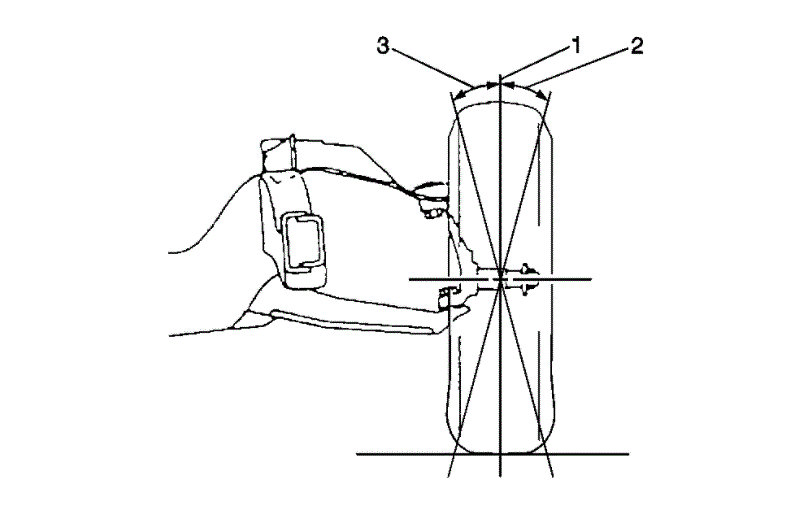

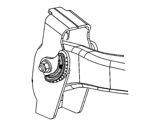

Forgot to mark camber position, I am getting alignment done after it’s put all back together. is there a way to get it close so I can drive to my buddies shop about 2 miles away with alignment machine?
Sep 26, 2020 at 12:00 PM
JDM333
I also put new coil overs on that raised the truck 2”.
Sep 26, 2020 at 12:04 PM
Good afternoon,
Just get the tires to sit flat on the ground. Do not let them pitch in or out.
I attached a picture of how the tire should sit and the location of the adjustment.
