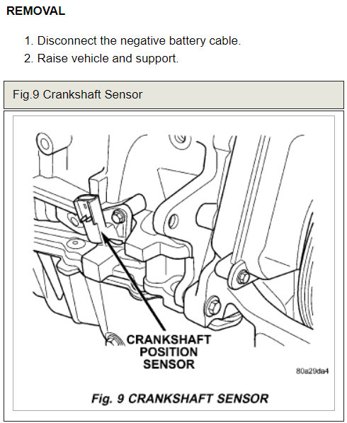

A few weeks ago when it was raining the car would crank over but would not start so I thought maybe it was getting moisture in the distributor. Christmas eve I went out and started it and it started right up for a few days then it happened again but it was not raining. So I checked the distributor and rotor they looked burnt so I replaced them. The car tries to turn over but will not start. We took the first wire out of the engine and put a screw driver in it to see if it was getting any spark (even held on to the metal part of the driver). I have called so many places and I cannot get it anywhere to have it checked. The check engine light is not on either.

This sounds like a classic crankshaft angle sensor failure which will cause the engine not to run. Here is a guide that will help you see what you are in for when you are doing the job.
Here is another guide that can help as well.
Here are some diagrams to help you get the job done.
