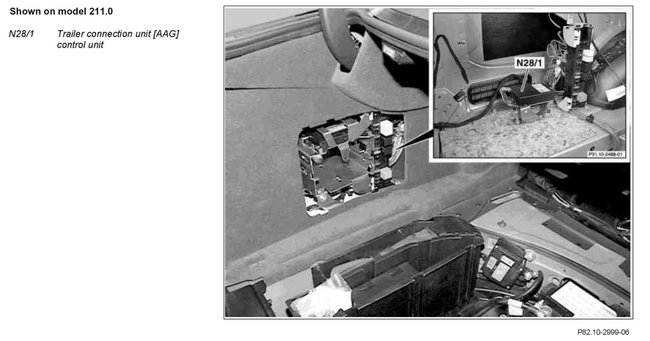

recently bought the car listed above and the turning signal on the right side/passenger side went out. I replaced the bulb but nothing. I check the socket and it was clean. I even switched the socket with the other side that was working and it still wouldn't work. instead, the driver's side was working with both the other side's socket and turning signal bulb. I was wondering if the 2005 E55 amg has a turning signal fuse or a relay for it. also if it could be a wiring problem?

It doesn't have a fuse for the individual lights. did you see if the socket is getting power and a ground? this guide can help:
The trailer control unit could be out here is the location below. Let us know what happens and please upload pictures or videos of the problem.
