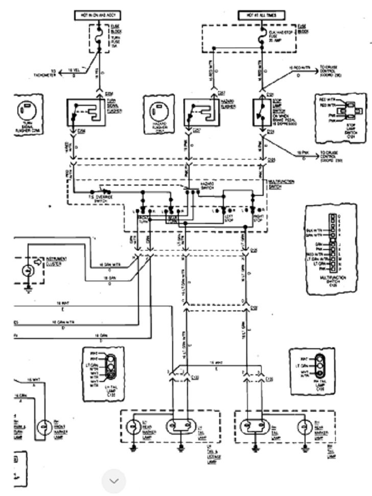

All lights function normal when using head light switch. Except when using signals. With ignition on, signals on left or right, all lights brightly flash front and back. When you turn parking lights on flashing stops. The hazards work fine when ignition is off. Also when ignition is off and you turn parking lights on, then turn signals, you can hear flasher relay, but no bright lights flash. Just a very very dim barely noticeable flash. All wiring, fuse box and lights have been replaced, including turn signal switch in column. Used a painless rewire kit. Thoughts?

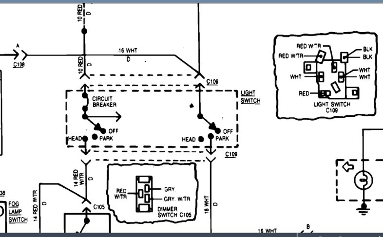

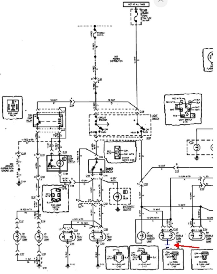

Signal and tail lights that act differently between head lights on and off is the classic symptom of a broken ground circuit. Probably the best way to verify this is to go to one of the signal lights when it is displaying the symptom, and measure the voltages on all three terminals. That has to be done with the bulb in the socket. You should find 12 volts on one for the tail lights, 12 volts pulsing on and off for the signal, and 0 volts on the third one. Typically when the ground circuit is broken, you'll find around 6 volts on the ground wire, and it will be bouncing around as the signal circuit turns on and off.
These diagrams are for the entire exterior lighting system. I apologize that they don't reproduce well. To add to the insult, they neglected to draw in the ground wires for the front signal / running light bulbs. I added the ground in blue for the left front bulb, and added a nifty red arrow so it's easier to find. Ignore the second diagram. It's just a repeat of the first one.
I found that if you right-click on a diagram, then click "Copy", it can be pasted in MS Word or another typing program. From there it can be expanded and retain as much clarity as when I originally formatted it to post here. That might make it easier to read.

Thanks Caradiodoc, from what I've read grounds were more than likely my issue. Now with your help I have a way to check them. Painless doesn't include any ground wires with their kits. I made sure each light had one. However I think somehow I might of cross one somewhere not sure. Keep you posted what I find.

Is the wiring kit you used supposed to be a direct replacement for the original one? If it is, are you able to read the diagrams I posted? The place to start would be to unplug every bulb and relay, then pick just one circuit to get working first. Plug in just the related bulb and / or relay and start with that. Look for 12 volts where it is supposed to be when you activate a switch. For this type of diagnosis, an inexpensive standard test light is a better choice over a digital voltmeter.

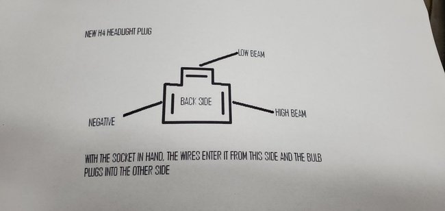

Also look at the bulb numbers for the head lights. Disregard this if you have the square glass bulbs. If you have the little round "capsule", the 9007 and the real common 9004 are not the same. Besides the filaments being turned 90 degrees to each other, the three terminals are different. I ran into a truck with all kinds of goofy symptoms, but most notably, once the high beams were turned on, when the head lights were turned off, the left outer one stayed on. Turns out the two inners were supposed to be 9004s and the two outers were supposed to be 9007s. With the wrong bulb in one of those sockets, due to the different terminal basing, one bulb back-fed the "High Beam" relay and kept it turned on all the time until the battery was disconnected and reconnected. That simple mistake of installing the wrong bulbs cost us hours of fruitless diagnostic time.

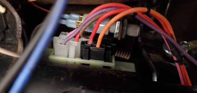

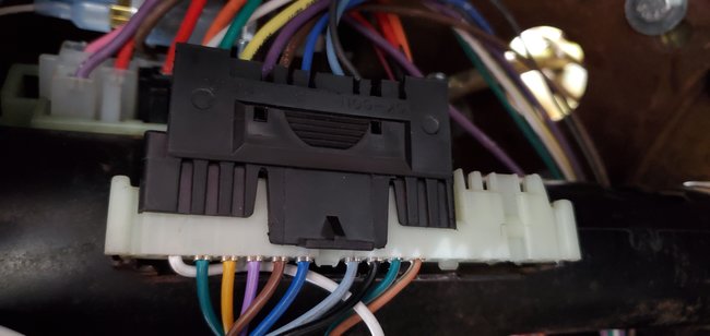

Do you have a diagram were each headlight wire goes on GM switch and the one on column?
If I disconnect headlight switch will turn signals still work? Thinking no, I believe the power to lights go thru switch?
I've looked at some on internet, but they can be confusing, like is the pic shown- wires shown going in on pin side or when you look at front of connector.
Friday, November 20th, 2020 AT 10:20 PM
SRS20
  • 10 POSTS
I took some pics, of the connections I'm questioning.

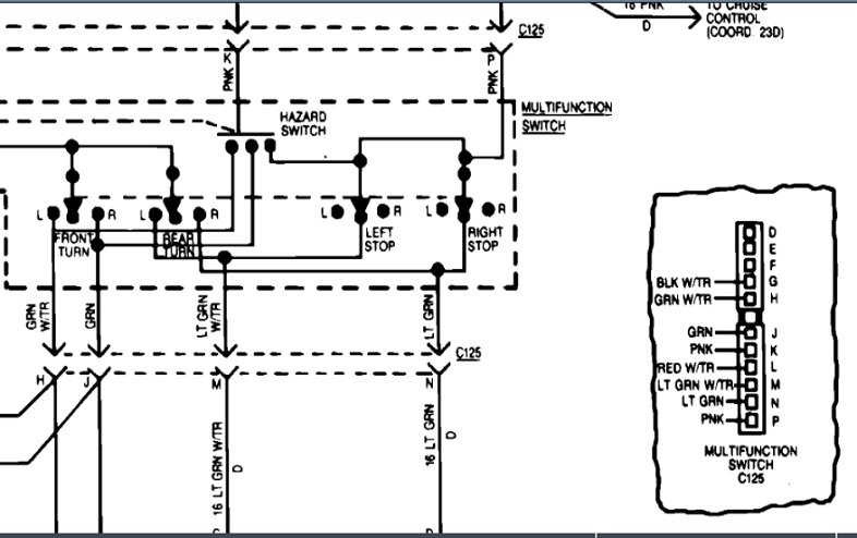

The head light switch is not involved with the turn signals, but obviously it is with the tail lights. The only thing the two systems have in common is the bulbs.
If the brake lights work correctly, the wiring should be correct from the turn signal switch all the way to the rear brake lights. The rear signal and brake light use the same filament in the bulb. When the signals are off, current can flow from the brake light switch, through a pair of contacts inside the signal switch, then to the bulbs. When you activate a signal, that switch breaks the bulb circuit from the brake light switch and connects it to the flasher circuit.
I blew up parts of the two wiring diagrams so you can see the plugs better. The first one shows the head light switch, and the dimmer switch is just left of center at the bottom. The second one shows the multifunction, (signal) switch. Have you been able to see the diagrams or do I need to blow them up more?

The diagrams are very readable. Are these for GM or Jeep? The painless system is all GM parts.

The diagrams are from AllData which uses a copy from the manufacturer's paper service manual.
