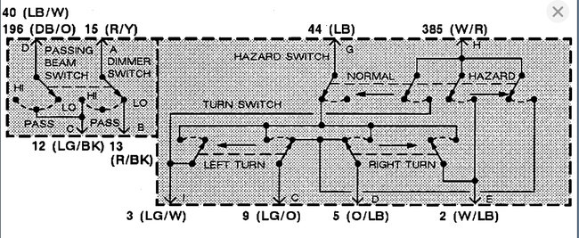

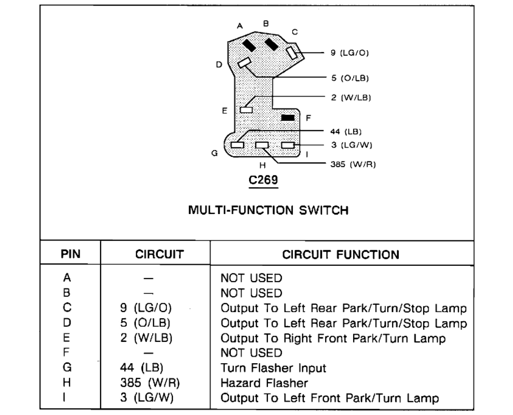

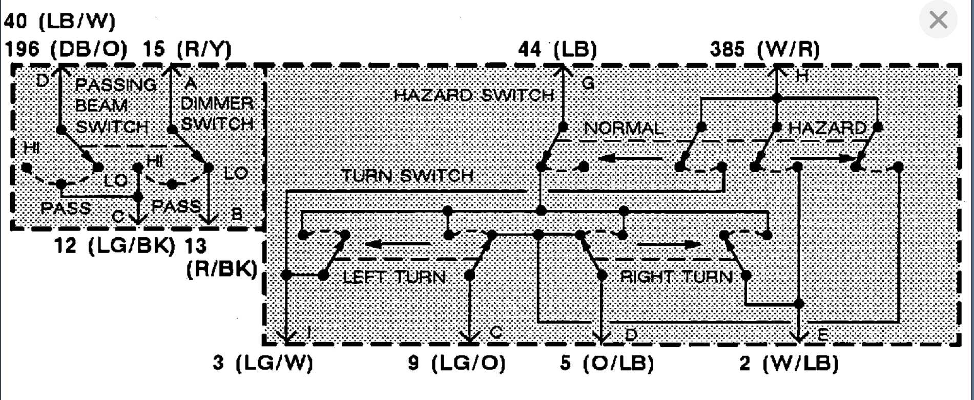

I have a problem with wiring the turn signal switch Pig Tail for the Blinkers ?
Tuesday, June 29th, 2021 AT 11:12 AM
MECHANIC
52,796 POSTS
Good morning,
I attached the diagram of the switch itself. I also attached the diagram of the connector which identifies the location of the wires.
Let me know if you have any other questions.
