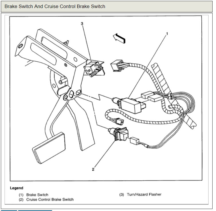

KEN L
  • MASTER CERTIFIED MECHANIC
  • 55,488 POSTS
It sounds like you have a turn signal/hazard flasher that has gone out. I would start by replacing it here is its location.
