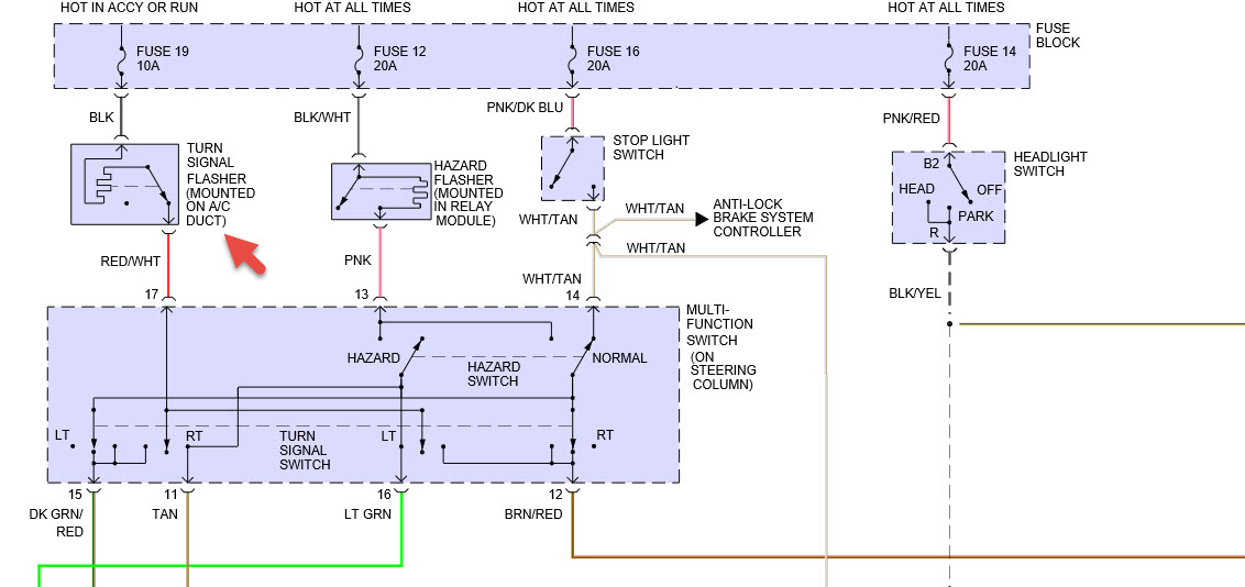

The turn signals and the four-way flashers are not working. I have checked the fuse it is good.

Check the flashers both may be bad. If both work then it may be the multi function switch. See picture.
