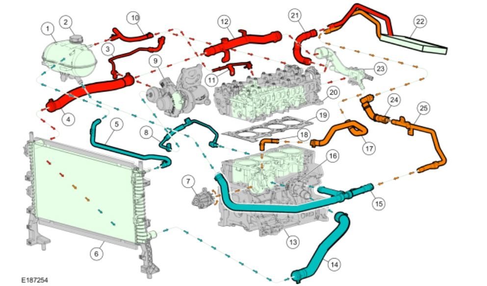

I have the car listed above EcoBoost convertible. I just want to know if the turbo on it is cooled by coolant and oil or just oil? I have heard I need to let the car idle for a minute or two on turbo cars, but I think I see coolant lines going into the turbo, but I am not sure.
Dec 19, 2018 at 8:01 AM
  • CAR REPAIR CONTRIBUTOR
Good morning,
The oil lubricates the turbo bearings and yes, coolant runs through to assist in keeping the turbo clear.
Below is a chart. number 3 and number 8 are the hoses to the turbo in the picture.
Item Description
1 Degas bottle
2 Pressure relief cap
3 Turbocharger outlet tube
4 Upper radiator hose
5 Radiator-to-degas bottle hose
6 Radiator
7 Coolant pump
8 Turbocharger inlet tube
9 Turbocharger
10 Engine vent hose
11 Coolant outlet tube
12 Coolant outlet connector
13 Engine block
14 Lower radiator hose
15 Coolant return hose
16 Thermostat housing
17 Coolant bypass hose
18 Coolant bypass connector
19 Cylinder head gasket
20 Cylinder head
21 Heater core inlet hose
22 Heater core
23 Coolant outlet connector adapter assembly
24 Heater core outlet hose
25 Heater core outlet tube

Thank you so much for the help, that was exactly what I needed. Where did you get those pictures? I would like to get my hands on some engine schematics for future repairs.
Dec 19, 2018 at 8:46 AM
You are welcome.
They were from Aldata. They have tons of pictures available.
