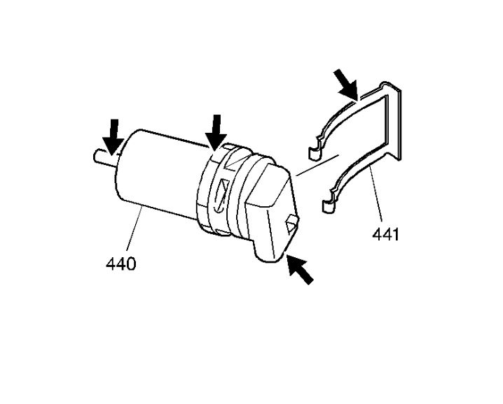

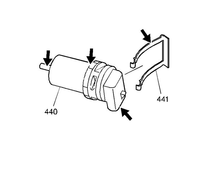

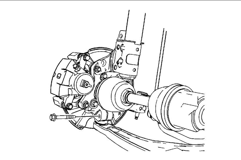

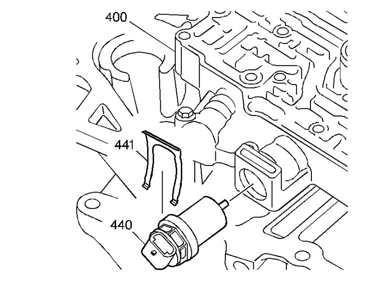

Where is the speed sensor located for my 6spd Malibu 2008. It’s a V6 with a 3.6L engine.

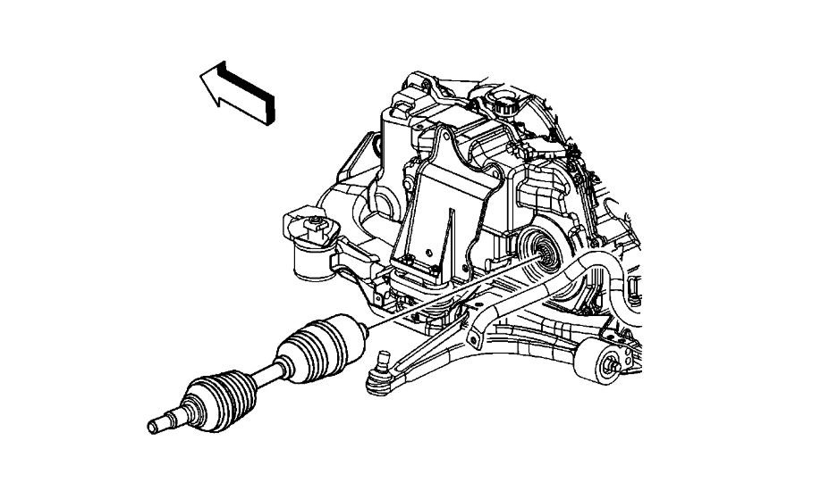

The sensor is in the valve body. The side cover has to be removed to gain access to the sensor.
The side cover is very involved in removing as part of the suspension, the axle, and the cradle has to be dropped to get the cover out.

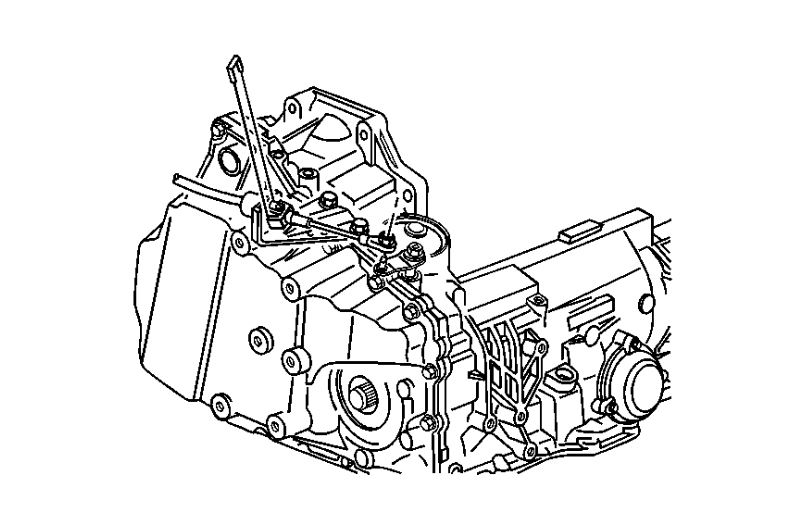

3. Remove the shift cable from the transaxle range selector.
4. Remove the transaxle shift cable bracket bolts and the bracket from the transaxle.

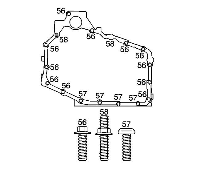

6. Remove top side cover bolt (56,58).

9. Remove the left front wheel.
10. Remove the inner fender liner.
11. Remove the wheel speed sensor harness from retainers on lower control arm.
12. Remove the left transaxle mount.
13. Remove the front cradle to radiator support brackets on each side.

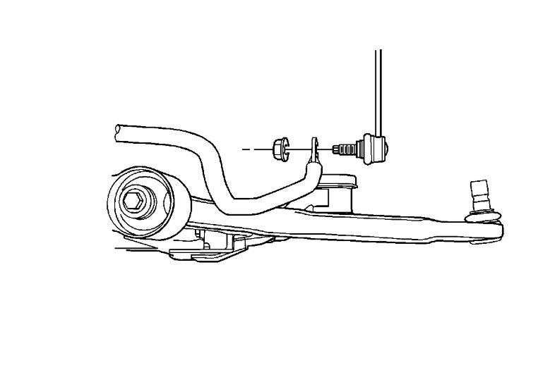

14. Remove both stabilizer links from the stabilizer and reposition stabilizer to access steering gear- to-frame bolts.

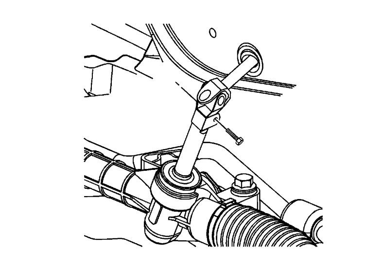

15. Remove the intermediate shaft to steering gear pinch bolt.

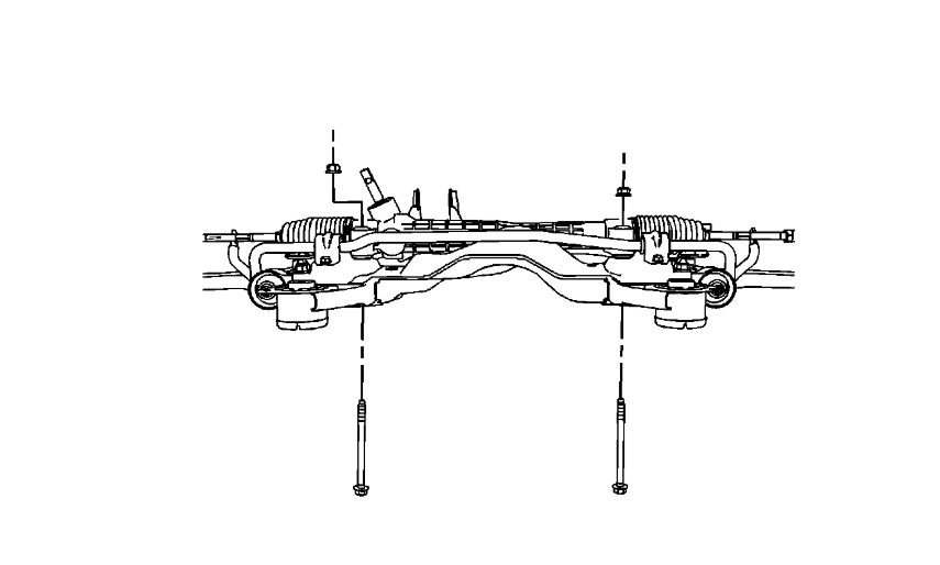

16. Remove steering gear-to-frame bolts and support steering gear.
17. Remove the left side ball stud from the steering knuckle.

22. Remove the left drive axle from the transaxle.
23. Secure the drive axle to the strut assembly.

28. Remove the remaining case side cover bolts (56, 57, 58).

Thank you for the fast response. Does this sensor need need to be reprogrammed?
Sep 16, 2019 at 8:57 AM
  • CAR REPAIR CONTRIBUTOR
No, it does not.
