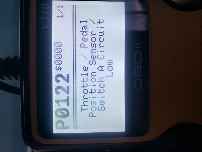

Not letting me reply. Put new pcv valve on it. Runs somewhat better. Idling in the 1500s. But not staying constant. Got 1 code

This is for the TPS. If you had it off, make sure you installed it correctly or it will code.

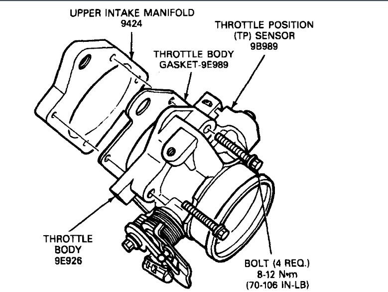

TPS
REMOVAL
1. Disconnect Throttle Position (TP) sensor electrical connector engine control sensor wiring.
2. Remove the two throttle position sensor retaining screws.
3. Remove the throttle position sensor and throttle position sensor gasket.
INSTALLATION
1. Position the throttle position sensor on the throttle body. Make sure that rotary tangs on sensor are in proper alignment with the throttle shaft blade.
NOTE: This throttle position sensor is non-adjustable.
2. Secure throttle position sensor to throttle body with two retaining screws. Tighten to 3-4 Nm (28-35 lb in).
3. Connect electrical connector to the throttle position sensor.

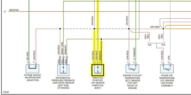

That's the way I installed it. Even went back and tried old one again.
Thursday, May 28th, 2020 AT 3:34 PM
  • 52,797 POSTS

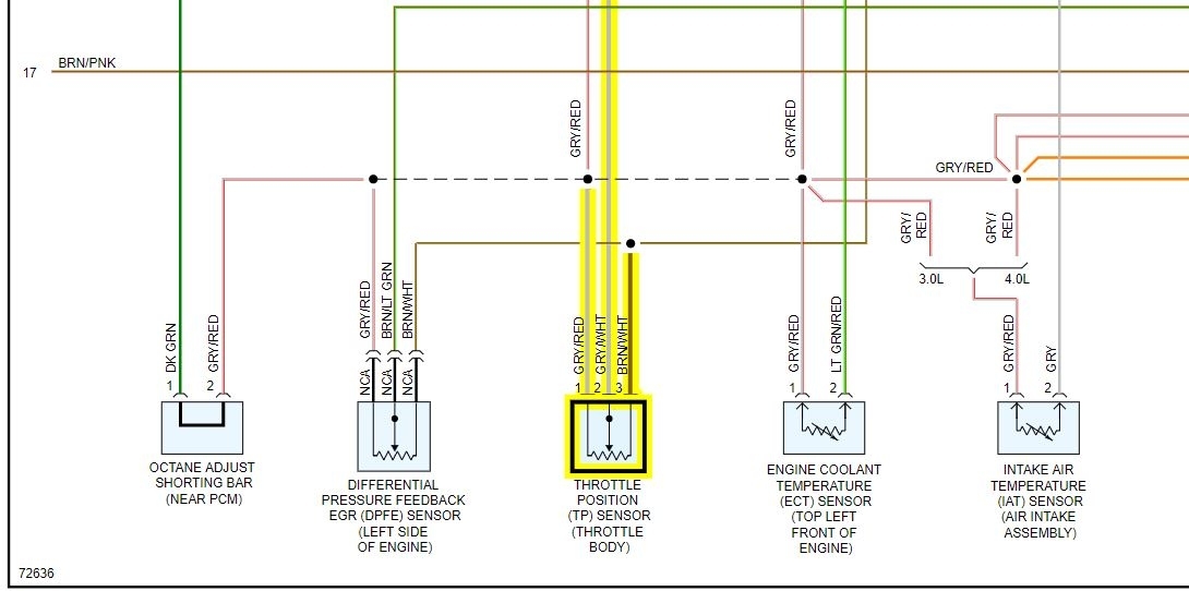

Did you check the voltage on the signal wire? You have 3 wires, 5 volt reference, signal and return.
The signal wire should show about.5 volts at idle and 4.8 at full throttle.
Can you check that?
EWC177
  • 144 POSTS
When I get home. At work until 4:00 and then a hour drive home.
EWC177
  • 144 POSTS
Which is signal wire? And how do I hook up a tachometer to this vehicle?
  • 52,797 POSTS
Brown/white is ground.
Gray/red is reference.
Gray/white is the signal. That is the one.
