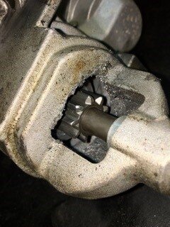

I've owned this truck for 3 years; this is the 5th or 6th starter I've installed. I've had a mechanic look at it and he couldn't tell me why they keep failing. Anyways, the truck wouldn't start the other morning, has gas, power and spark, so I dropped the starter and found metal shavings and grey gunk on and around the gear. Wondering where this could be coming from. I also discovered an oil leak, from the pan I think, and being parked in a driveway, the oil has travelled down and dripped a little on the starter. I've done a lot of work on my truck. The most recent being new transmission installed, (mechanic installed, Jan 23'), new head gaskets (Nov 22"), new radiator (Oct 22').

I looked at the picture. Have you inspected the flex plate to make sure the teeth that meet with the starter are okay?

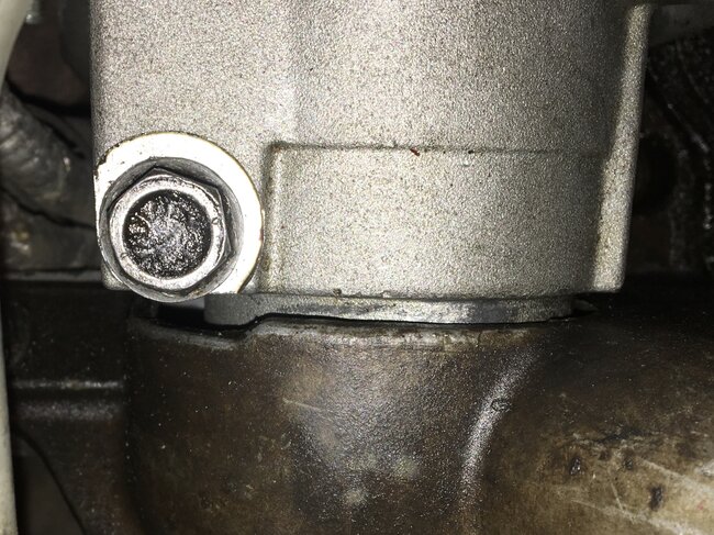

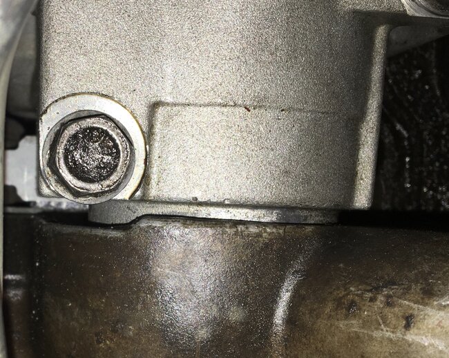

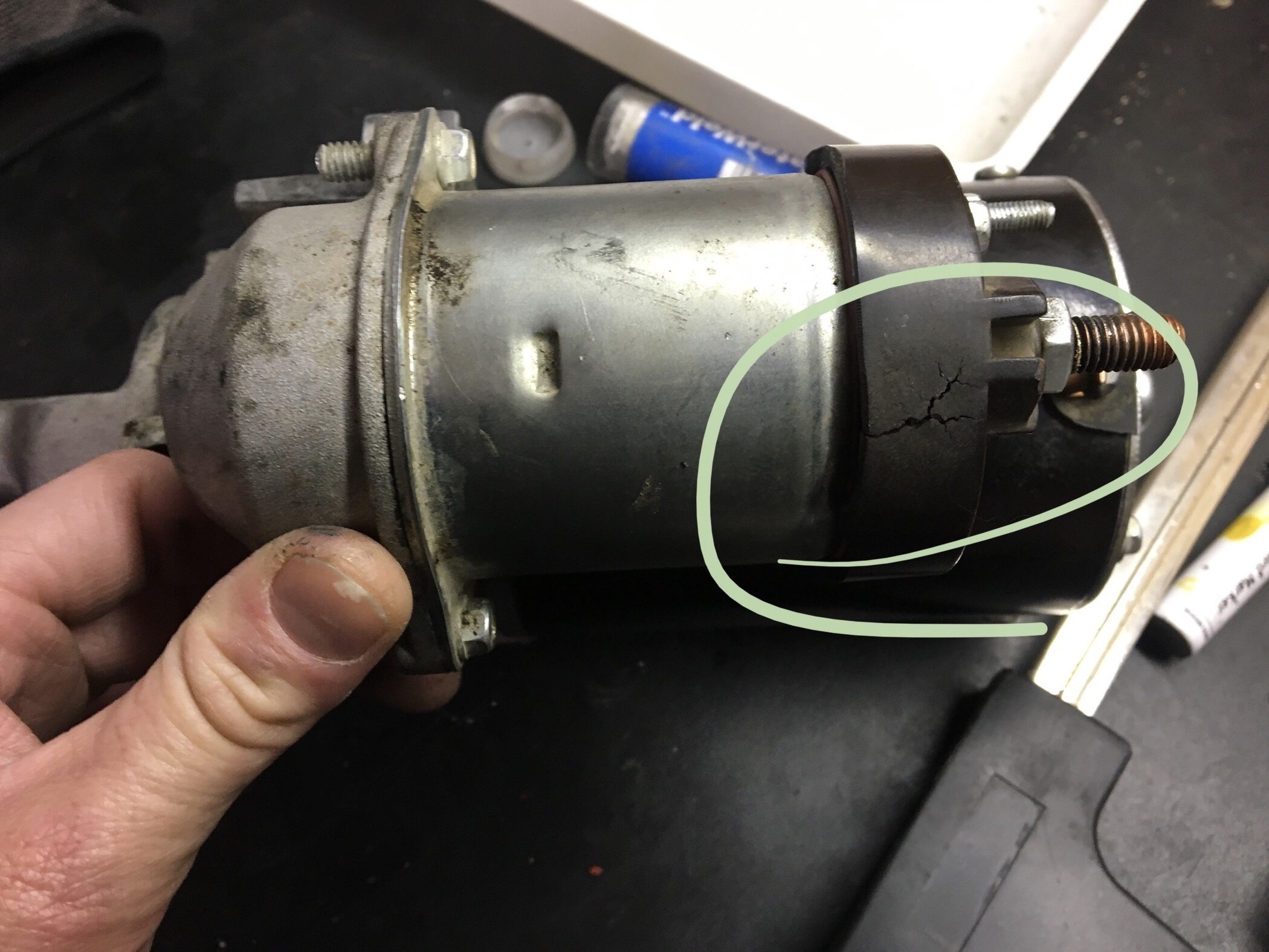

Okay, so there seems to be less power trying it this morning. There are metal shavings in the flex plate housing as well and the teeth feel really rough on the edges. Of course, that’s where it’s coming from, where else, right? Thinking too hard about this probably. Looking at the starter on my workbench right now and I see the plastic on the solenoid is cracked. I’ve had a starter crack before, but it was on the nose, around the gear. Also, Idk if this is an issue, I feel like it is so I'm going to tell you about it. The starter doesn’t meet up with the bell housing. I’ll post pics. The first pic of this shows the starter with a spacer, the second is without. I can’t seem to find anyone that: a) has this issue; or B) has heard of it or has a suggestion as to what a solution could be. I’ve tried finding a spacer of sorts to fill in the space but so far, I haven’t found anything that works.

I looked at the pics. First, replace the starter due to the crack. We don't want that coming apart and shorting.
Next, I do see a slight opening. Are you certain this is the correct starter motor for your vehicle? If it isn't in the entire way, that will damage the flex plate and starter drive gear.
By chance, are you getting the same replacement brand/part each time it fails? I can tell you the OEM part number is 10465167. Can you contact the parts store and confirm that is the correct starter if they cross-reference the part number?
Also, do the teeth on the flex plate feel rough on the trans side, the starter side, or everywhere?
