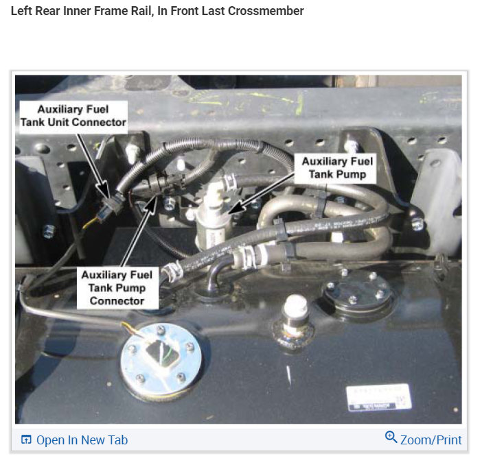

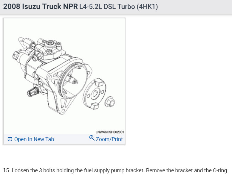

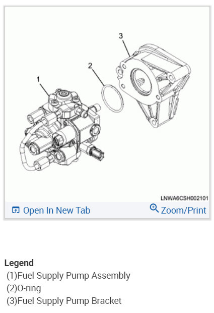

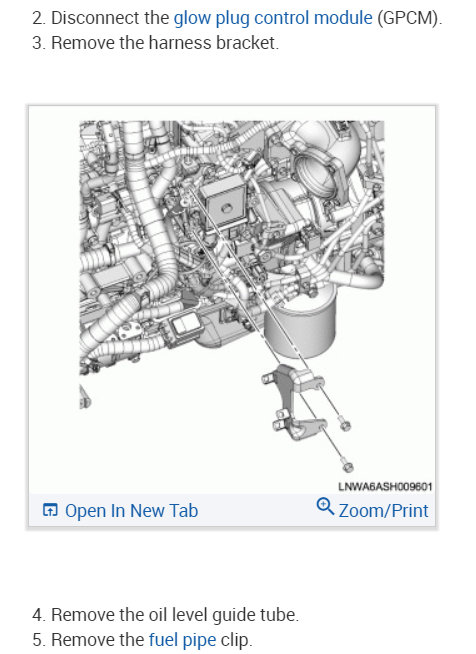

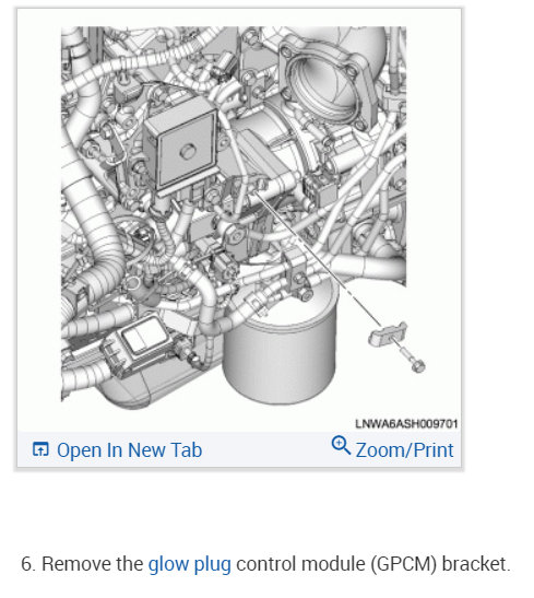

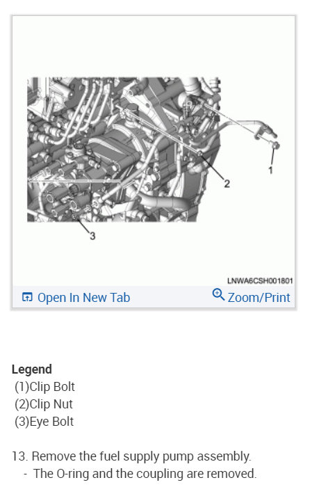

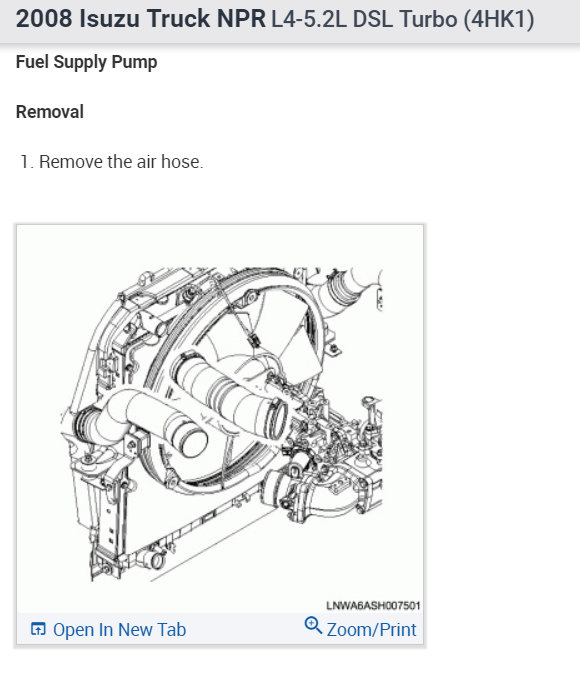

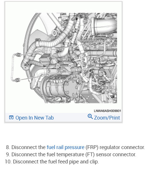

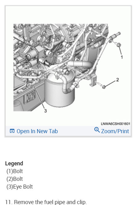

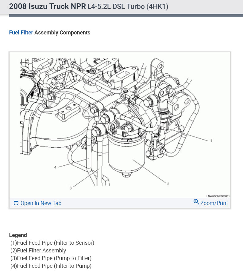

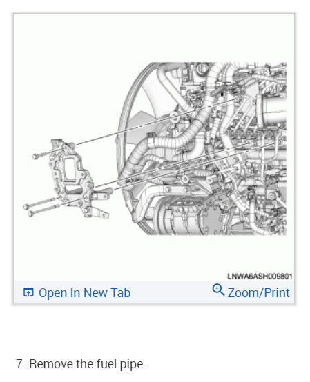

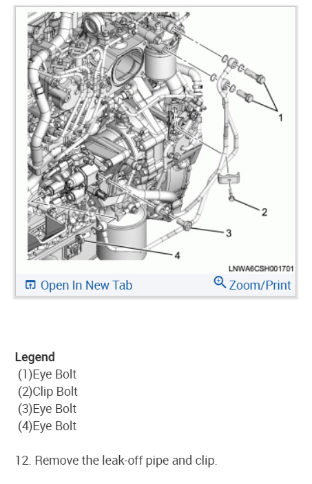

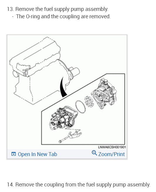

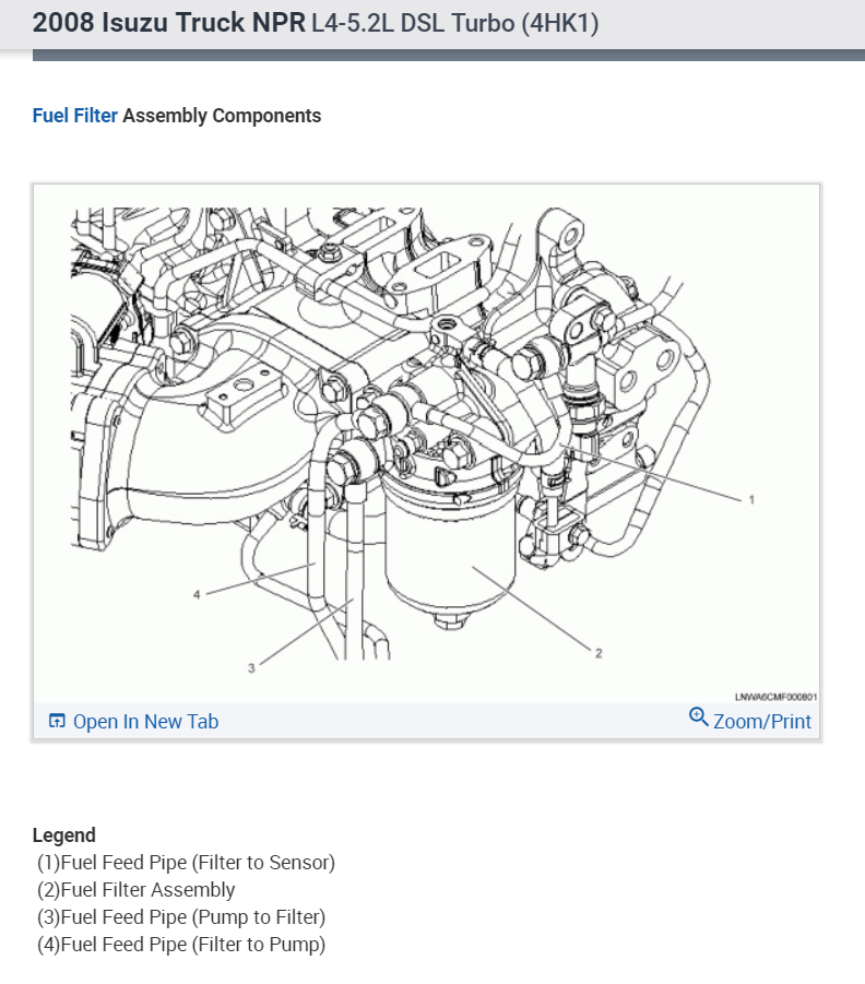

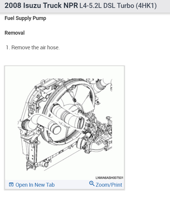

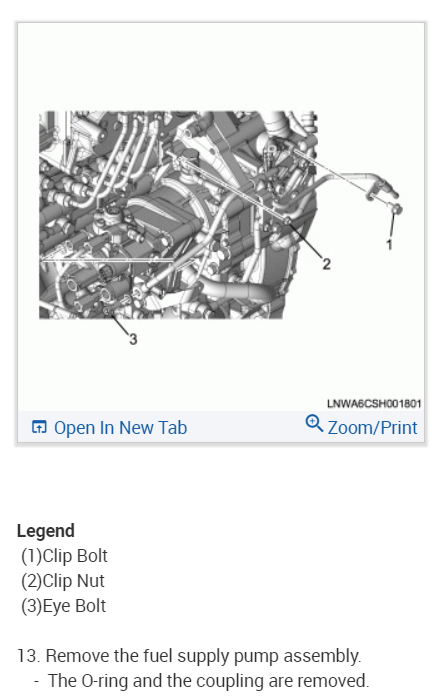

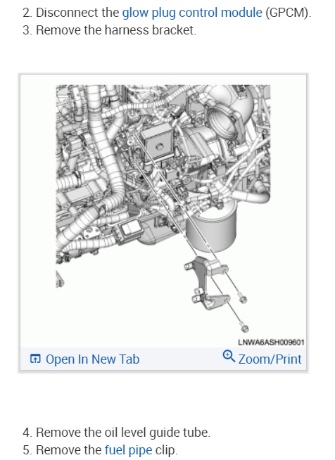

It sounds like the auxiliary pump which feeds the main pump is out. Turn the key to the on position and place your hand on the pump to see if it is working. If so the main pump can be out. Here are diagrams to show you the location and what you are in for when doing the job.
Check out the diagrams (below). Please let us know what you find.
