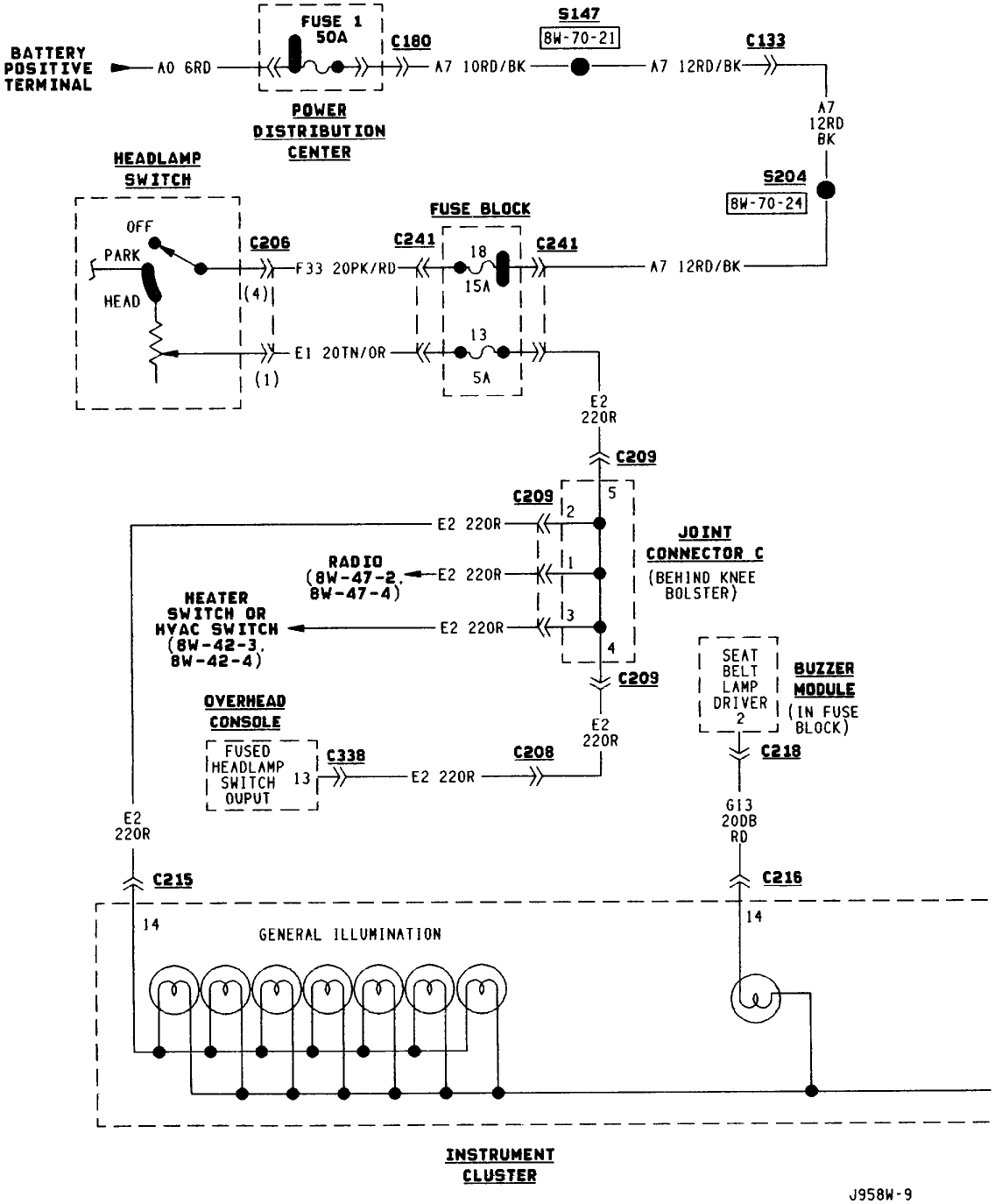

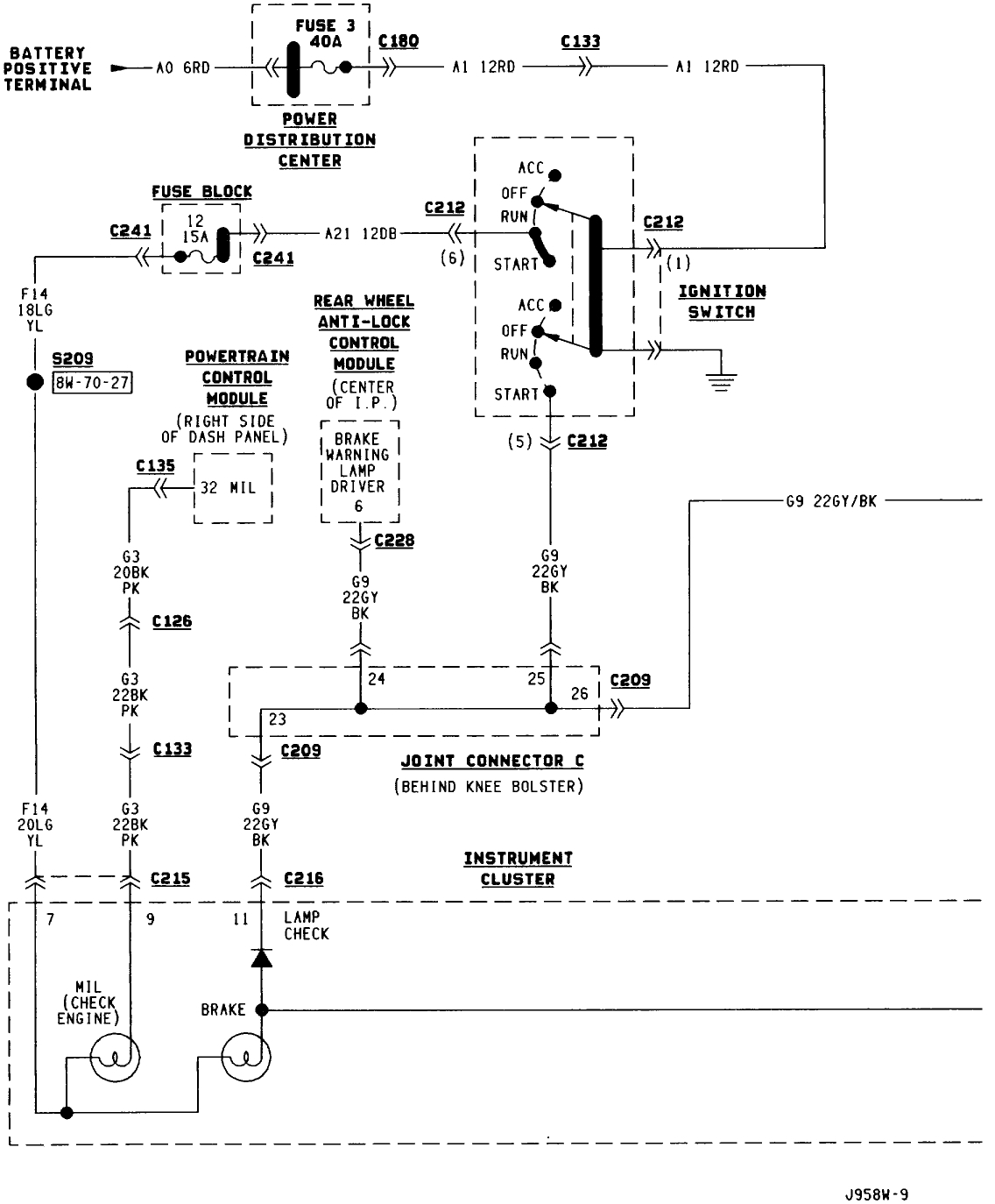

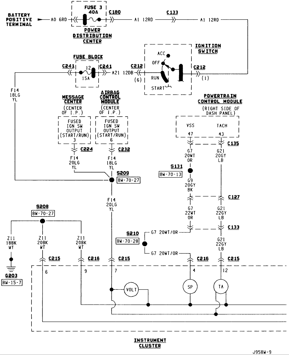

Took the instrument cluster out to switch known bulbs around to get check engine light to work. Still not working with a known good bulb. Instrument cluster printed circuit board not broken or burned anywhere. Put back together and now tachometer and volt meter not working.

BTDT. I would look real close at the connector to the panel. It does not take much to bend a pin or have one that is loose enough to cause issues.

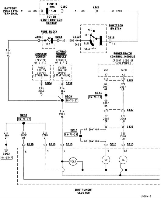

As for the tachometer not working, I would go look at the crank position sensor, they are known to fail as they get hot and when they fail completely you get no tachometer motion while cranking and the engine will not run. Even though it was tested "good" I have seen them still be bad.

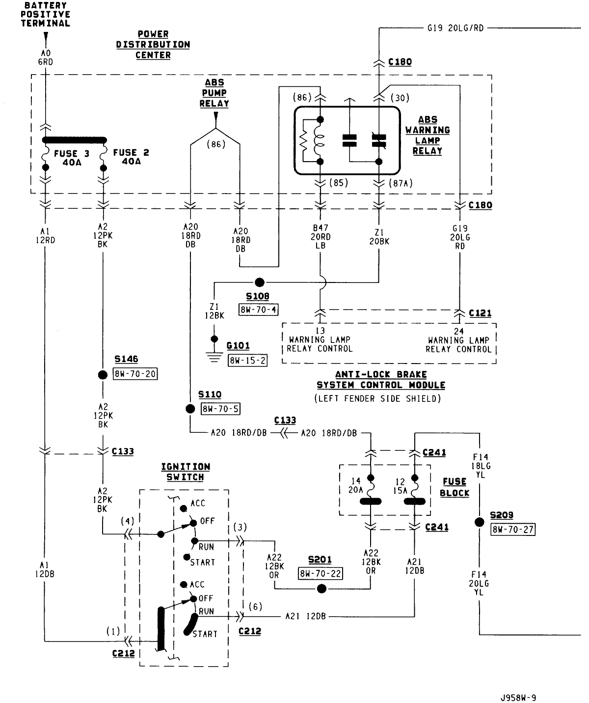

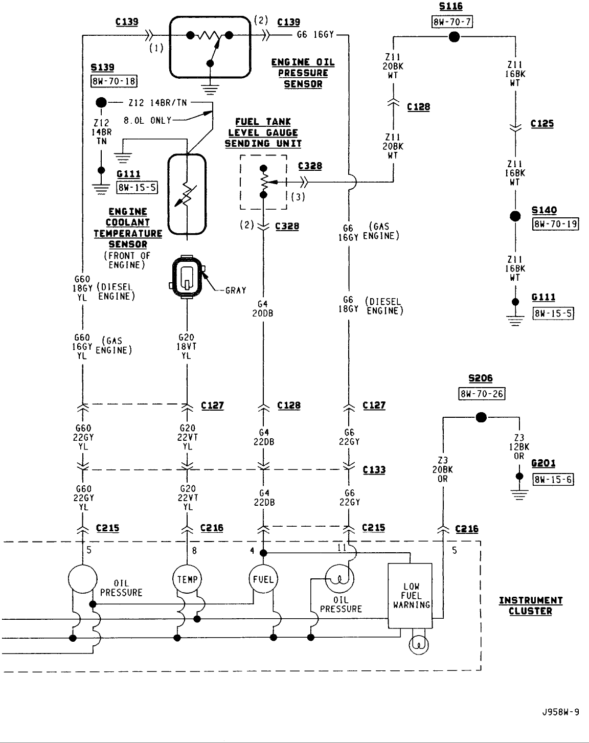

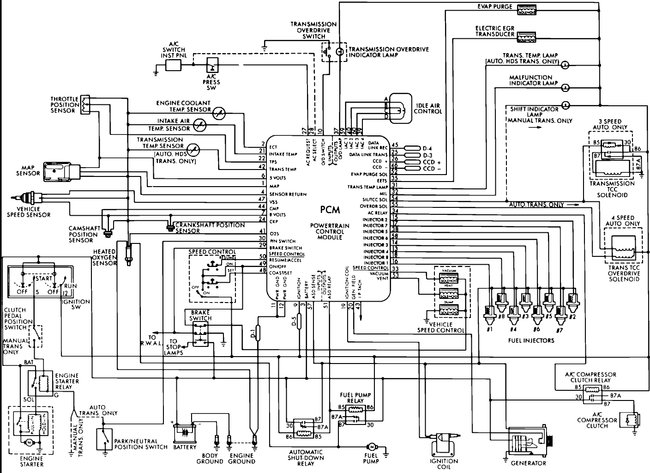

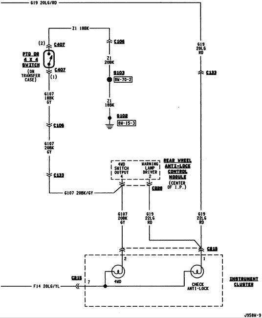

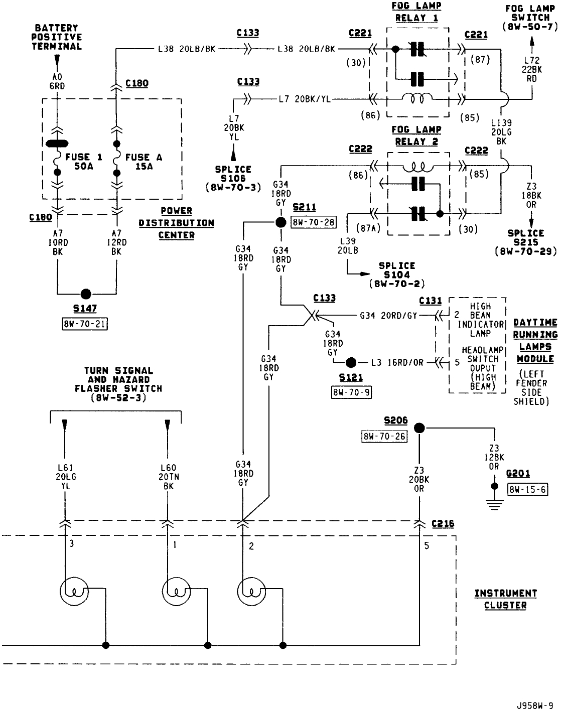

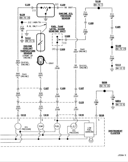

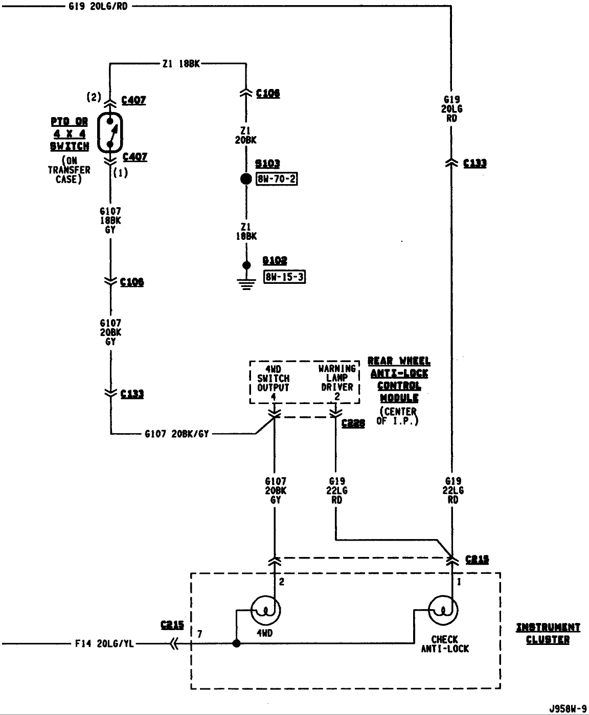

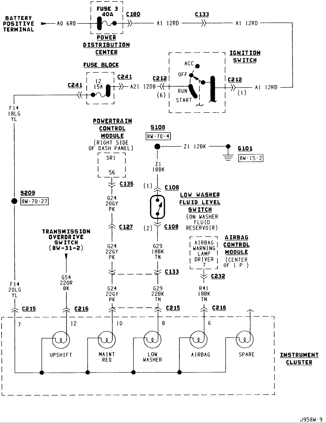

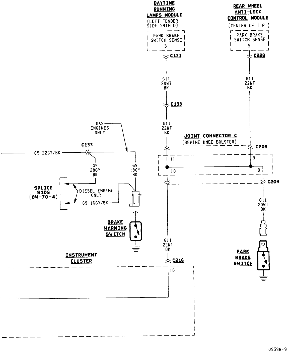

These are the IP circuit diagrams, might help you think through those at least.

Tachometer and volt meter quit after I removed and replaced the instrument cluster, and the crank sensor is new.

Backfire still sounds like a timing issue and that is controlled by the crank sensor. But I have also seen O2 sensors in a Dodge 5.9 do that same thing. The sensors would drop offline for a second and you would get a bucking, lunging and then a backfire. The other issue on the 5.9 is vacuum leaks due to the intake pan gasket failing. In the case of a large backfire it may have blown that gasket out and now it has a large vacuum leak under the manifold.
