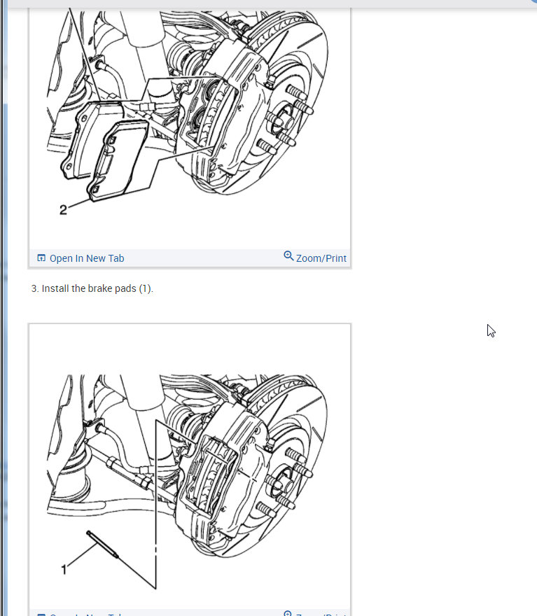

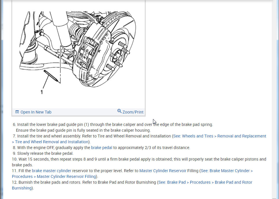

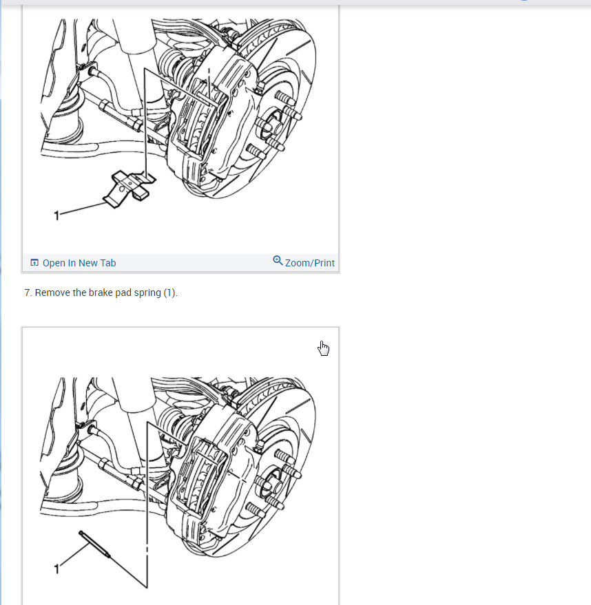

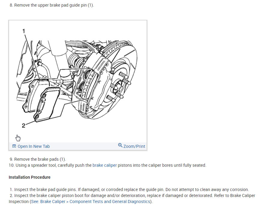

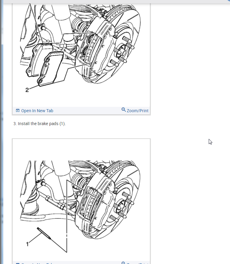

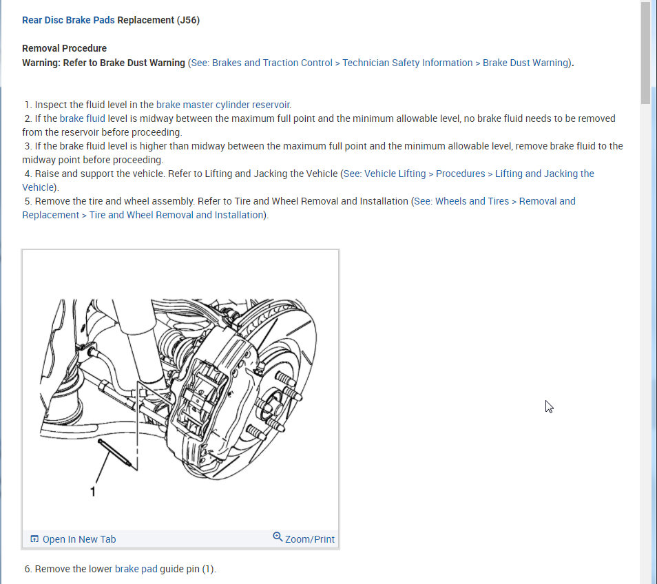

The mechanic said that I need new rear brakes?
Wednesday, July 3rd, 2019 AT 3:32 AM
MECHANIC
18,907 POSTS
Here is a guide that will help with this:
https://www.2carpros.com/articles/how-to-replace-rear-brake-pads-and-rotors
https://www.youtube.com/watch?v=j8YwfSKEzZo&t=29s
Below you will find the process from the manual that will show how to replace this as well. Please let us know what you find. Thanks
