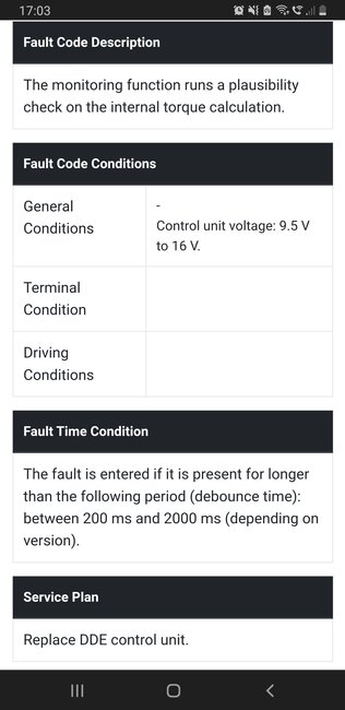

DAVIEBABBS
Hi there!
I am getting this code again 2A8B00.
Except this time its advising to replace DDE?
Really confused as this code came up before for the DPF?
