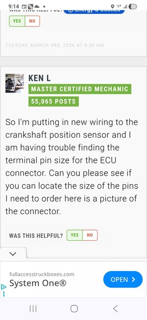

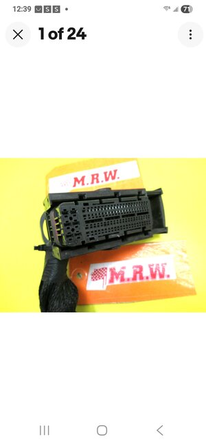

So I'm putting in new wiring to the crankshaft position sensor and I am having trouble finding the terminal pin size for the ECU connector. Can you please see if you can locate the size of the pins I need to order here is a picture of the connector.

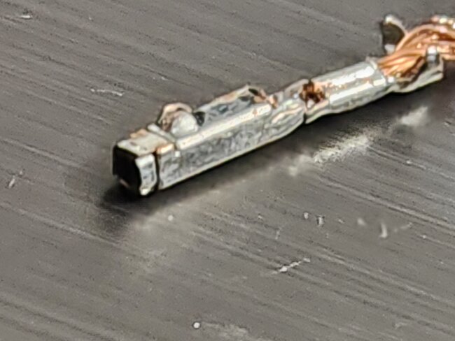

Approximately 2mm squared x 16 mm long

What I recommend ordering
Look for:
0.64mm ECU terminal pins 20-22 AWG
or
Bosch / Hyundai ECU Micro-64 terminals
Those are the ones most harness builders use.
