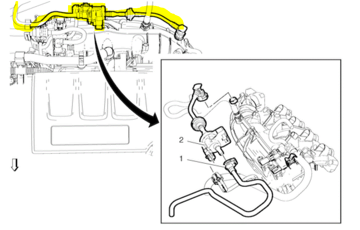

I get the following codes:
P0496 and P0171.
Once both came one, other times only one will come on.
The last 3 times I filled the car with gas and go to start the car, the car will act like it's not getting enough gas. it eventually goes away but when I drive for a short time and turn off the car, it will keep running, but sluggishly.

The P0171 indicates a lean fuel mixture and code P496 is related to the canister purge valve which is part of the emissions system.
A lean mixture is usually the result of an engine vacuum leak. The two are likely tied together.
First, I attached a pic below. Open the hood and locate the component I highlighted. Check the vacuum hoses on both sides of that for damage, dry rot, being disconnected, or anything you feel could cause a leak. The component is the canister purge valve.
See pic below.

No leaks found, replaced the purge valve and it seems to be fixed now.
Sep 10, 2021 at 2:07 AM
  • 110,193 POSTS
I'm glad to hear it's fixed. The purge valve was likely stuck open causing a vacuum issue.
Regardless, I'm glad to hear it's fixed. Please feel free to come back anytime in the future if you have questions. You're always welcome here.
