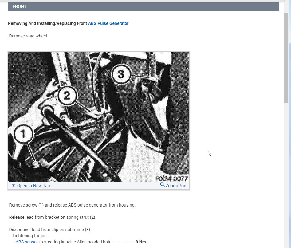

Trifecta lights on dashboard ABS pressure TIR and triangle MIT circled arrow. Diagnosed points to left ABS speed sensor.
Jun 5, 2020 at 6:53 AM

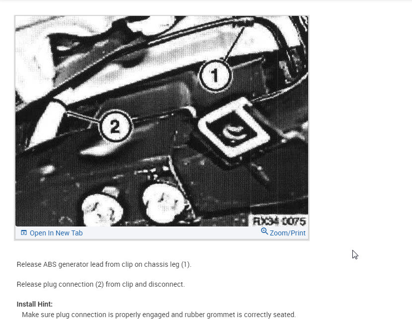

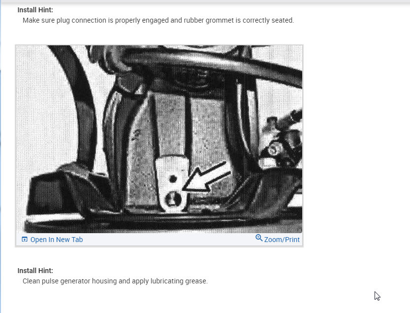

More then likely this is the wheel speed sensor but if you provide the actual code that you are getting, I can send the diagnostic if you would like to confirm this is the sensor. However, here is the process on how to replace this sensor.
Let us know if you need more info. Thanks
