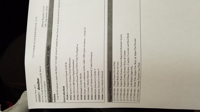

My vehicle has been trembling and stalling out of no where. Ran the codes this weekend and it said it was the cam shaft sensor. So we changed it. Then today it is misfiring so bad I could barely get home from work. Fluids are all good. I keep an eye on that anyways because I am just paranoid. Lol but anyways, today it said it was misfiring on all six cylinders. A while back it overheated and started sounding like a really quiet diesel but the mechanic could not find anything wrong with it. I am about to change the plugs once it cools down, but does anyone have any ideas?

What were all of the exact code numbers? Not what someone said they meant.

Ignore the camshaft, that is an old code that did not get deleted after we changed it.

What
if
in some Jeepless world, someone "Interpreted" your "P" whatever, whatever, whatever Code sort of wrongly (like camshaft sensor codes might not necessarily mean "change the sensor"
So anyway it was done. Yay! You have a new one!
But the "possible" real meaning of the code may not have been addressed at all.
You still have a problem.
Cannot just rule this "maybe fix" as the real fix.
Code Numbers?

Just saw your picture
Duh!
Was it P0340? Or something else?

Yes, that was the code. The sensor was definitely bad though. Should have seen it when we got it out.

Did the connections look good? Maybe one is not making a good connect to its opposing mate.
Here is what I was talking about with the code.
http://www.obd-codes.com/p0340
See, it is not just change it out in all instances.
Any more/ or the same codes surfacing still?
