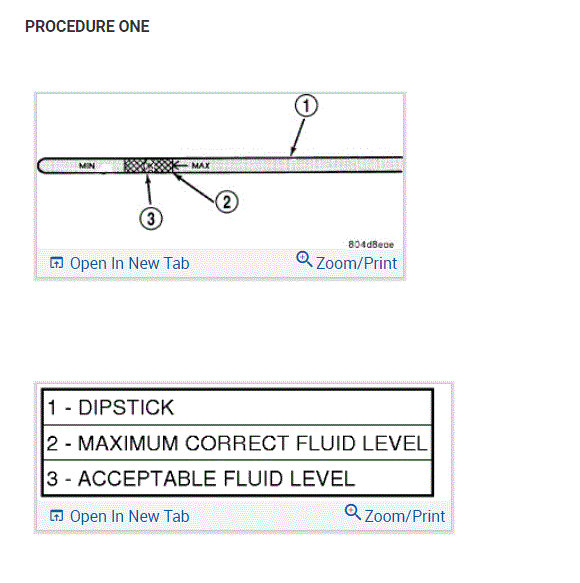

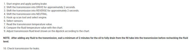

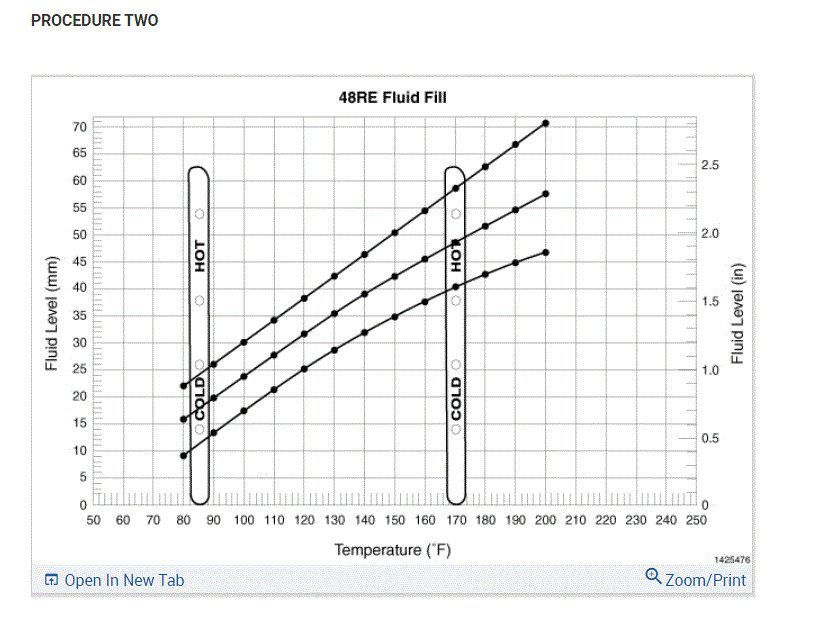

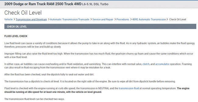

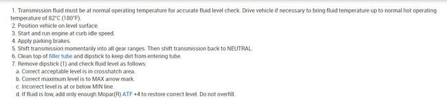

Does it work normally in reverse? What happens when you place it in drive? Have you checked the fluid level and condition? If you haven't, start there. I attached the directions for testing below. Do this and let me know what you find.
If the fluid is clean and full, then we will need to scan the computer for codes. This vehicle has a final drive module which may be causing issues. The module should have codes identifying if there is an issue.

Fluid is very clean and exactly where it should be. Works perfectly in reverse. No issues no sounds. In park it vibrates but in gear doesn't. But still only moves a bit then have to shut off restart and will move a little more. No jolt or anything. It is weird. I'm trying to find my obd2 machine. Just moved and haven't unpacked yet sorry. Will let you know what code it gives. Check engine light is on. Did put in neutral and husband pushed backwards a bit to put in 2H like book said because is was in N. Not sure if we had to do this going forward or if backward would work. If not do I put the 4x4 back in N and push forward? Unsure where final drive module is even located. And can't go to parts store because it barely moves forward.

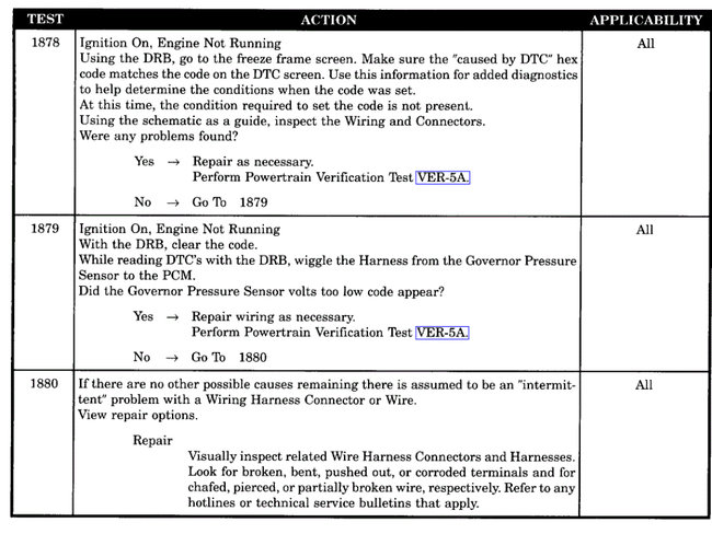

JENNIFER ZACHOW

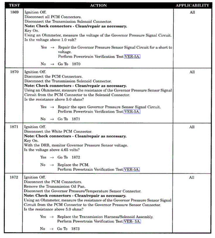

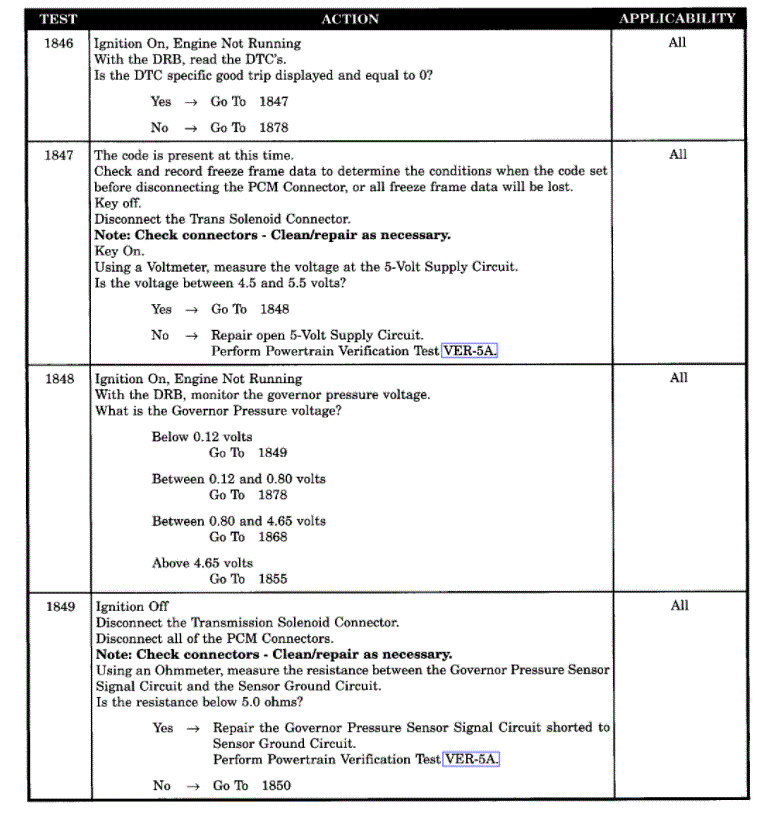

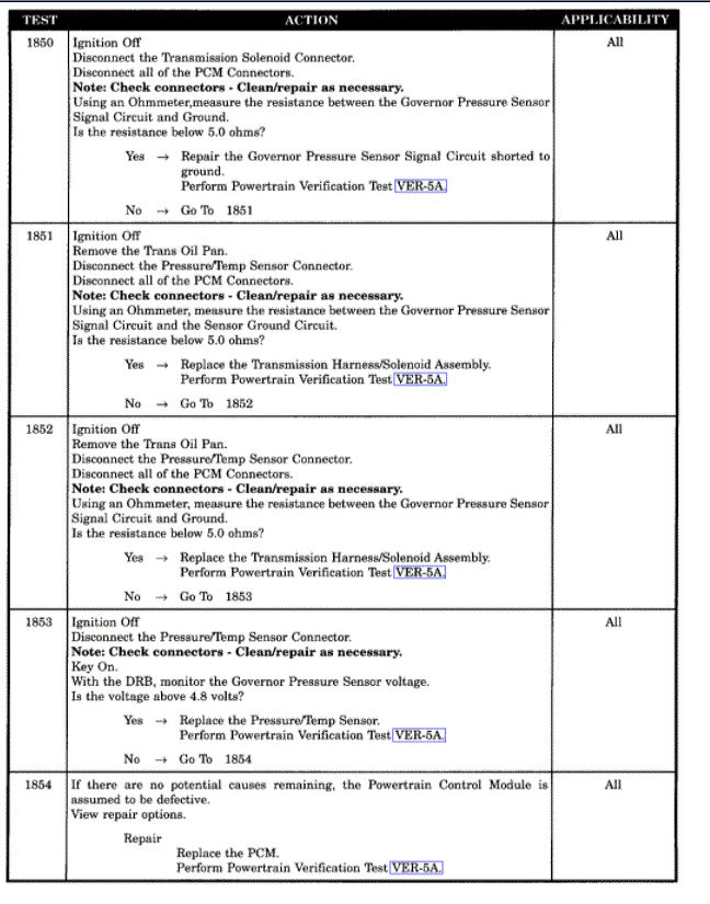

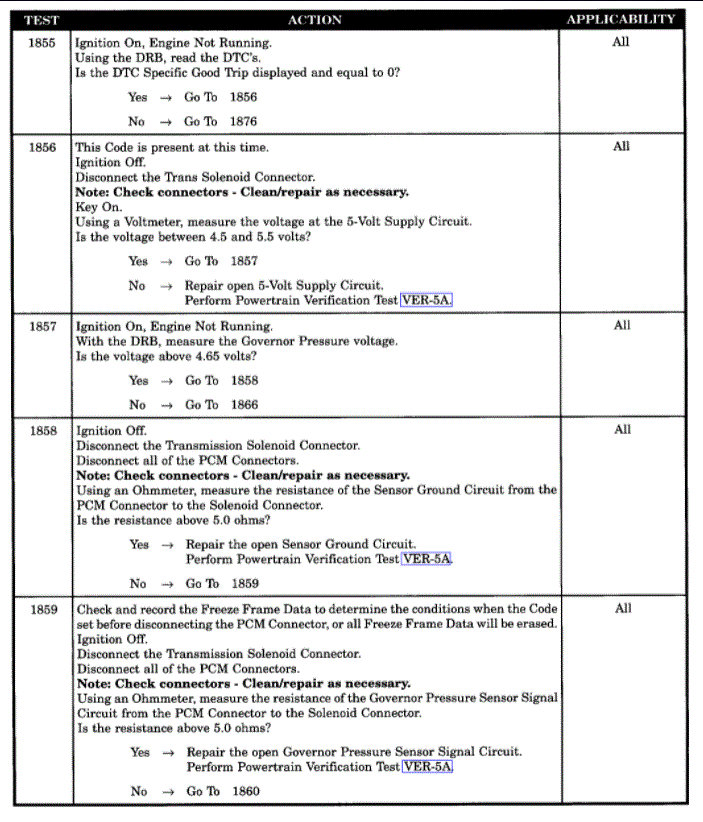

It only pulled one code. P1764 governor position sensor. So I ordered a whole kit but I don't see how this going bad would cause it to make a grinding noise. And how do I know if it went into 2h from neutral? I coasted backward to lock it in. I had it in neutral on the column and my husband pushed it. Could this be the problem also? As for reverse it does reverse just fine except at first it pauses. It's weird.
Jul 18, 2021 at 10:53 PM
  • 110,193 POSTS

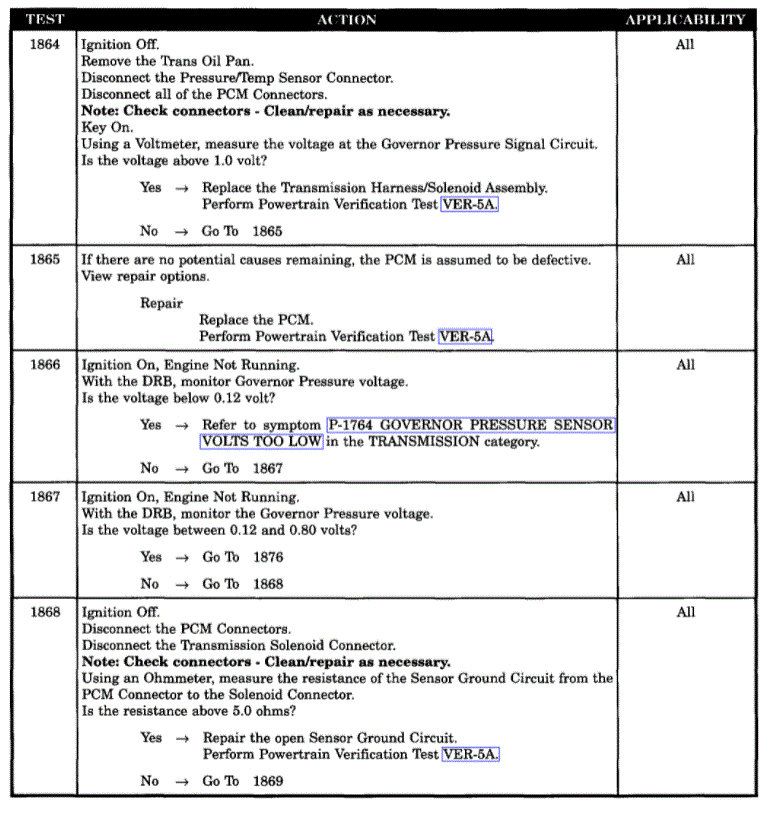

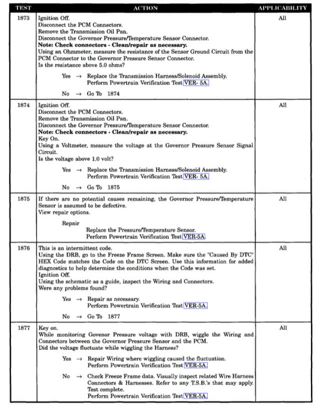

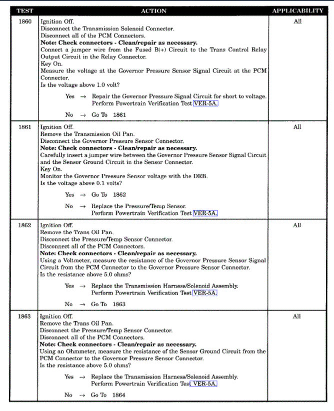

If there is a delay, there is a good chance the governor is related. However, the code you have is likely a wiring issue rather than the sensor. I attached all the diagnostics below related to the code. It is extensive.
Also, if you are questioning if you are in neutral or 2wd, place the transmission in park. If it holds, you are engaged. If it doesn't, the transfer case is likely in neutral.
Let me know if the diagnostics are something you are comfortable doing. That is the way to determine the exact issue.
