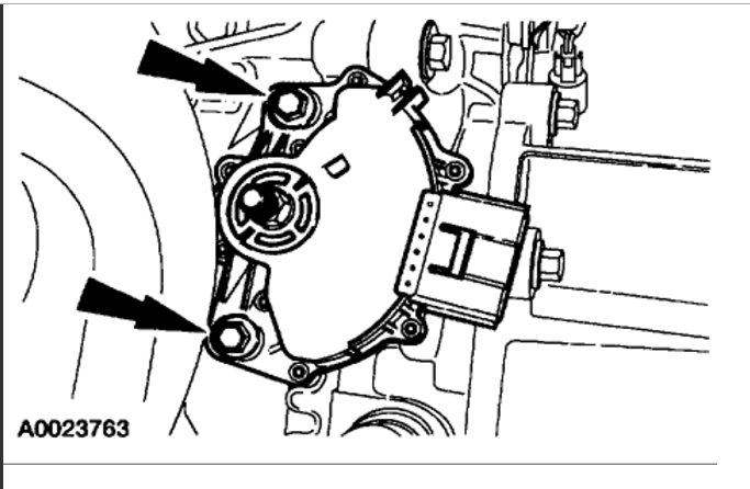

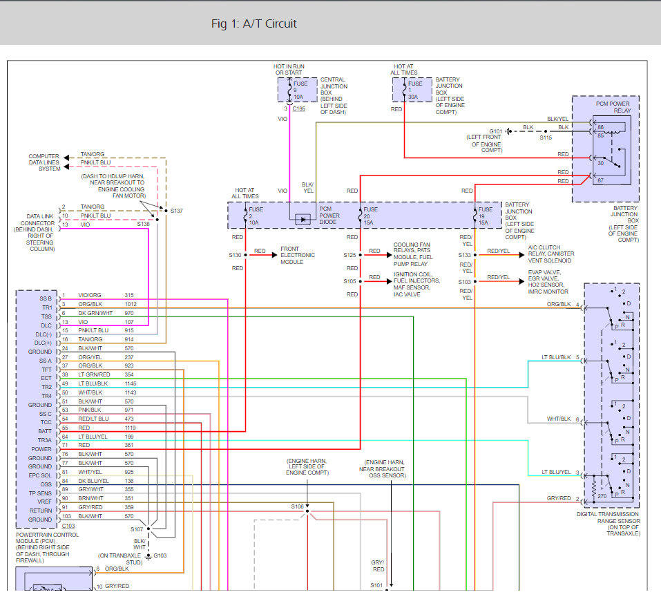

Overdrive light blinking checked codes says p0705 cleaned sensor, plugs, added dielectric grease to connections. Any advice?
Saturday, August 26th, 2017 AT 7:12 PM
KEN L
  • MASTER CERTIFIED MECHANIC
  • 55,476 POSTS

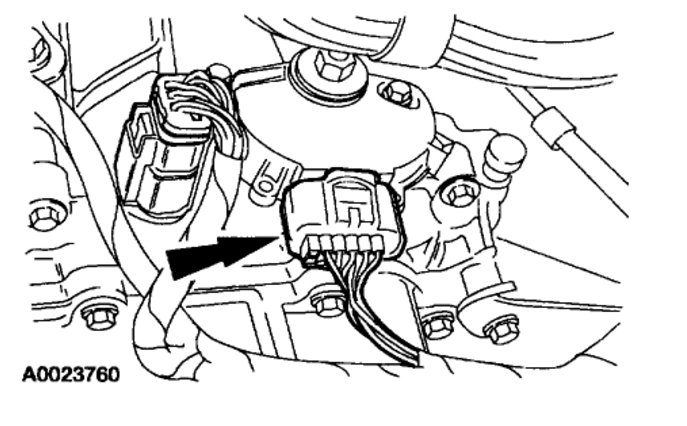

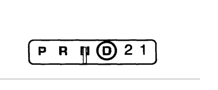

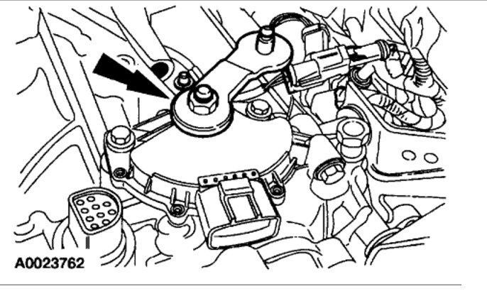

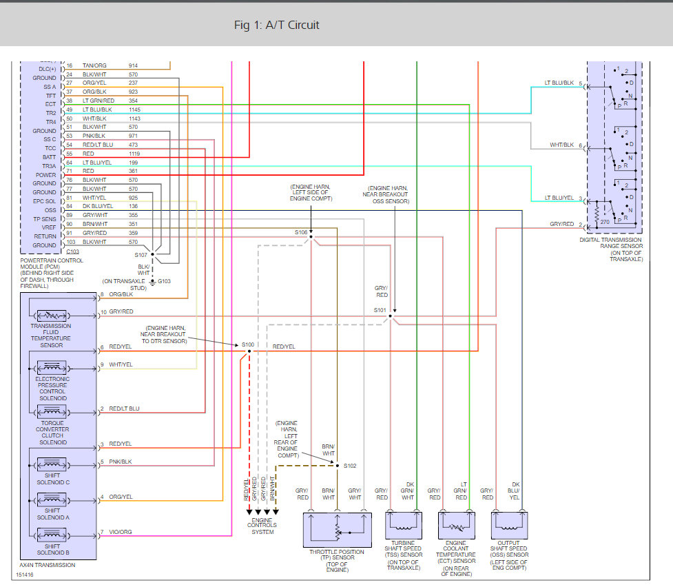

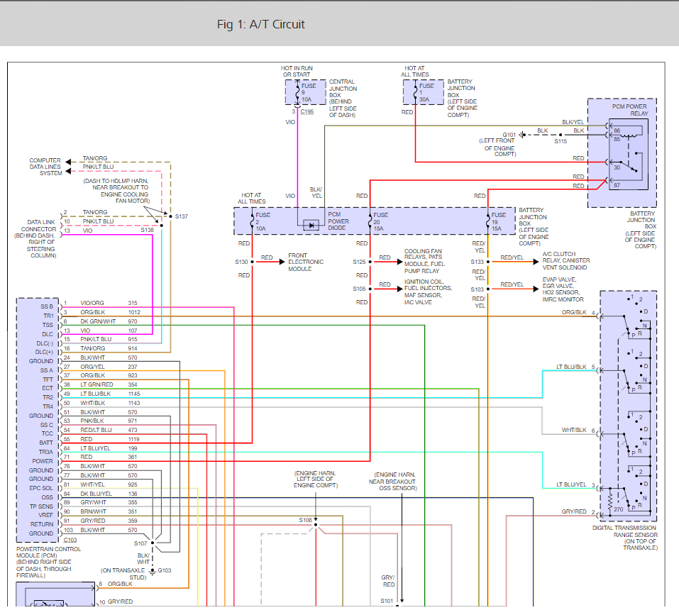

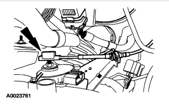

This is a code for the transmission selector switch which sounds like it has gone bad, here is a guide and some diagrams (below) of how to get the problem fixed.
https://www.2carpros.com/articles/how-a-neutral-safety-switch-works
and
Here is the wiring diagram and how to change it, that's what I would do.
Please check it out and get back to me.
