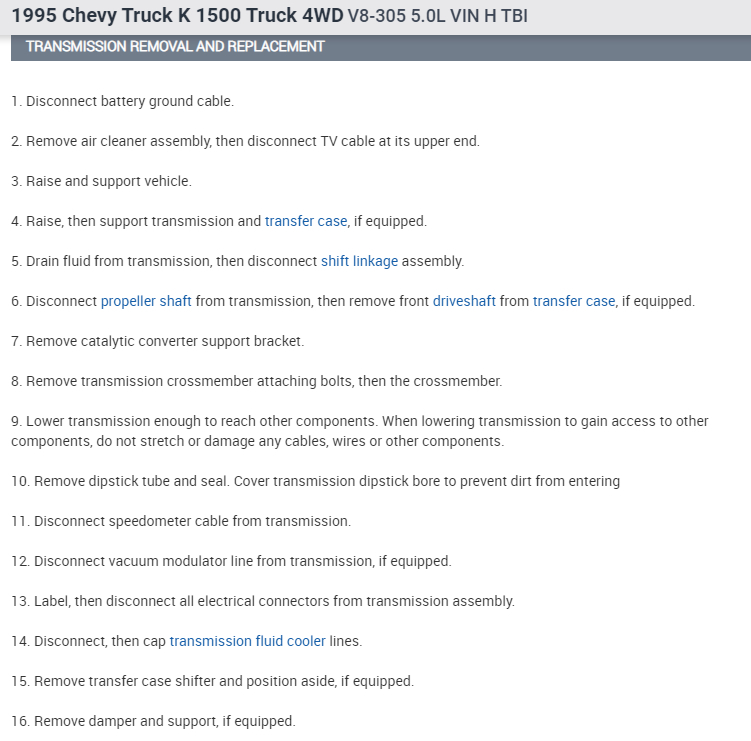

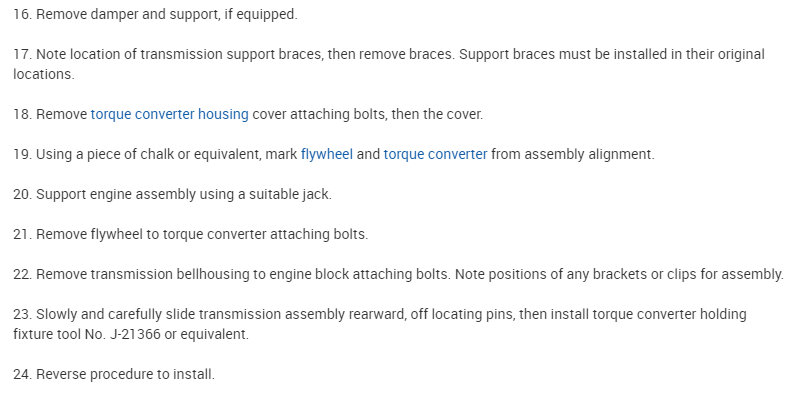

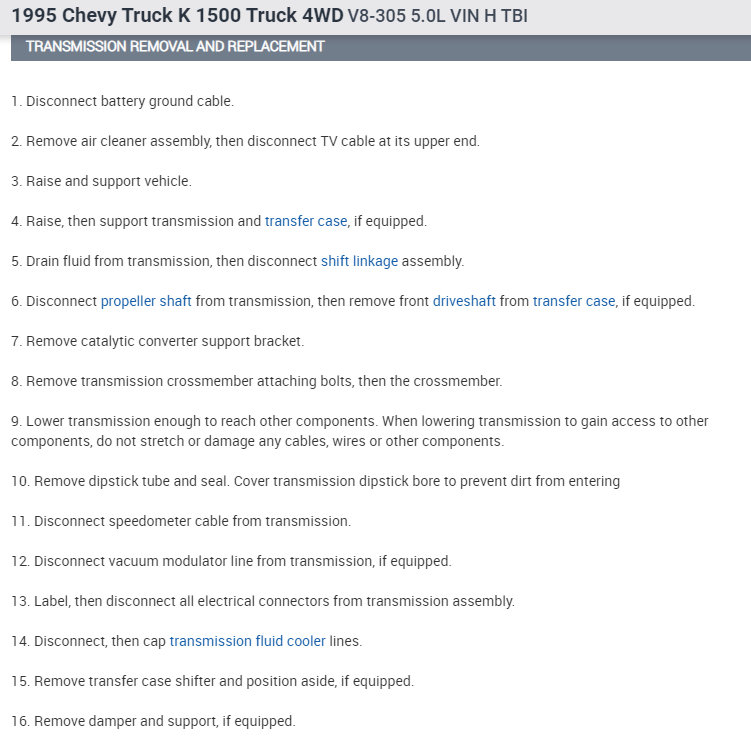

Here is a helpful guide on transmission replacement:
https://www.2carpros.com/articles/how-to-remove-an-automatic-transmission-rwd
Let me know of any questions.
