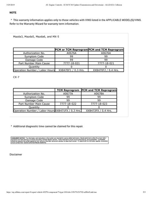

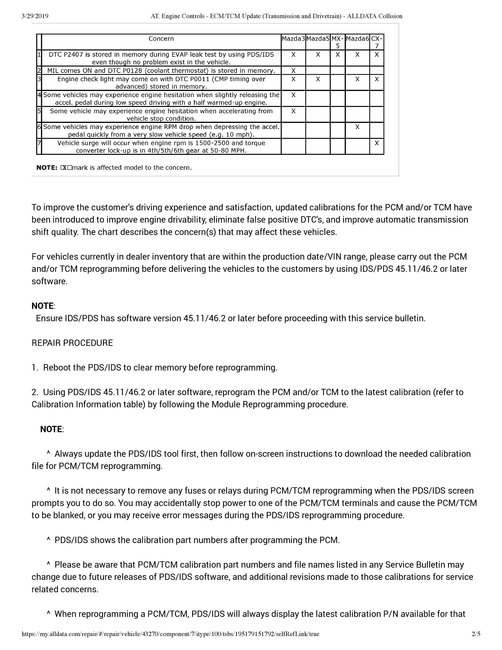

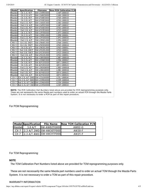

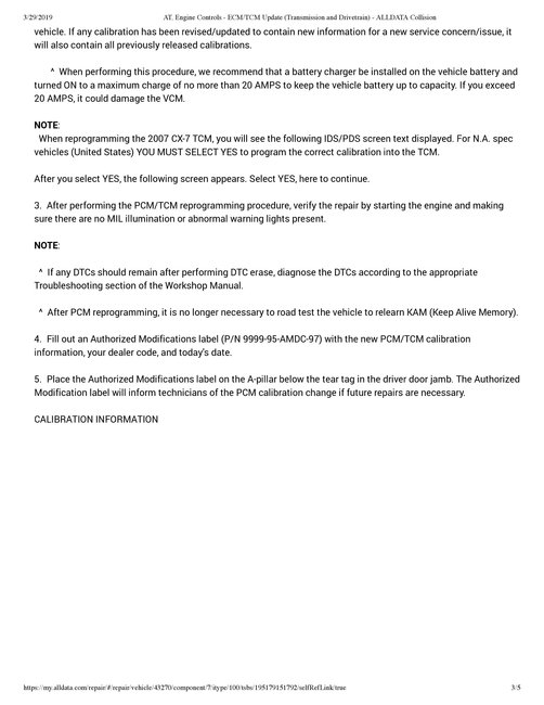

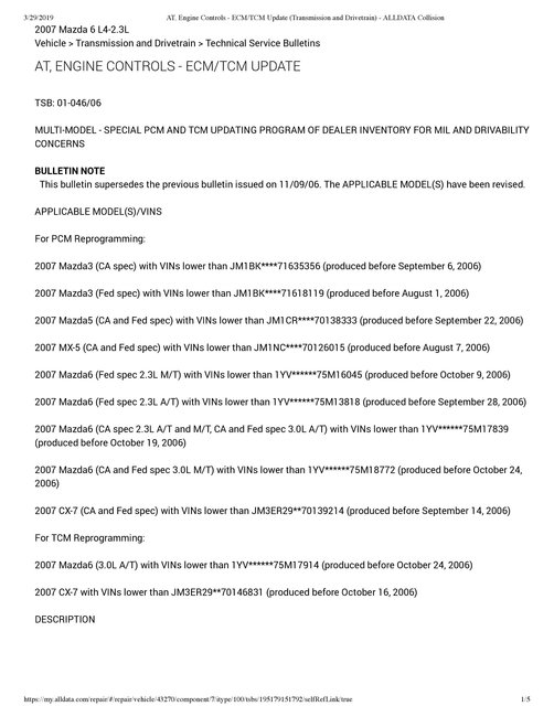

If you don't have any temperature readings that are implausible i have found a TSB regards reprogramming the PCM/TCU.
I have attached the TSB below.
If you get a dealer to carry out the reprogramming you may find that the update may rectify your issue.
