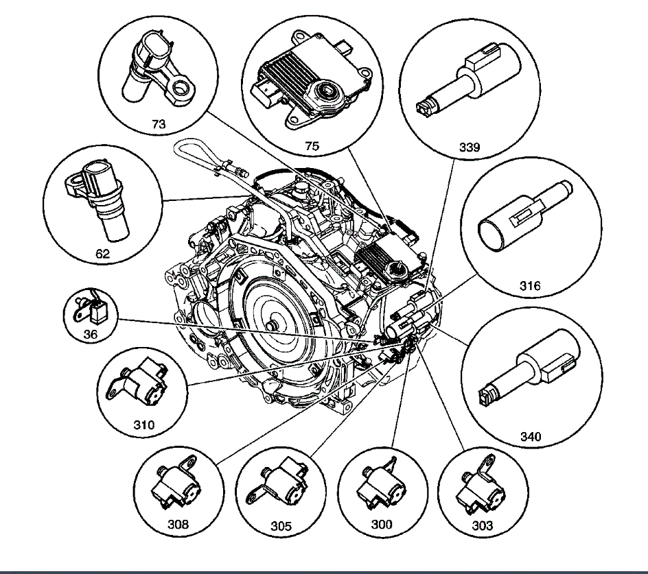

I trying for days to find the location of the transmission range sensor.

The park/neutral switch is at the top of the transmission. (see pic 1) As far as a traditional range sensor, it doesn't have one. All shift information is controlled by the transmission control module (TCM).
