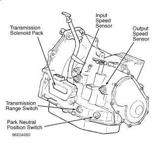

Check and replace solenoid pack on the side of the tranny Does your selector show what gear you are in P R N D when you move it let me know

Suspect tranny solenoids pack
need to have it scanned for codes
or cycle the ignition key on off on off on read P0000 codes in the odometer area

https://www.2carpros.com/forum/automotive_pictures/99387_Graphic9_38.jpg
Do you have check engine light on
scan TCM for codes
most common is speed sensors and or tranny solenoid packs
should have it scanned for codes

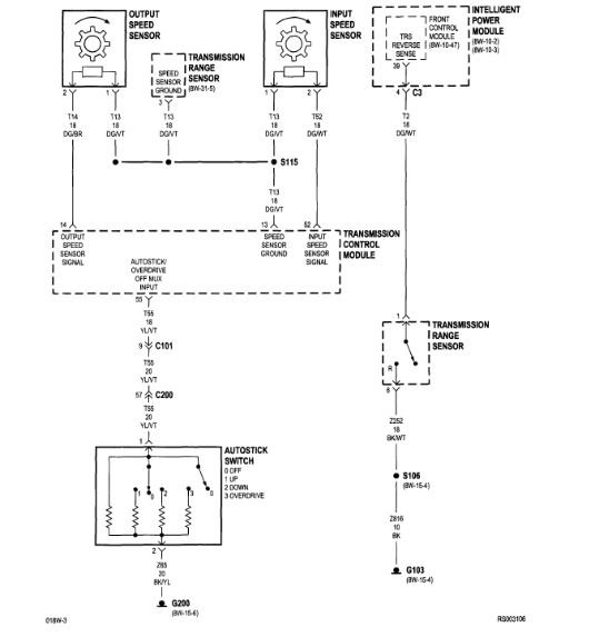

THENNING3129
  • 2001 DODGE CARAVAN
  • 3.3L
  • V6
  • 2WD
  • 200,000 MILES
When driving my van, and slowly accepting, I have to typically let off the gas for it to shift into third and/or fourth gear sometimes, and my rpm's are higher than normal. I checked codes, and I have P1684 code and P0720 code that came up. The P0720 code is the output speed sensor. I have the check engine light on, as well as the brake and ABS light. Is the problem my output/input speed sensors, or is it something else? Transmission fluid level is good and looks good too. Any help, thanks
Thursday, May 20th, 2021 AT 3:59 PM (Merged)
Good afternoon,
I attached a list of issues below for this. From the looks of the code, it is an electrical issue, not a component issue.
Do you have a scan tool that can read the transmission and a voltmeter to do some checks?
P0720 - OUTPUT SPEED SENSOR ERROR
When Monitored and Set Condition:
When Monitored: The transmission gear ratio is monitored continuously while the transmission is in gear.
Set Condition: If there is an excessive change in output RPM in any gear.
Possible Causes:
Intermittent wiring and connectors
Output speed sensor signal circuit open
Speed sensor ground circuit open
Output speed sensor signal circuit short to ground
Output speed sensor signal circuit short to voltage
Speed sensor ground circuit short to voltage
Output speed sensor error
TCM - output speed sensor

My van will not shift out of 2nd Gear, the RPM's get high. Up to 4,000, the Transmission fluid is clear, the error message we got was "Transmission Control System". Any Ideas?
BMRFIXIT
  • 19,053 POSTS
The very common is tranny solenoid mounted on the side of the tranny
2nd is the speed sensors
by scanning the tranny module for codes you can identify the issue
https://www.2carpros.com/forum/automotive_pictures/99387_caravan_tranny_8.jpg
https://www.2carpros.com/forum/automotive_pictures/99387_caravan_tranny_05_1.jpg
good luck
