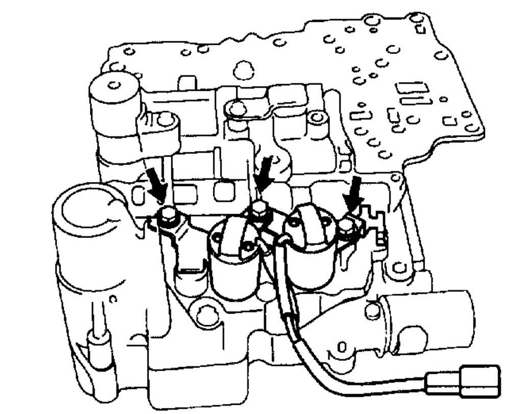

When this happens, do you notice any shifting problems in other gears? When you scanned for codes, did you have a scan tool that can read transmission codes? Did you closely inspect the wiring harness in the transmission for the solenoids for possible internal damage (partially broken under the insulator)?
Let me know. Also, let me know if pic 1 below shows the solenoids you replaced.
See pic below.
+1
Friday, November 26th, 2021 AT 11:12 PM
BLESSING EWOBOR
  • 754 POSTS
The two solenoids I have replaced.
There is no shifting problem with other gears. The scan tool can scan transmission.

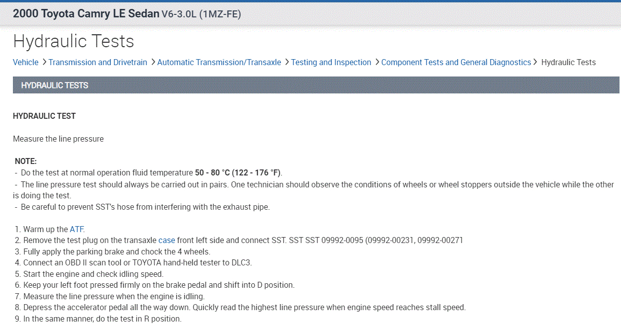

I need help but don't know how to go about it, most of job in the workshop is on the automatic transmission. I don't know where to get hydraulic test, transmission application chat for clutches, the solenoid chat and the road test scheduled for vehicle to shift into gears. They are needed to properly diagnose electronic control automatic transmission. I need to take this guys serious.
+1
Saturday, November 27th, 2021 AT 4:25 AM
  • 110,194 POSTS

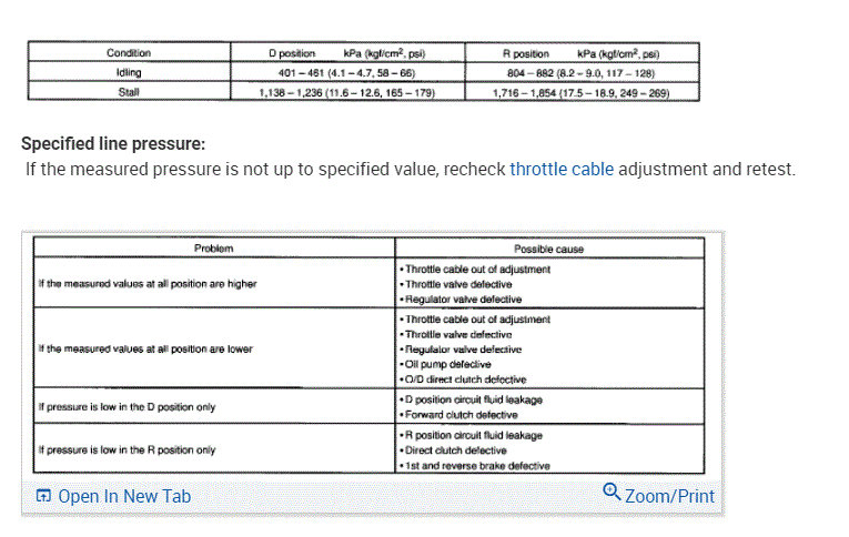

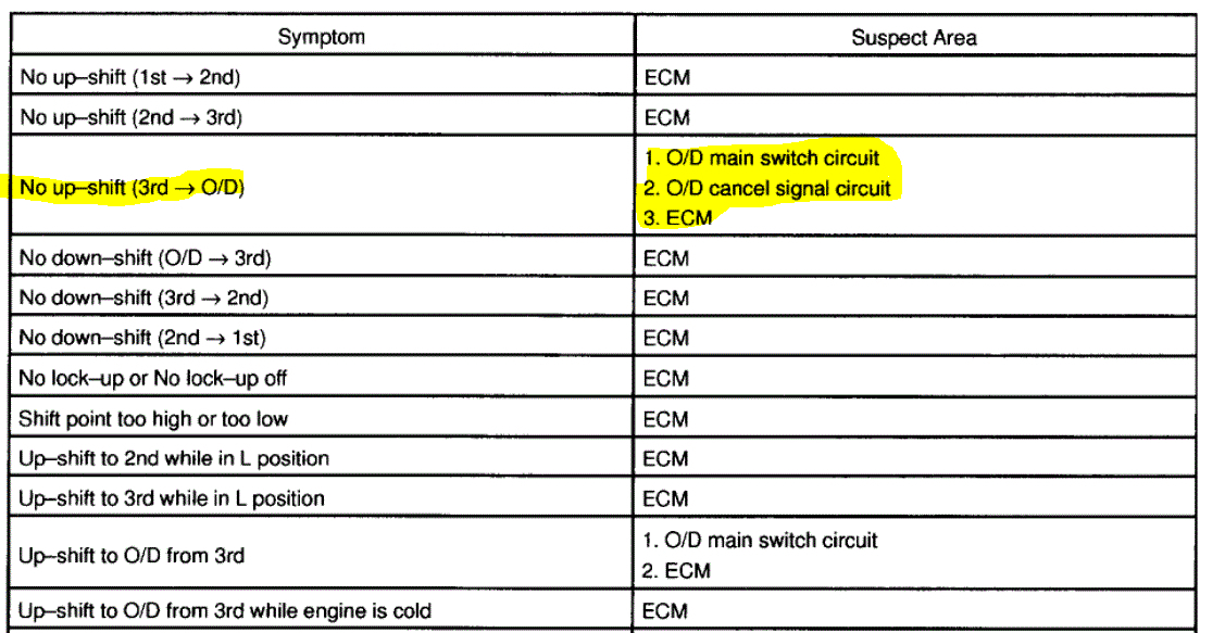

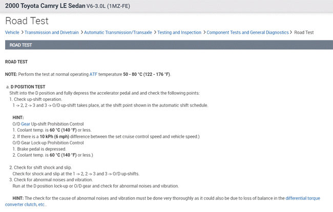

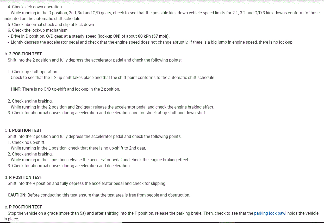

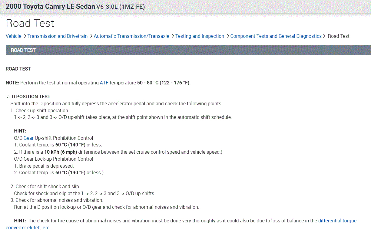

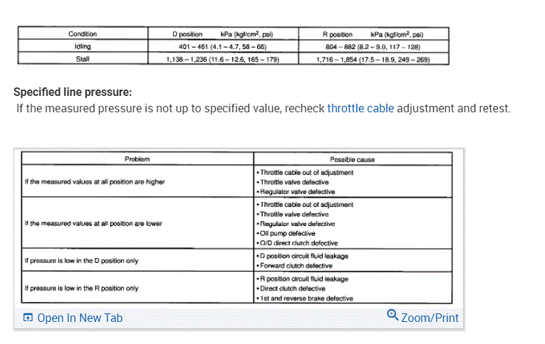

Pics 1 and 2 provide the directions for testing transmission line pressure. The remaining pics discuss how to check during a test drive. It indicates in several places to verify via the automatic shift schedule, but they don't list one. I tried both Alldata and Prodemand and no luck. I checked for a PDF, no luck. Googled searched it and can't find it.
I'm not sure how they expect you to test when the specifications are not provided or available.
I wish I had more. I do want to point out that in pic 5 it indicates a possible cause for a no 3-4 upshift. Also, when you replaced the solenoids, did you check/inspect the shift valve? Was there any evidence of dirt in the valve body?
Let me know. I'm trying, my friend. The needed information must be top secret.

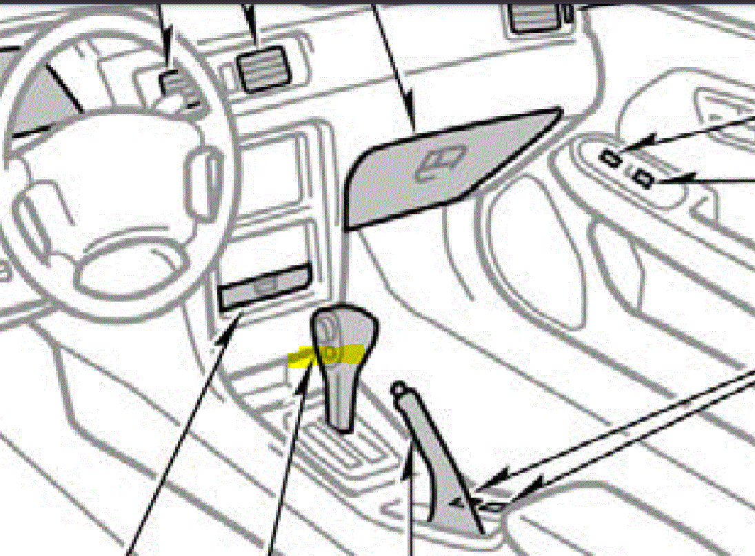

Where is the O/D main switch?
Saturday, November 27th, 2021 AT 11:06 PM
  • 110,194 POSTS
The main switch is usually located below the shift lever release. See pic below.

How can it be tested?
Sunday, November 28th, 2021 AT 4:41 PM
  • 110,194 POSTS
Unplug it and check for continuity when turned on and no continuity when off. The connector should be near the base of the shifter.

Thank you very much, now working perfectly.
