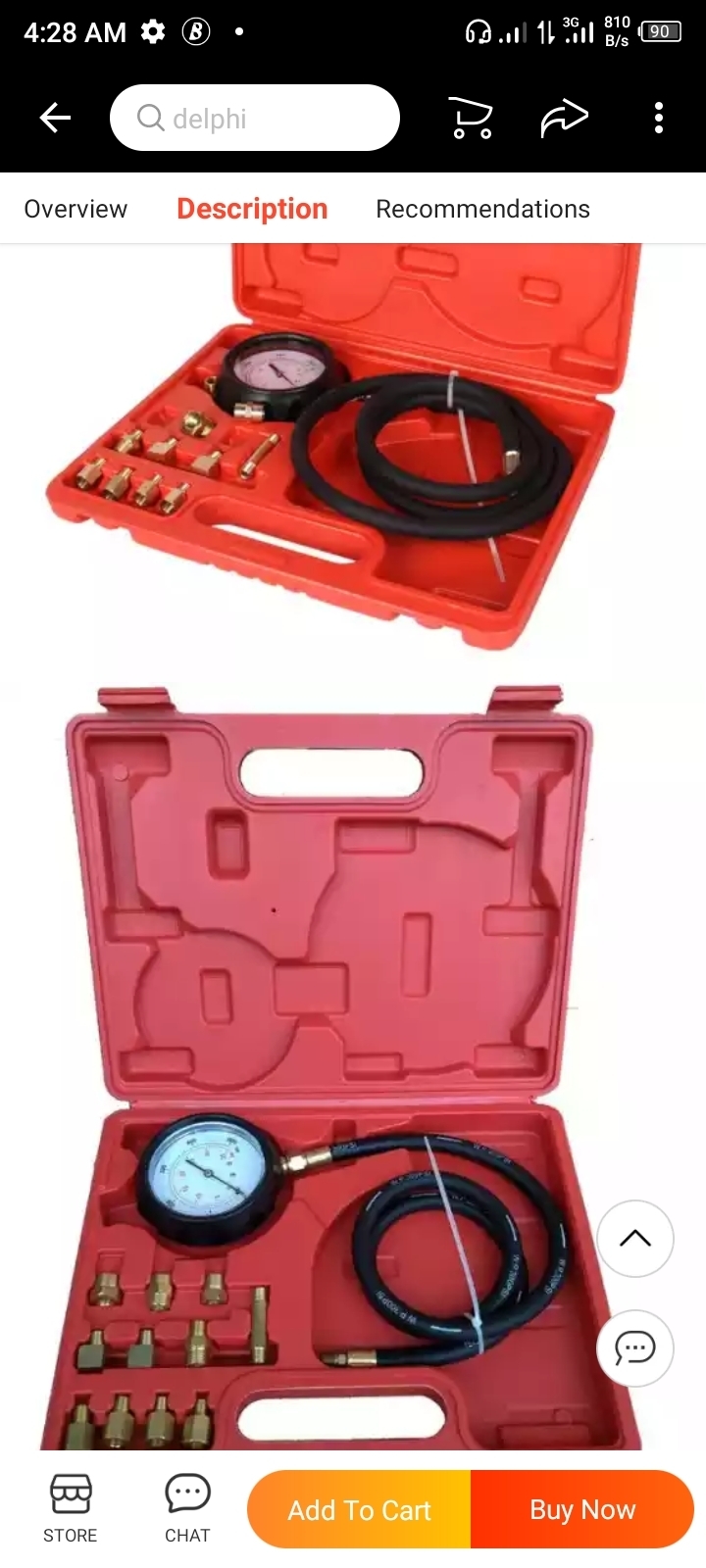

Sir, can't one carry out the hydraulic test without using an intelligent tester and holding the third gear?
Sir, considering the evaluation of the results on the hydraulic test sent. That pressure is low in reverse only, how can someone distinguished between the circuit leak in the valve body and reverse clutch (mechanical).

In most cases when pressure is low, the valve body is removed, and the clutch is checked using compressed air.
How dirty was the fluid? Could there be a blockage in the valve body? Also, I didn't receive your test results. Did you send them?

Could this be used?
Thursday, December 30th, 2021 AT 7:33 PM
  • 110,194 POSTS
That looks correct. Just make sure there is a connector for the vehicle being tested. If you need to purchase it, you will have other uses for it in the future. It's not a bad investment. Just make sure it can read high enough for the line pressure it will test.
