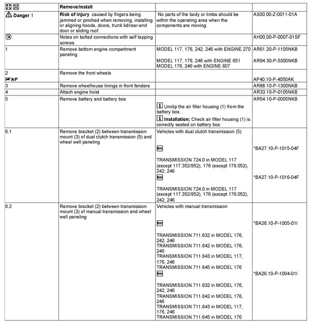

dealer confirmed transmission mount as I suspected. can you give out any instruction on it? being a 4matic not sure or doubt it makes a difference.. they wanted $1,215.00 to replace it, lol.. I said give me my car let me go.. got it ordered from a good site for $53.00.

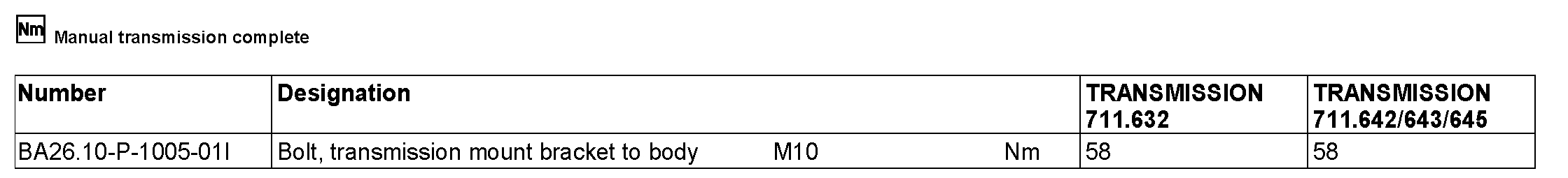

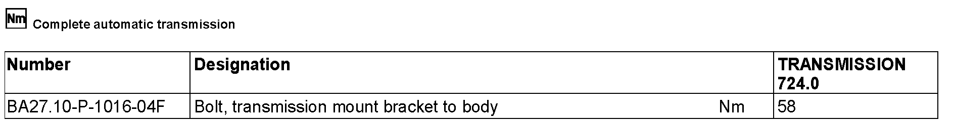

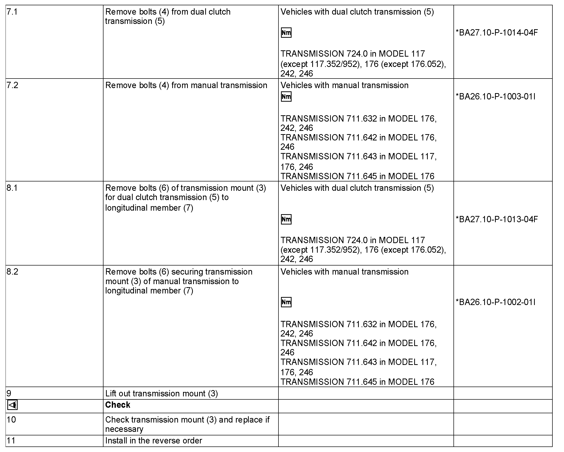

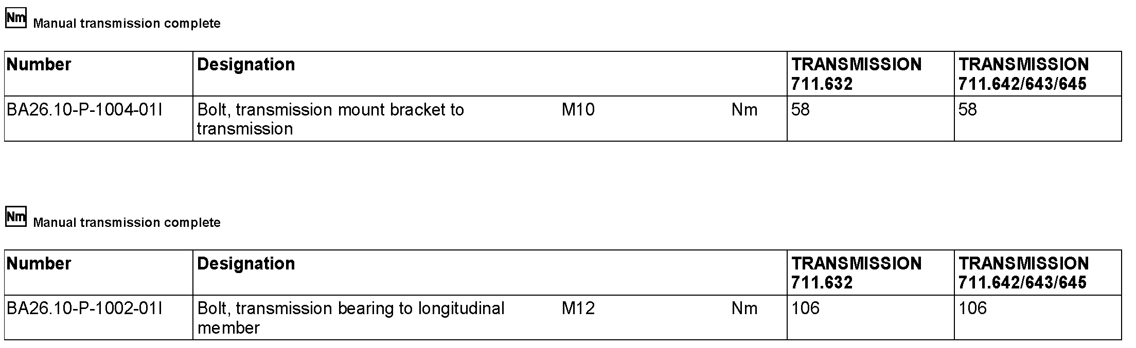

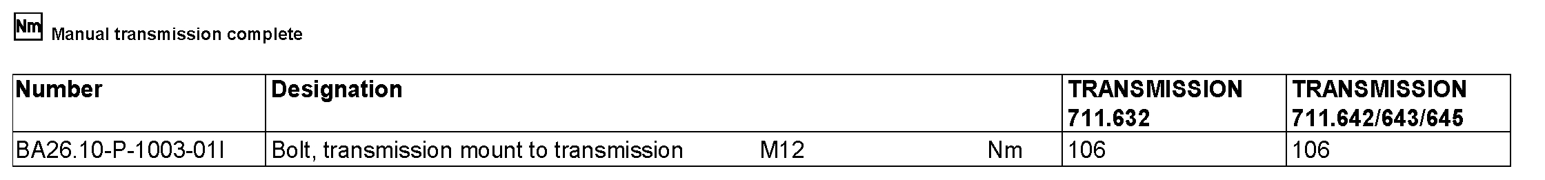

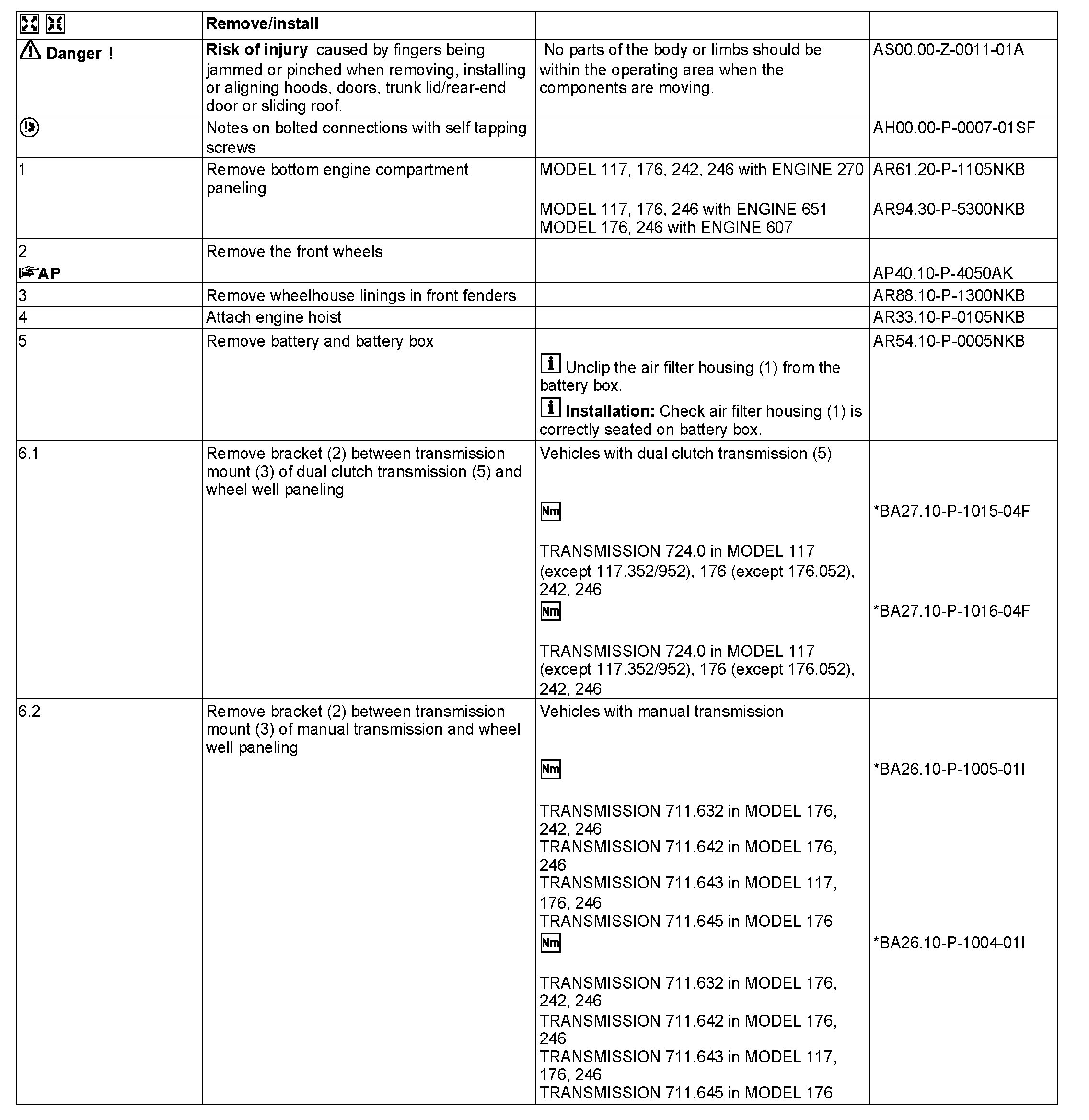

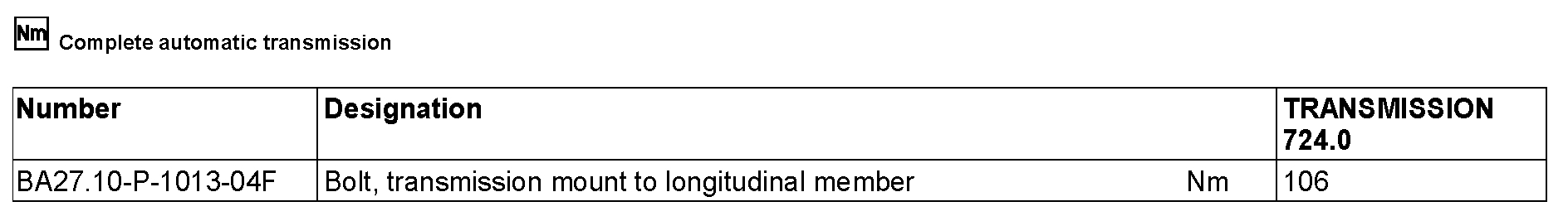

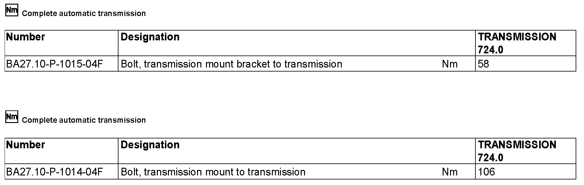

There is only one set of directions for removal. Here they are. Note that the primary directions are included in the attached pics.
_________________________________
2009 Mercedes Benz E 550 4MATIC (211.090) V8-5.5L (273.962)
AR26.10-P-0030NKB Remove/Install Bushing of Transmission Mounting
Vehicle Transmission and Drivetrain Manual Transmission/Transaxle Transmission Mount Service and Repair Removal and Replacement AR26.10-P-0030NKB Remove/Install Bushing of Transmission Mounting
AR26.10-P-0030NKB REMOVE/INSTALL BUSHING OF TRANSMISSION MOUNTING
AR26.10-P-0030NKB Remove/install Bushing Of Transmission Mounting
TRANSMISSION 711.6 in MODEL 117, 176, 242, 246
TRANSMISSION 724.0 in MODEL 117 (except 117.352/952), 176 (except 176.052), 242, 246

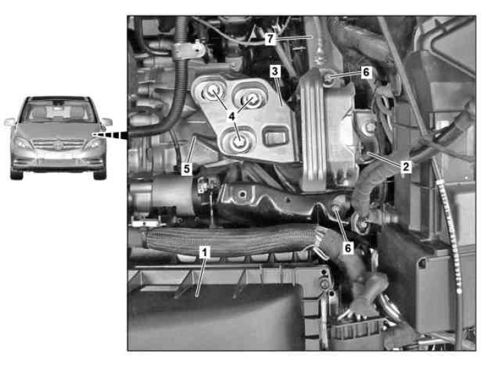

pic 1
Shown on model 246 with engine 270 and dual clutch transmission
1 Air cleaner housing
2 Bracket
3 Transmission mount
4 Screw
5 Dual clutch transmission
6 Screw
7 Longitudinal member

This is everything I have from the manual. I hope it helps. Let me know if you have other questions.
