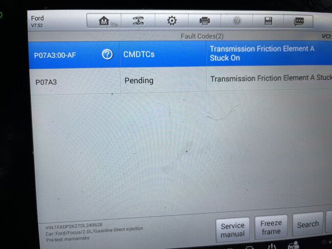

Jerky between 2nd to 3rd ir 4th gear, once u pass 45mph its great. Replaced the actuator under air-box cause that's the code I had, p07a3 now code is still pending. Could that be a fluid issue? I turned the actuator with a screwdriver 14 times and dis coke back quickly. Sprayed cleaner in there still same. I did not do anything with the actuator below.

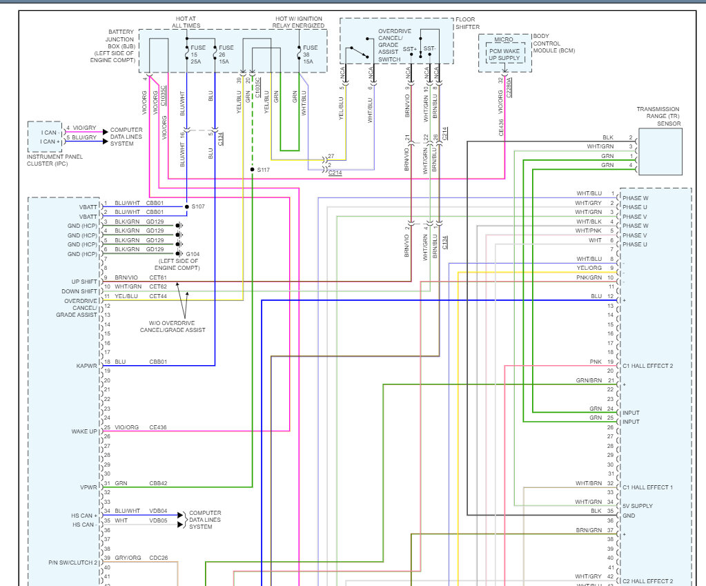

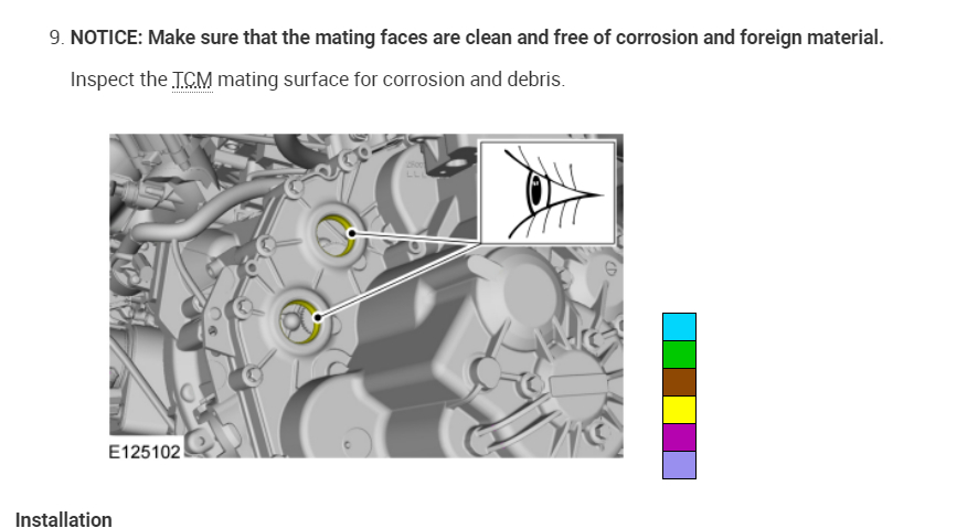

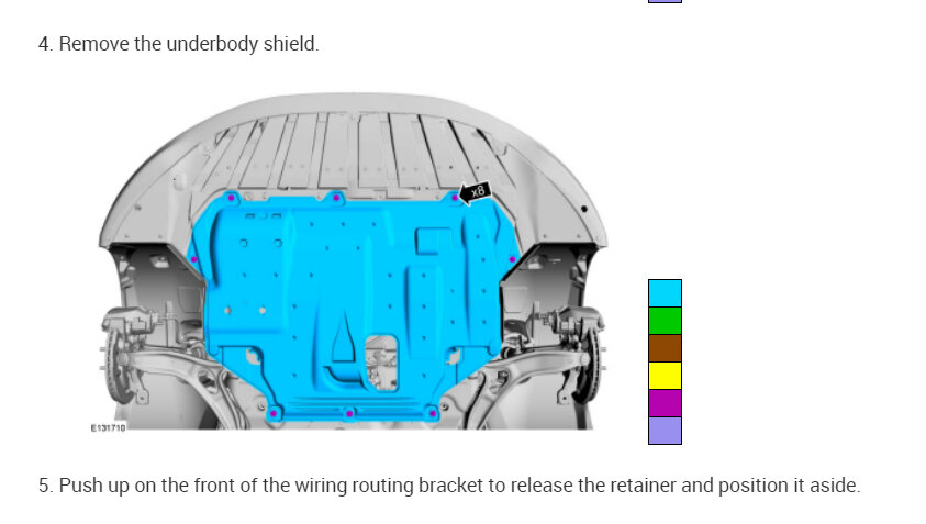

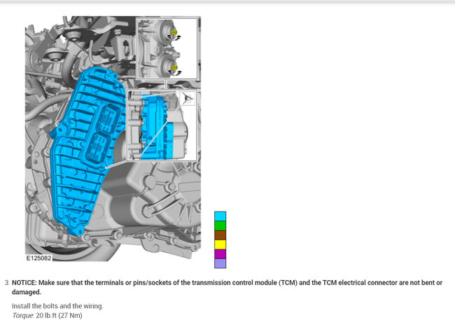

A P07A3 is usually caused by a malfunctioning clutch actuator or faulty clutch actuator fork. The TCM can also cause this.
Check out the images (below). Please let us know what you find.
Friday, August 11th, 2023 AT 4:26 PM

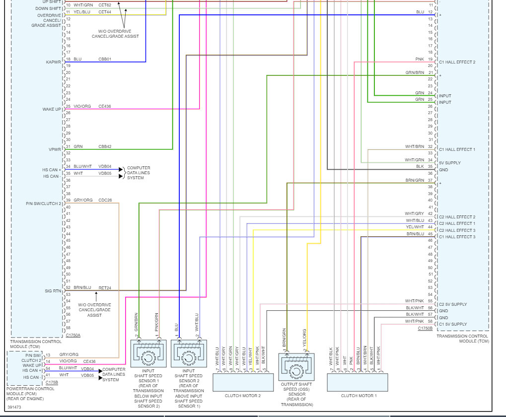

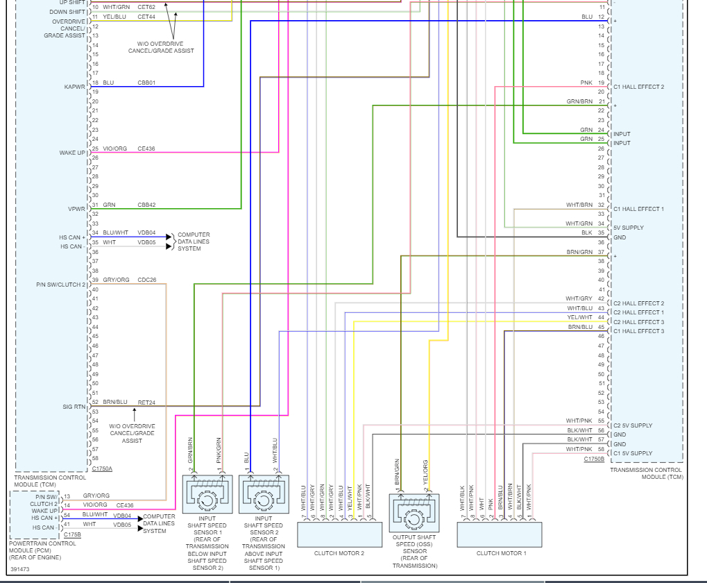

Do you have any pictures of the sensor and where it's located as in the picture?
Friday, August 11th, 2023 AT 4:59 PM

But when I searched for this sensor it says everywhere that it's a code starting with 8, like p0871.
Friday, August 11th, 2023 AT 5:01 PM
BHAMDOC1973
  • 2,018 POSTS
But when looking at my code online it says Friction element A stuck on.

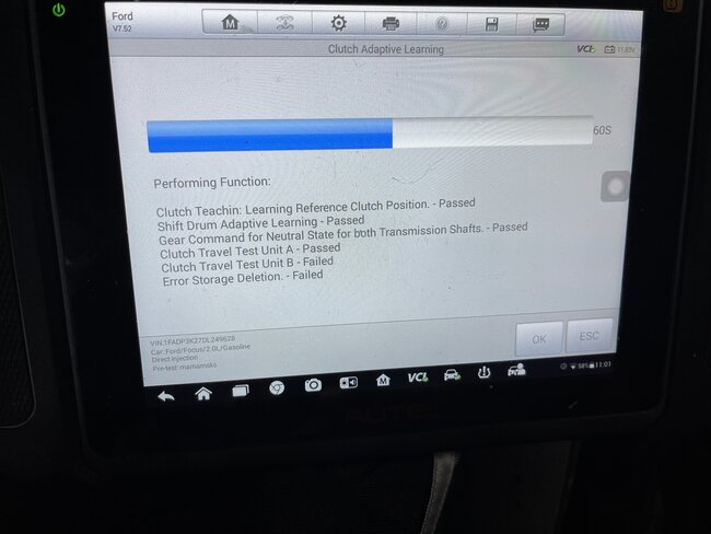

While doing transmission adaptive learning I got this.
Monday, August 14th, 2023 AT 12:02 PM

Changed transmission fluid and the actuator on bottom now it won't go into reverse.
+1

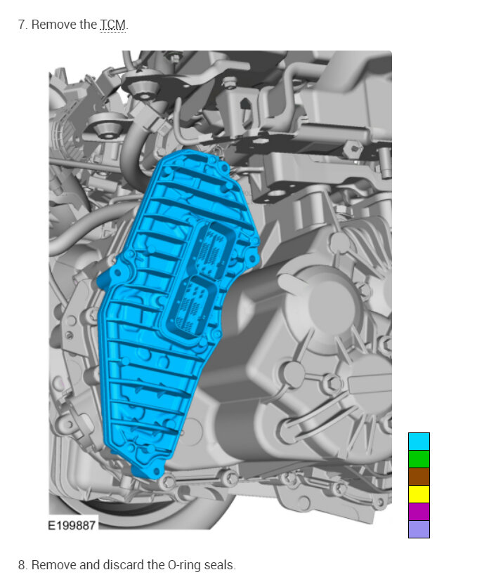

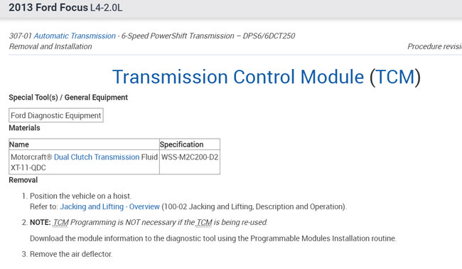

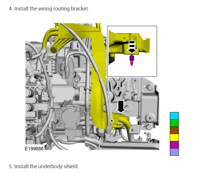

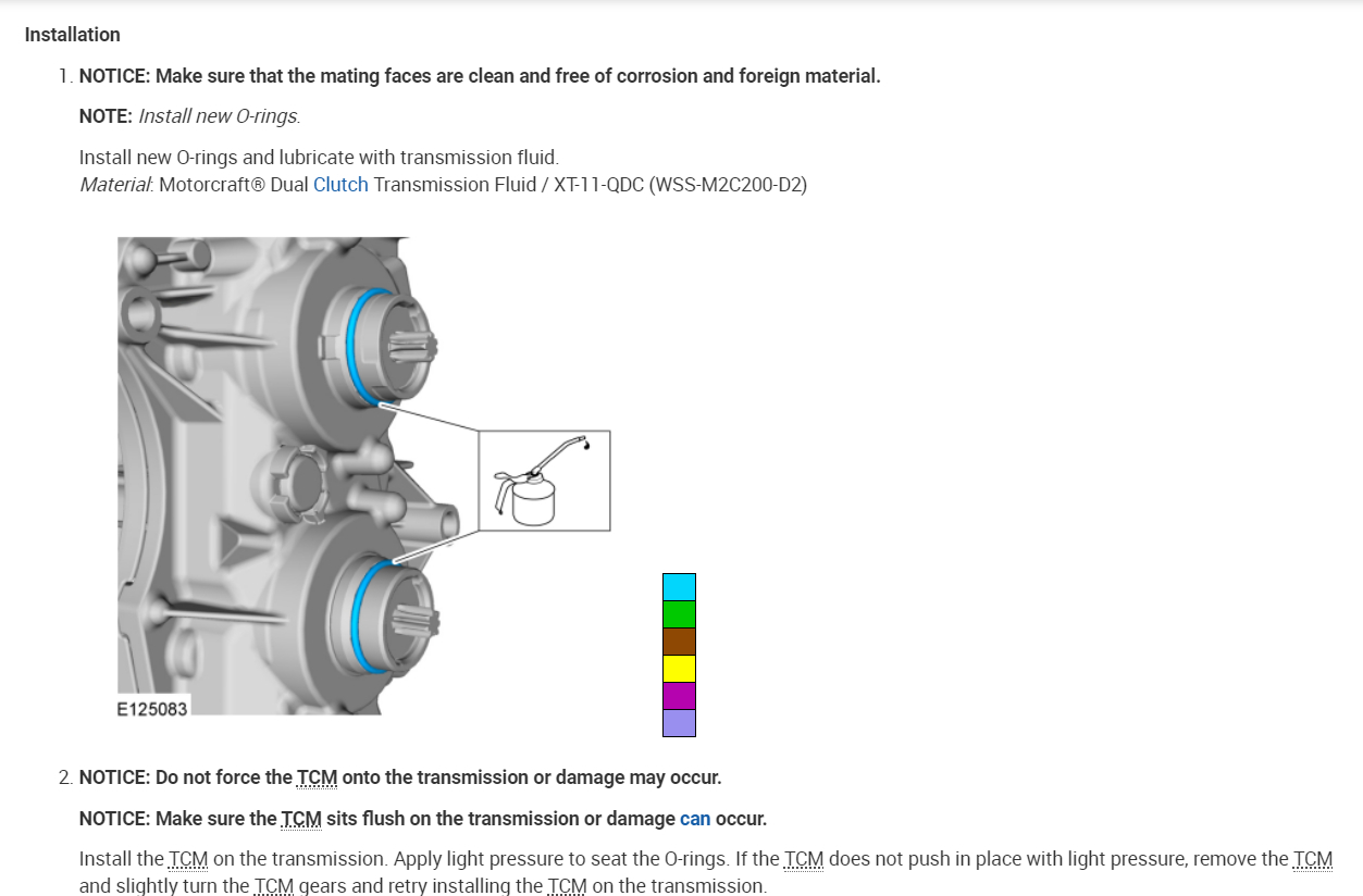

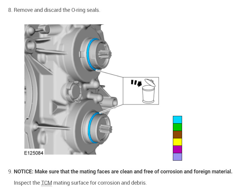

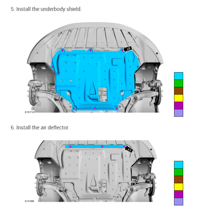

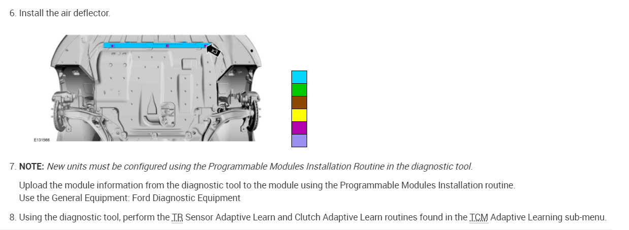

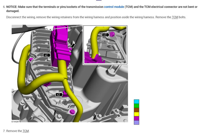

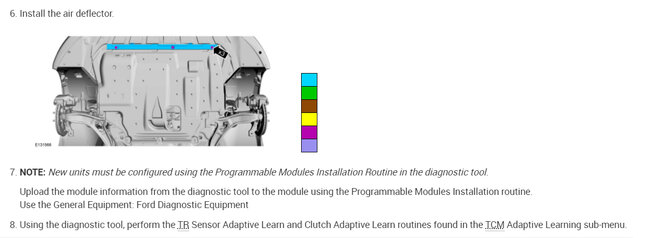

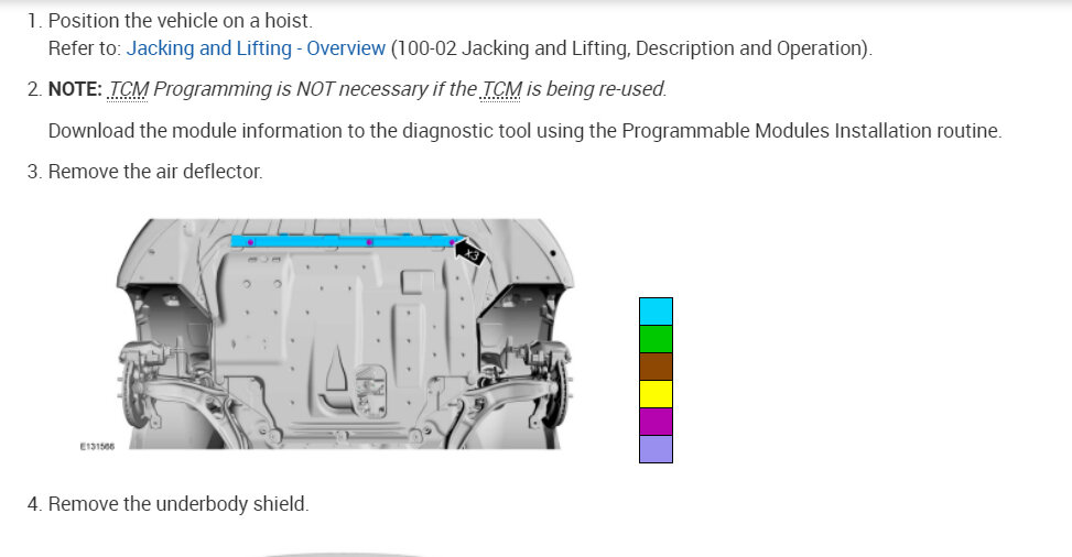

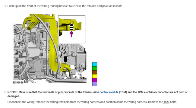

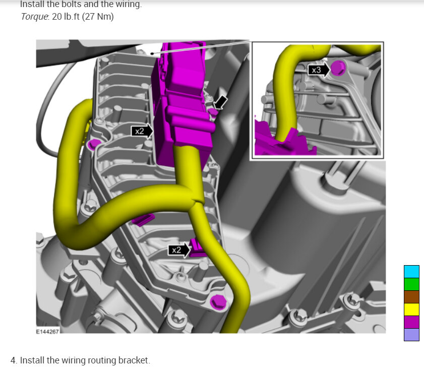

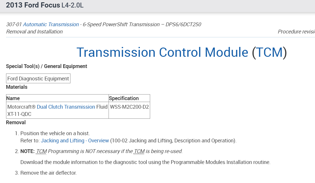

Did you change the actuator on top? Also, I have seen the TCM go out and cause this as well. This is common. Here is how to change out the TCM. Check out the images (below). Please let us know what you find.
Wednesday, August 16th, 2023 AT 10:51 AM

I replaced the top one. Don't know if TCM us bad.
Wednesday, August 16th, 2023 AT 10:56 AM
KEN L
  • MASTER CERTIFIED MECHANIC
  • 55,335 POSTS
It sounds like the TCM is bad.
