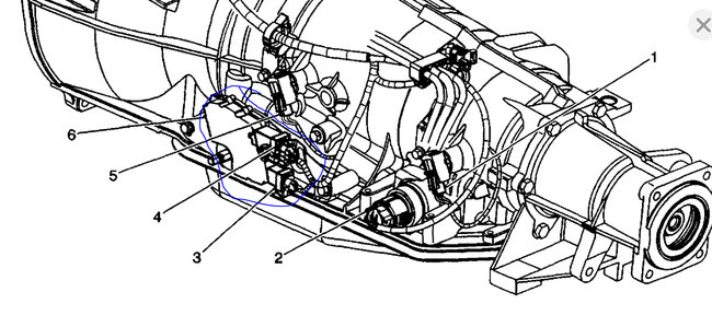

Had transmission trouble a couple of weeks ago with the parking pawl, but after fixing that, the truck will now start if it is in reverse. It starts in park and neutral, like it is supposed to, and the truck runs fine now, shifts easy, and the indicator shows the correct gear, but found out completely by accident that it will start in reverse. Just trying to make sure that there is not something else wrong with the transmission. Any ideas?
May 6, 2021 at 12:16 PM (Merged)
  • CAR REPAIR CONTRIBUTOR
Good morning.
From your description, it sounds like the neutral safety switch is the fault. It should lock out starting in all gears except park and neutral.
It is not the transmission it is a switch issue.

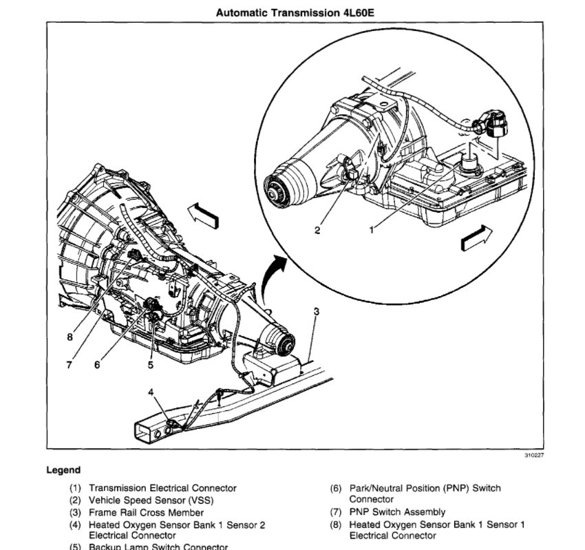

I also attached the location of the transmission range switch or the neutral safety switch for you.
https://www.2carpros.com/articles/how-a-neutral-safety-switch-works
