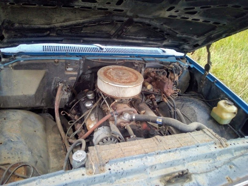

I have a truck with a 454 big block and I'm not sure what kind of transmission is in the truck? I know it is a automatic but I need help finding the model number. That way I can somewhat teach myself alongside the mechanic i'm doing it with, how to take it out to have it rebuild. Then I can put it back in.

Engine.

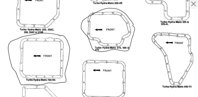

Good morning,
I attached a picture of the pans for the transmission. I circled the 2 possibilities for you to view. They offered both transmissions for this year and engine.
Match up the pan with the picture and the type is below the pan.

It is the second one. It is the 700 r4 transmission.
