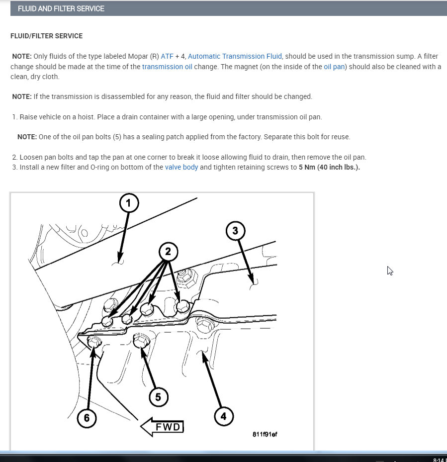

More than likely the pan gasket dried out and cracked while it was sitting and it now leaking. Or it was leaking prior and you just never noticed it. Either way, I would just perform a service on it and replace the gasket while you are doing it to "kill to birds with one stone."
Clearly a leak is only going to get worse so I would go ahead and address it now.

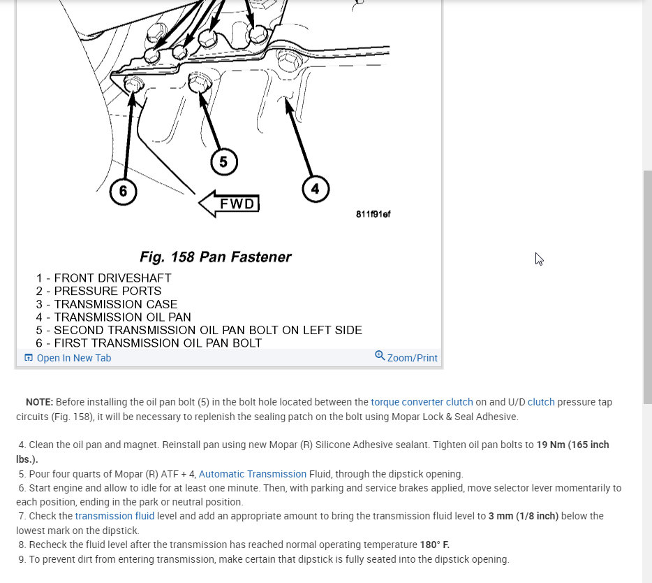

Since you have to take the pan off to do the gasket you should put a new filter and then obviously new fluid. Just doing a transmission service is all I meant.

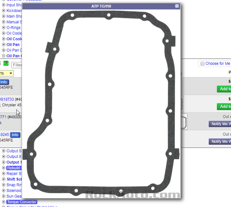

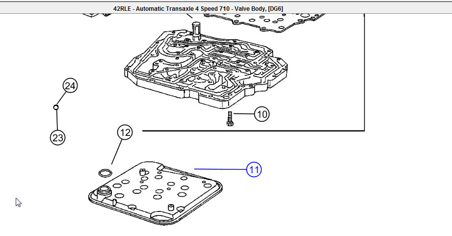

Okay, so one quick thing. I am having a hard time finding a transmission filter. Could you send me a link to one that would fit for my vehicle? 2005 Sport 3.7 L V6
The only ones I am finding are in a kit with a gasket, I already ordered the gasket so I just need a filter but can't seem to find one. Thank you
Nov 7, 2019 at 9:38 AM
The Mopar Part number is 52852913AB. This is for just the filter for a 42RLE.
