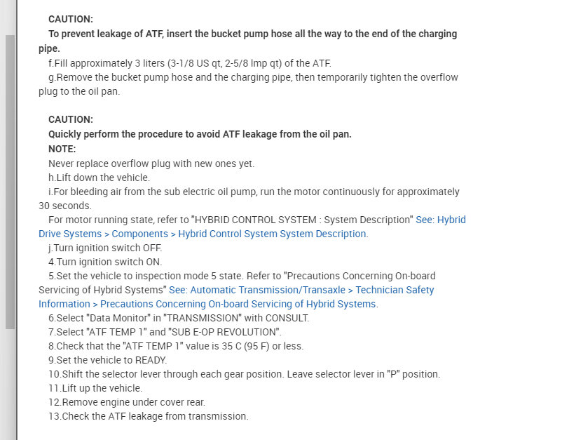

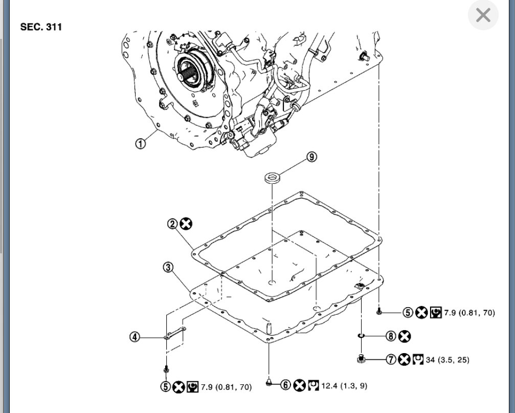

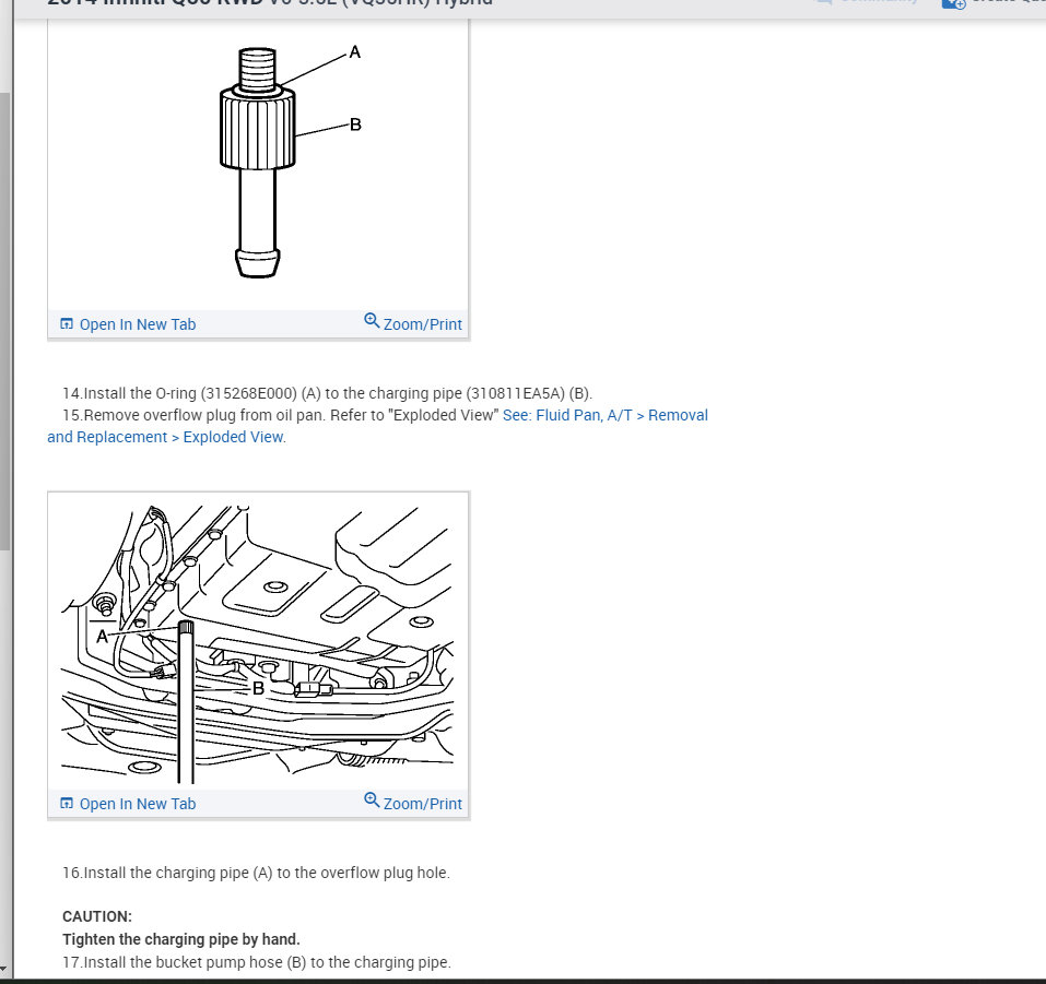

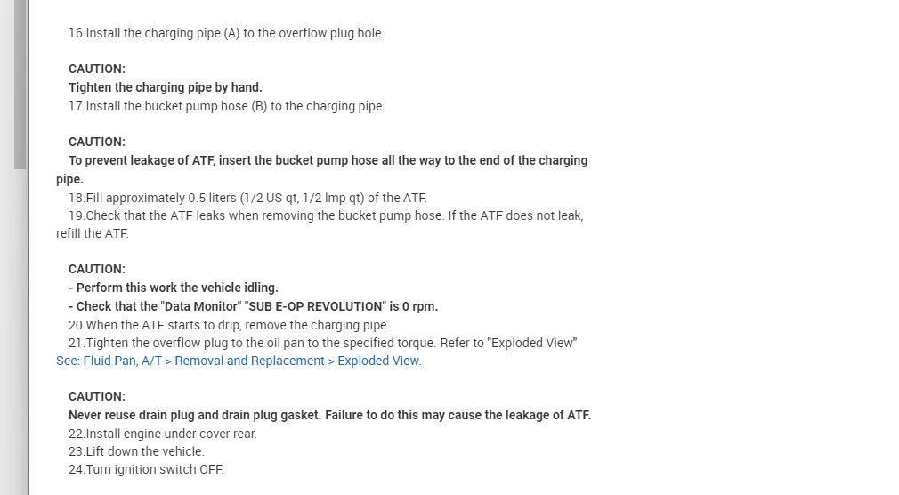

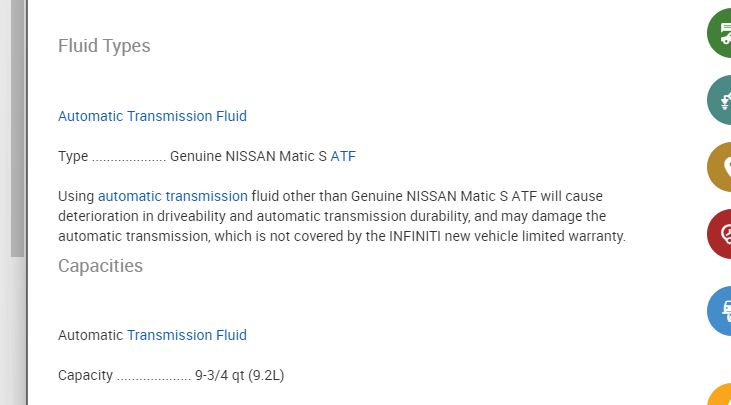

How to, type of fluid, and does it have a dipstick?
Saturday, April 30th, 2022 AT 7:38 PM
MECHANIC
18,907 POSTS

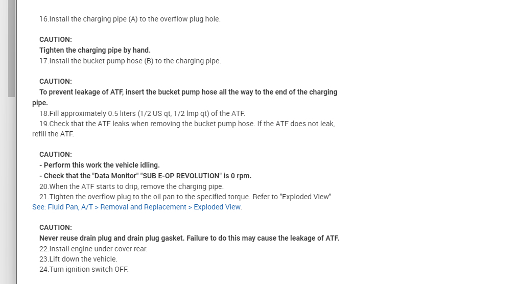

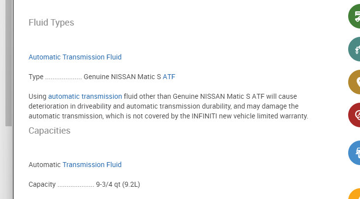

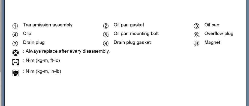

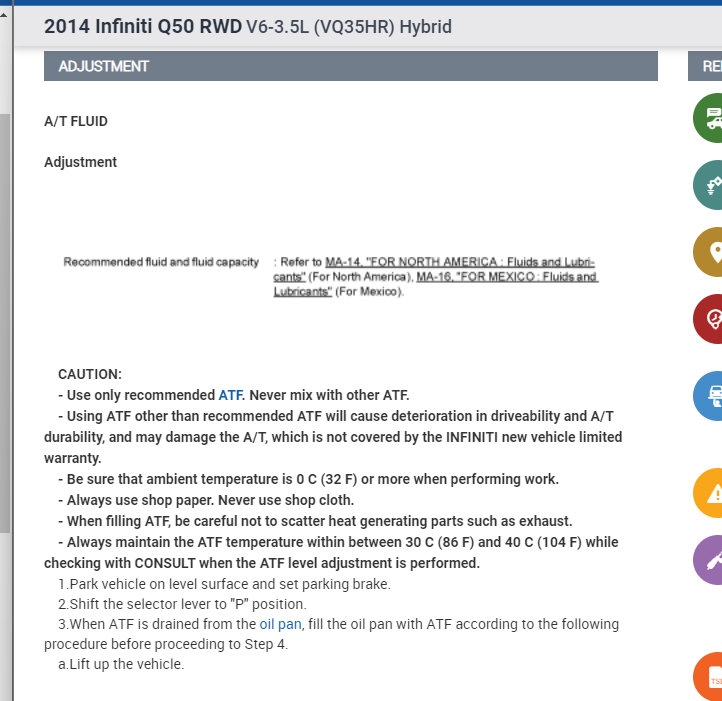

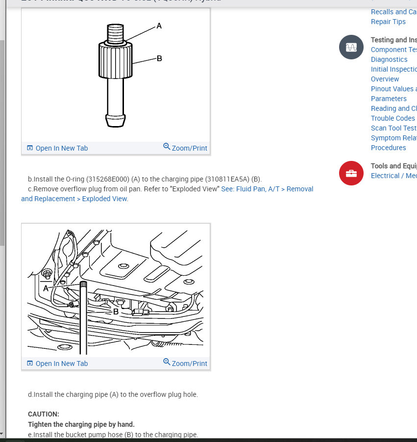

This vehicle does not have a dip stick, so it requires the fill tube that is mentioned in the process that I am attaching below.
Take a look at all this info and the last page is the fluid and amount. Please let us know what else you need on this.
Good to hear from you again.
