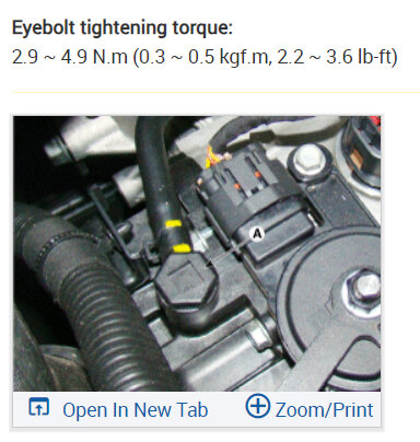

This is the 2.4l one, need to drain and fill, can you send instructions?
Also, the capacity and type of fluid recommend, please.

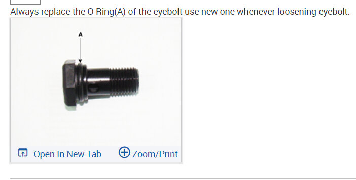

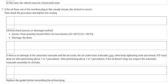

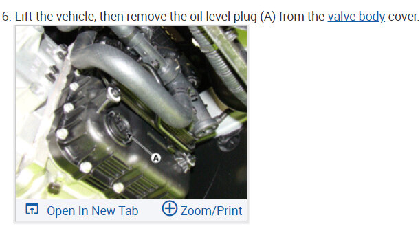

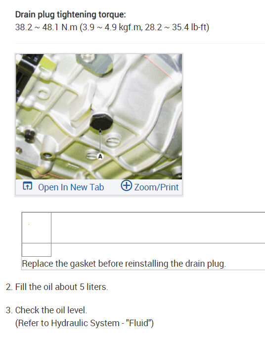

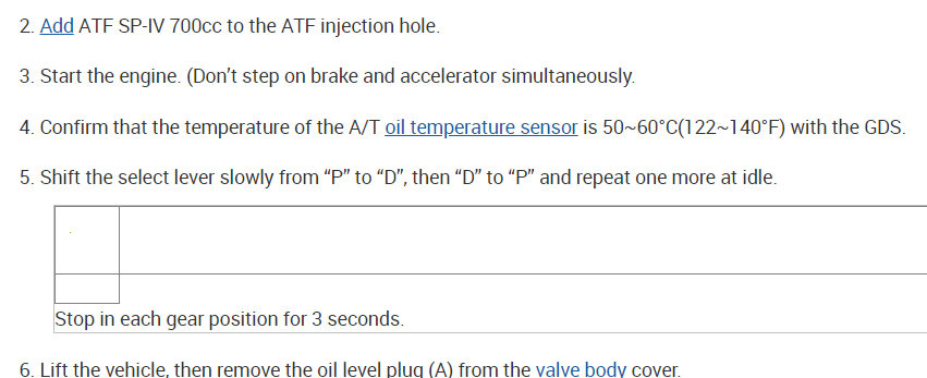

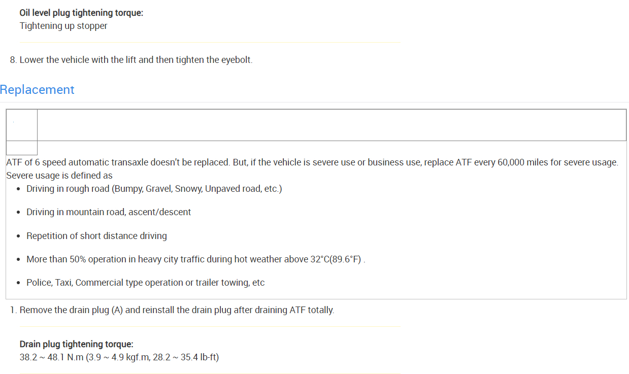

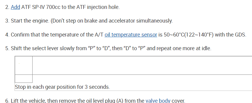

Here is how to change the transmission fluid including type and capacity:
Fluid Types:
Automatic Transaxle Fluid
Type. MICHANG ATF SP-IV, SK ATF SP-IV, NOCA ATF SP-IV, HYUNDAI genuine ATF SP-IV or other brands meeting the specification approved by Hyundai Motor Co.
Capacities
Capacity. 7.50 qt (7.1L)
Check out the images (below). Let us know if you need anything else.
