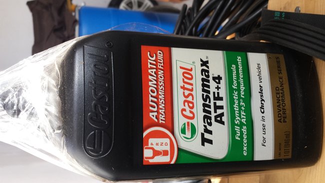

Hello, is this the type of transmission fluid that the car use? If no which type does it use? Thank you.
See image below please.
Jan 26, 2019 at 12:04 PM
  • 110,193 POSTS
I can't be sure because the multi purpose fluids cover only specific vehicles. However, I can tell you the type you should use. I did a little research and found that there are multi purpose fluids can both work on your vehicle. Basically, the M1375 and ATF+4 will work in the same vehicle. However, nothing tells me it's okay to use Chrysler's ATF +4 in place of the Shell. I know that sounds confusing, but I would either get what I listed below or find a multi purpose fluid that specifically indicates it can be used in place of the Shell M1375.4
Fluid Types
Automatic Transmission Fluid .................... Shell M1375.4
Let me know if this helps.
